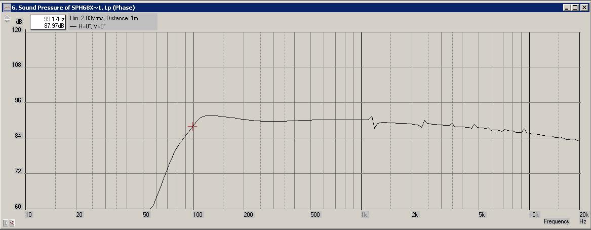

Now on to the passive QB5 crossover:
The passive crossover for a QB5 alignment
With the information above, one modifies the AkAbak script to the correct box volume and port length/area for the chosen QB5 alignment.
In our case this will be 9,7L and a port of 3*3*1,5cm. When modeling the SPL plot, you'll clearly notice the bump around 100Hz.
Next step is to find the impendance at 80Hz *in that box*. Inspect > Network Impendance and clicking on the graph at 80Hz reveals a value of 9
Ohm. This is the R value we must use in the formulae above.
C = 1 / ( 2 * p * Z * d * f ) = 1/ (2 * 3,14159 * 9 Ohm * 1,59 * 80 HZ) = 139 PicoFarad
L = ( Z * d ) / ( 2 * p * f ) = (9 Ohm * 1,59) / (2 * 3,14159 * 80Hz) = 14,31 / 502,65 = 28,5 MilliHenry

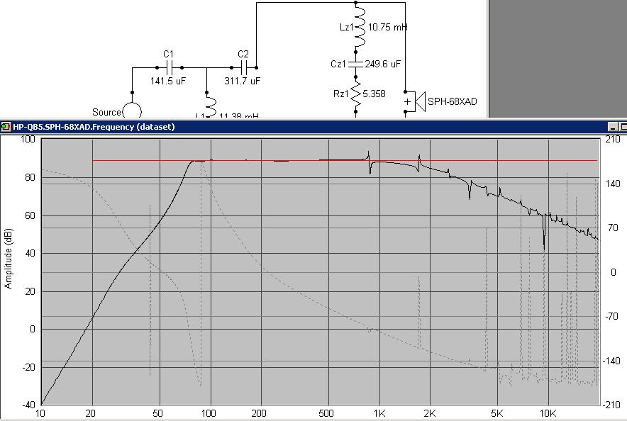

When we put this into an AkAbak script, we see that we don't get the expected flat response (like with an active filter.) This is due to the effect of the impendance on the passive components. (There are some good articles about that, and the Elliot Sound Page also has some about countermeasures.)
So what we need is a personalized crossover, dependant on the impendance- and spl-plot. Enter Speaker Workshop, a free program that accepts .frd (=spl plot) and .zma (=impendance plot) files, and has a brute force/Monte Carlo analysis tool to do the tedious work.
To get these files, one could use the export function of Akabak (and modify the data in a spreadsheet) and a tool to generate the phase data column. (Mentioned in "Crossover Simulation in Speaker Workshop - Tutorial",
Speaker Workshop Tutorial )
Alternatively, use HornResp and export the data. Remove the first lines from the file, and you have the needed .FRD and .ZMA files!
Follow the above mentioned tutorial to import the files, choose a standard/stock 2nd order crossover and optimize the 80-2000Hz for maximum flat response. If you get a bump around a certain freq, insert a "Impendance compensation - resonant peak" into the crossover and re-optimize.
This got me a ruler flat response from 80Hz till up. I put the resulting crossover in AkAbak and it looks good, but there are some differences with Speaker Workshop. Maybe someone can shed a light on this. I think AkAbak is more accurate, but with SW one can get about 95% of the way. (Or assume Speaker Workshop is spot-on, and be done with it!)
Anyway, with this I'll conclude the basic QB5 alignment optimization. The whole SW optimization process will have to be re-done once the diffraction, baffle step and internal resonances have been simultated, so no point in taking this further right now.
I'll just stop for a moment on the reduction in excursion by the electrical filter, and other benefits.
In the original unfiltered box, we see a 6dB bump. Once we filter this away, we see the responce is flat, and the excursion is reduced (at 107 Hz) by 25%. Obviously, we can now put in about 4 times more power before we reach xmax, resulting in our original 6dB increase.
Now how about the 25% excursion reduction?
After digging trough the 3-part "Klips Modulation Distortion" article, we can conclude that the reduction in Modulation distortion is lineair with excursion, resulting in a 25% decrease! This is beyond my wildest imagination. Surely a fullranger has its own issues, but once my whole analysis is done, I am truly confident I'll get the best possible response from it.
Sorry again for the very long wait, but I'll do my best.
Next up: internal reflections!
Here is the AkAbak script with the SpeakerWorkshop' calculated crossover. Included screenshot is from SW and then from AkAbak.

Doing 80Hz with this driver will be very limited and will only work in a very small room if you are stisfied with low levels of volume.
QB5 Alignments are good with drivers having a very high Qts, since these drivers tend not to work in a "normal" ported enclosure, they have very boomy bass. QB5 with a proper C moves everything in place. But again - SPL is still limited, no matter what.
Since your port and the C have a close relationship in how they work together and since the port is always tuned to the same frequency (unless you buy a variable port and change it mechanicaly everytime), chaning C doesnt help a lot without changing the port. The variance of parameters where the values of the tuning and of C "make sense" are in a small range - so the myth of getting whatever response you want by simply changing the Q by changing port an C - has its limits in reality.
A variable C in a passive crossover is exepnsive, intertechnik sells some for speaker development, but doing this with normal capacitors requires buying a lot of them and buliding some kind of matrix switch to change the values...
QB5 Alignements have a high order slope on the lower end and therefore high phase changes. This could get in your way of adding a sub.
The big capacitor for the QB5 Alignemnt does some change to the impedance where baffle-step correction is suited - this has to be taken into account, you are right on this one. Its effect isn´t that great, I´d guess you won´t be needing impedance linearisation here, but to be sure, you´d have to simulate in Akabak to see the results. Of course, bafflestep depends on the size of the enclosure, so you have to think about this one, too.

I get the impression you want the QB5 Alignement to do some magical trick which gets a lot more out of the speaker then another alignment - this isn't the case.
To calculate a QB5 Alignement, I have a formula somewhere in the drawer which is pretty simple to handle. I could look it up. But it´s designed for very high Qts (0,43 isn´t that high, I am talking about 0,7 and much higher). You will be needing a lot more volume, too than in a normal reflex enclosure.

I already did some comparisons on small commercial sattelites. Some of them claim to go as low as 40Hz, but the sensitivity is then in the low 80's. I feel they swap efficiency for bass extention. Quite the opposite of what I try to do.
Sabbelbacke, Making everything (port and C) variable and adjustable to suit is a very practical approach, which I cannot do, but I guess you have already done that in the past. Cool that you have this facilities.

SPL-wise I have a simple decibelmeter - my only measuring equipment - and I remembered some volume settings during normal radio listening and some "spirited" action movie scenes. I took my meter at hand and it seems ... 70dB A-weighted and 90dB C-weighted during peak moments are about the loudest I went (so far ;-) Verry reassuring I think.
