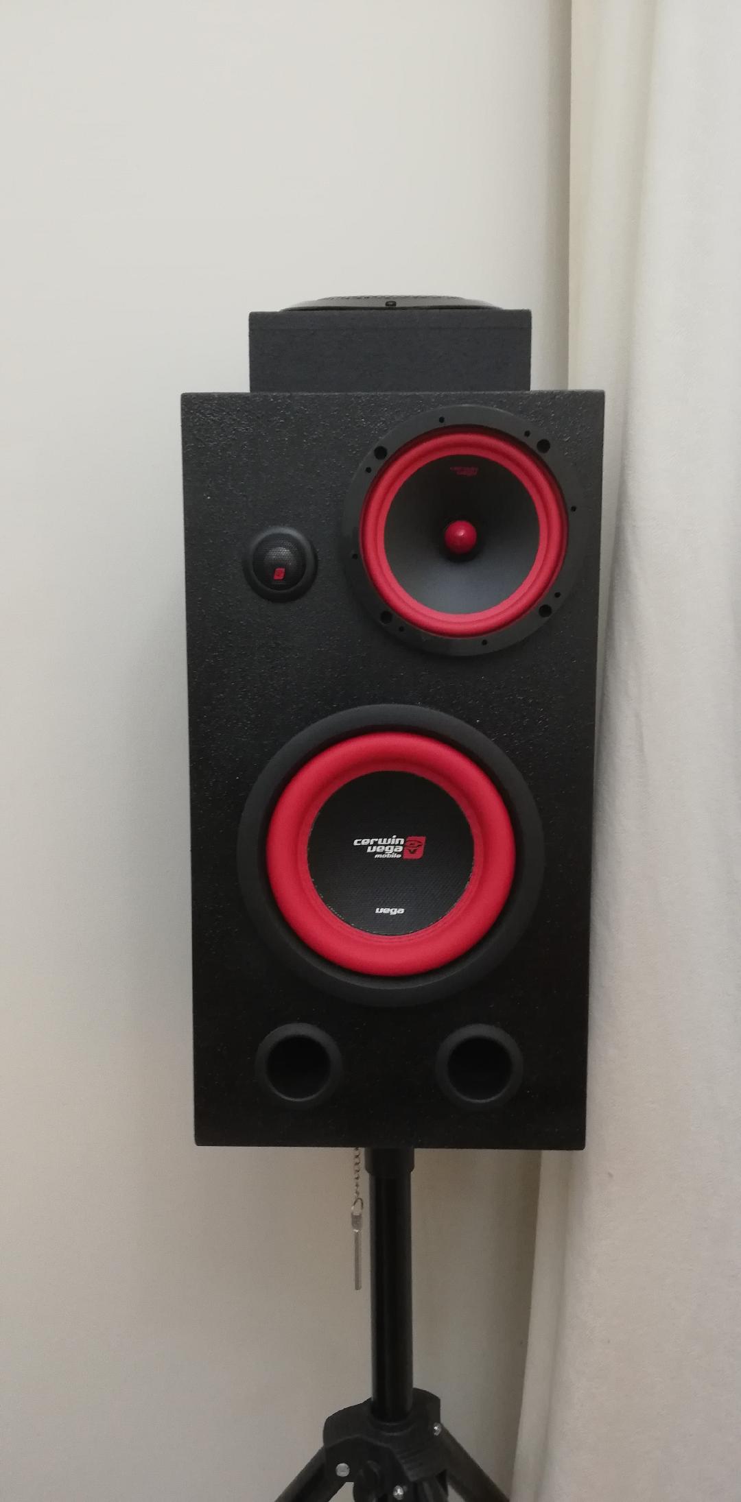

I am a big fan of Cerwin Vega to the extent that I decided to sell my Klipsch and build my own home theatre 3 way front speakers! 🙂

The speakers sound good & 'alive', better than the Klipsch. Although I feel with a better crossover they can really sound brilliant. I went through three different crossover configurations:

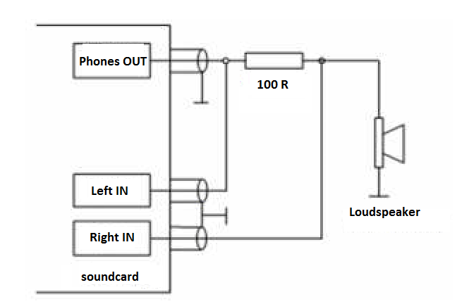

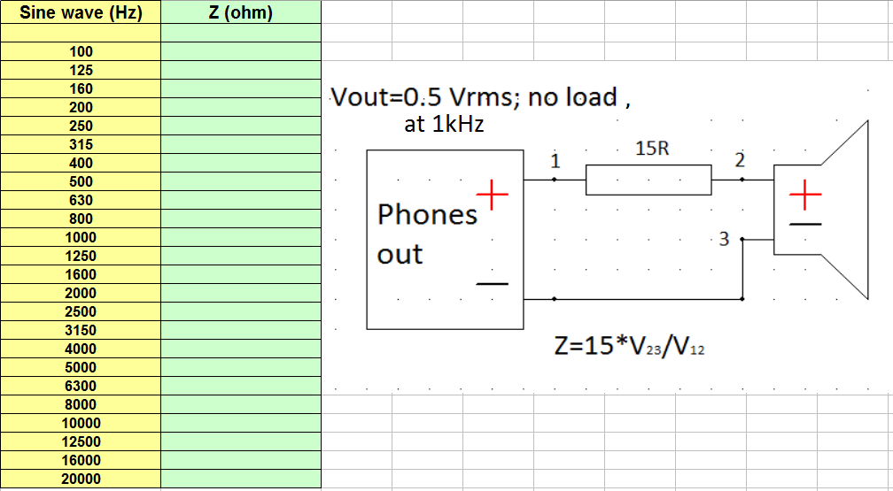

Ok, in the meantime read the REW user manual or the help files in the REW forum on how to measure impedance, and we need to record these files via simple jig to be later used in a simulation.

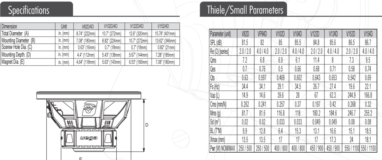

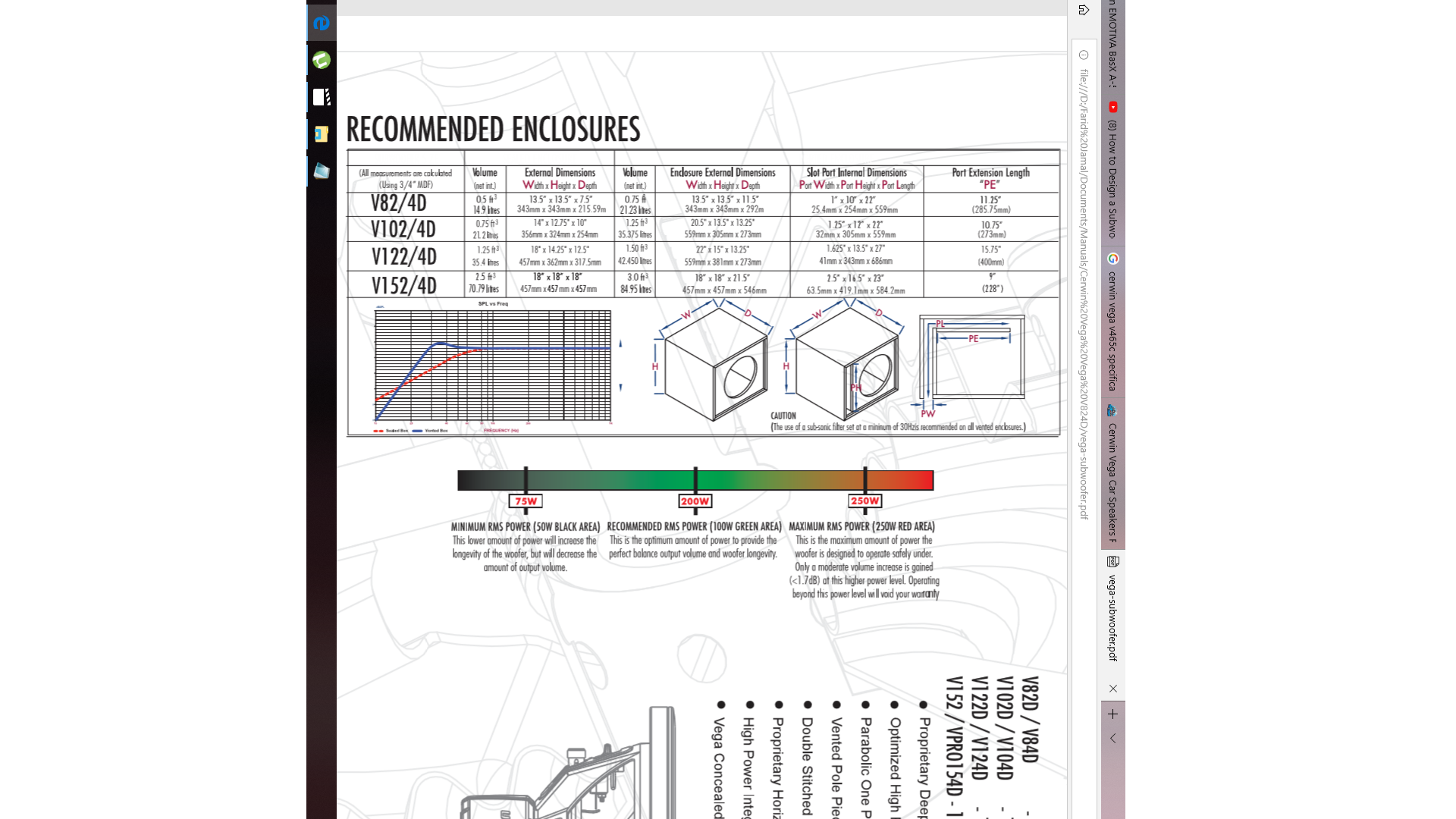

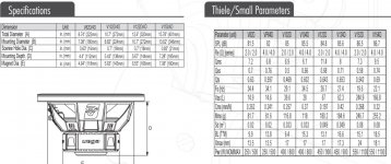

I managed to find the small parameters of the subwoofer online in addition to the box size, not sure if they could be of any help as we are measuring each component from scratch for best cross over build up.
When your laptop is short of line/mic IN, use this to measure impedance
Did some testing of a 4 ohm speaker driver and the results were reasonably close to my vintage Clio measurement gear. The data could then be imported into a Response Modeler to have the phase data calculated and this information would have sufficed to serve as a template to model a new one from 20Hz-20 kHz.
