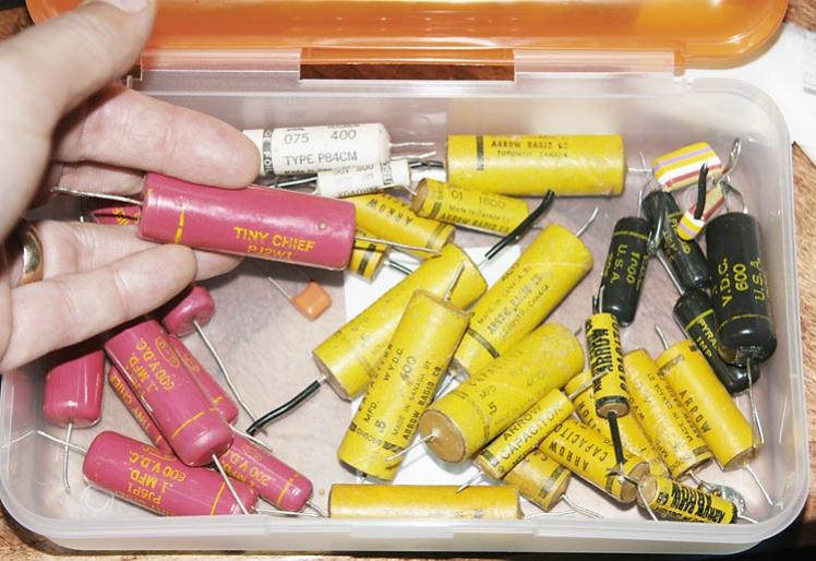

Wave, you mean these? I've got some too. 😎 The photo doesn't do justice to their 'pinkness'.
..Todd

So what you're suggesting is that I should test them (which they'll most likely measure good) and leave them in? That would definitely save me some cash, about $24-40 worth depending on which caps I went with. What about those mica caps? My father says those almost never go bad either. These caps are sonically equal to modern "hifi" caps of today?

Old electrolytics are probably most in need of replacement. They don't age well at all. And electrolytics have improved a lot in the past 50 years. Nothing special is required but you may have trouble finding much supply of caps in those high voltage values.
As long as those Sangamo's aren't leaking (current, not liquid ooze) and their value is within reason, then keep them. If you want to replace them without entering the snake oil vat, Sprague orange drop (model 715P or better, 716P) are excellent replacements. Antique Electronic Supply sells 716P's for something like a $1.50 ea. Anything more 'boutique' than those is beyond anyone's advice (though such advice is plentiful). Go with your instincts there.
Keep the micas if their value is within tolerance/reason. They've become somewhat more accurate over the years, but they don't deteriorate as far as I know.
..Todd

If the Sangomo's measure good, then I'll keep them. However, if they don't, you suggest going with the Sprague Orange Drop 716P's? Are those supposed to be better than the current Sangomo's?
