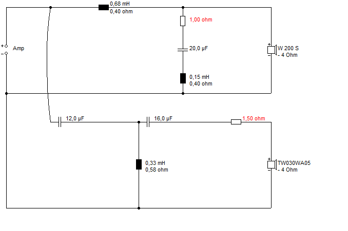

The speakers arrived today. I'm still trying it on
