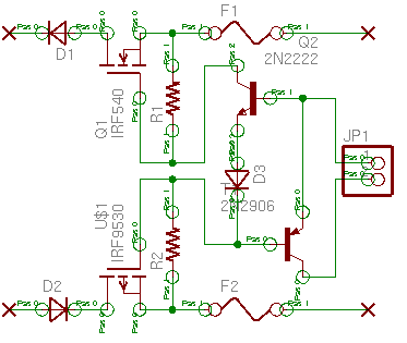

I was going to start a thread about protection schemes, but you beat me to it =)
This circuit should cut the power on the rails if either rail goes dead, or if the 3V or so across JP1 go away. It allows power control and detection (if a rail goes out, the JP1 circuit will as well) for a preamp I'm designing. I also have one that uses optoisolators, which I can post if anyone wants it. Note: I haven't tested these, and I'm not sure if the gates on the mosfets would stay open if the protection circuit is on a capacitive load. It should shut the circuit off, but the prototype of this omitted the diodes and stayed live until the caps discharged (bad). This was especially bad because it drew the current backwards from the opposite rail. =)
Will
Note: the mostfets in the schematic are not complimentary pairs. My eagle libraries didn't have the ones I needed, so I used an approximation. They should (theoretically) be both IRF530/IRF9530s or IRF540/IRF9540s. Also, the amp would connect on the left side, and the PSU on the right.
Will
Bill Fitzpatrick said:I always say, "If you're tired of your 5amp fuses blowing, wire a 4amp fuse in series with it."
Now that's more like it.
A good designer always protects the output transistors, speakers and fuses - people all too often neglect to protect their expensive fuses from blowing.
