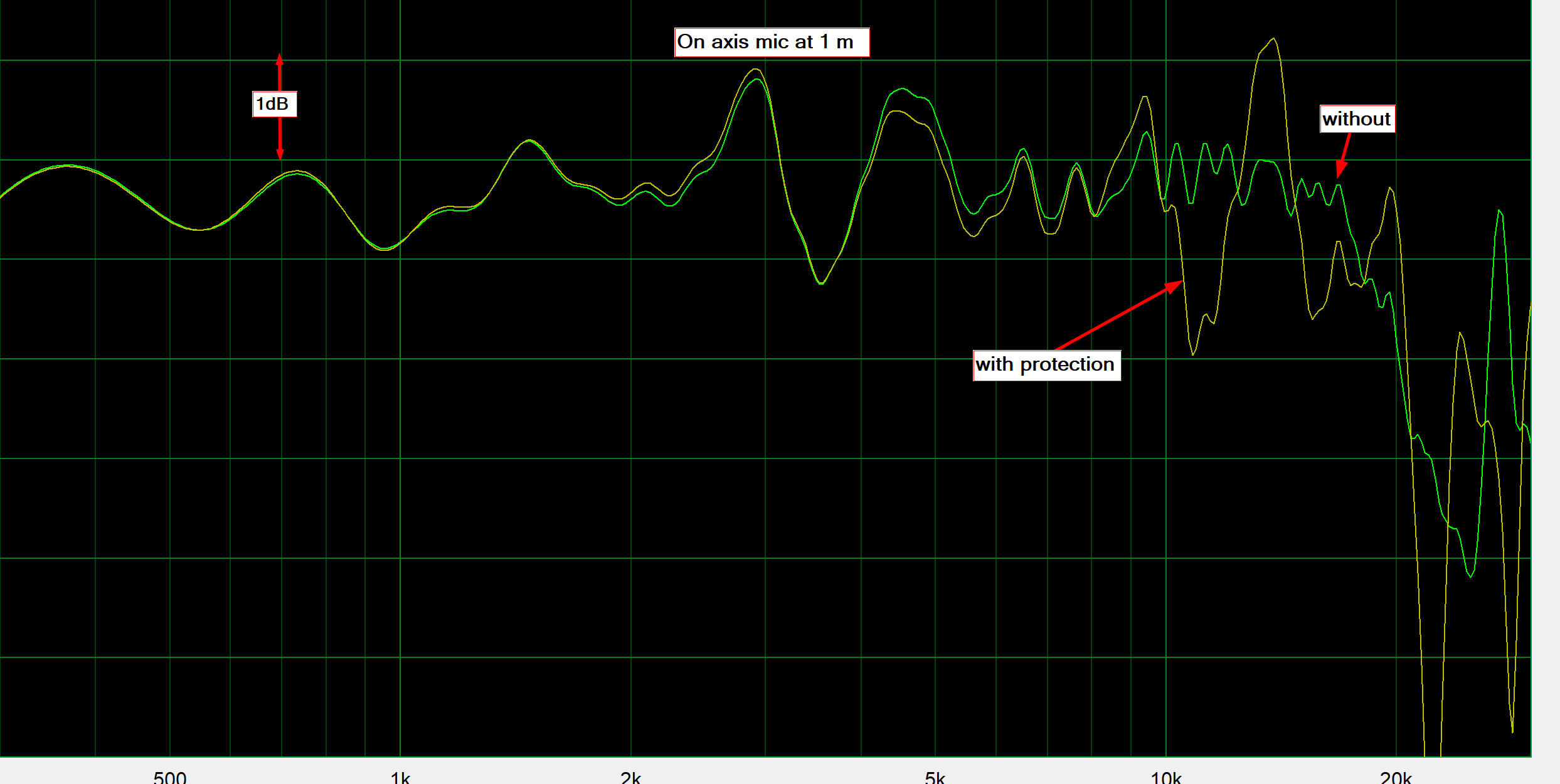

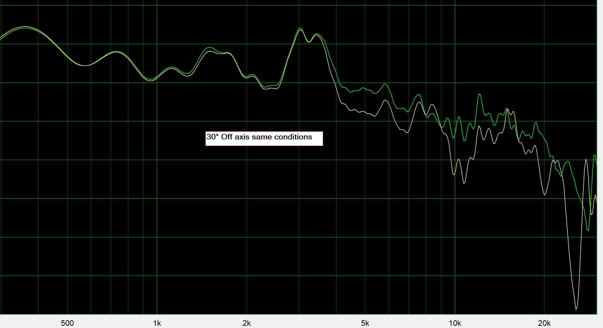

Yes, It was really nice to see that the original grill can be fitted without much problems to protect that expensive Be dome !
Below comparison with/without grill on axis and at 30°. I did the test on a 180° range and the "worst" case was on axis
So how exactly did you mount the grill in the waveguide? It's the only thing holding me back from sticking the t34b in waveguide. Also how is the grill removed from the stock tweeter? Thanks
I use cyanoacrylate glue to fix the grill on the waveguide. If I had to do now, I would use rapid epoxy.
I followed what Stan recommended to me : 10 min in a 70°C oven (check the real temp first !) After that it is quite easy to remove the grill. Rember that grill is a metal attracted by strong magnet nearby. Frankly it's not difficult
Great to show these details - thanks!
Did you try to cover the grove for the grill and do a measurement? Sometimes these little groves have influences similar to what's shown here.
I have to design a speaker for very high frequencies for a customer for measurements and these little surface disturbances all leave their mark, but often at very high frequencies.
