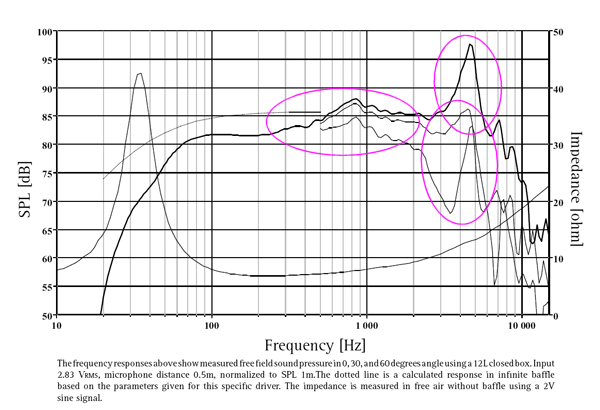

That is a valid approach, but again the things I talked about come into play. The simplest crossovers are typically used with drivers that have inherently flat response and smooth roll-offs. The modern trend in high resolution drivers is at odds with this approach. As an example, the Seas magnesium woofer below has a rising response trend through the midrange, very large peak at breakup, and inconsistent off-axis response around breakup. Those require careful use by rolling off before the uneven regions or using crossover complexity to correct the midrange rise and potentially to suppress the peak at breakup.
If by "well known recipe" you mean starting with a defined kit/build, that would be advisable if you want a more certain result in one shot and aren't interested in learning about a lot of details and methods at this point.

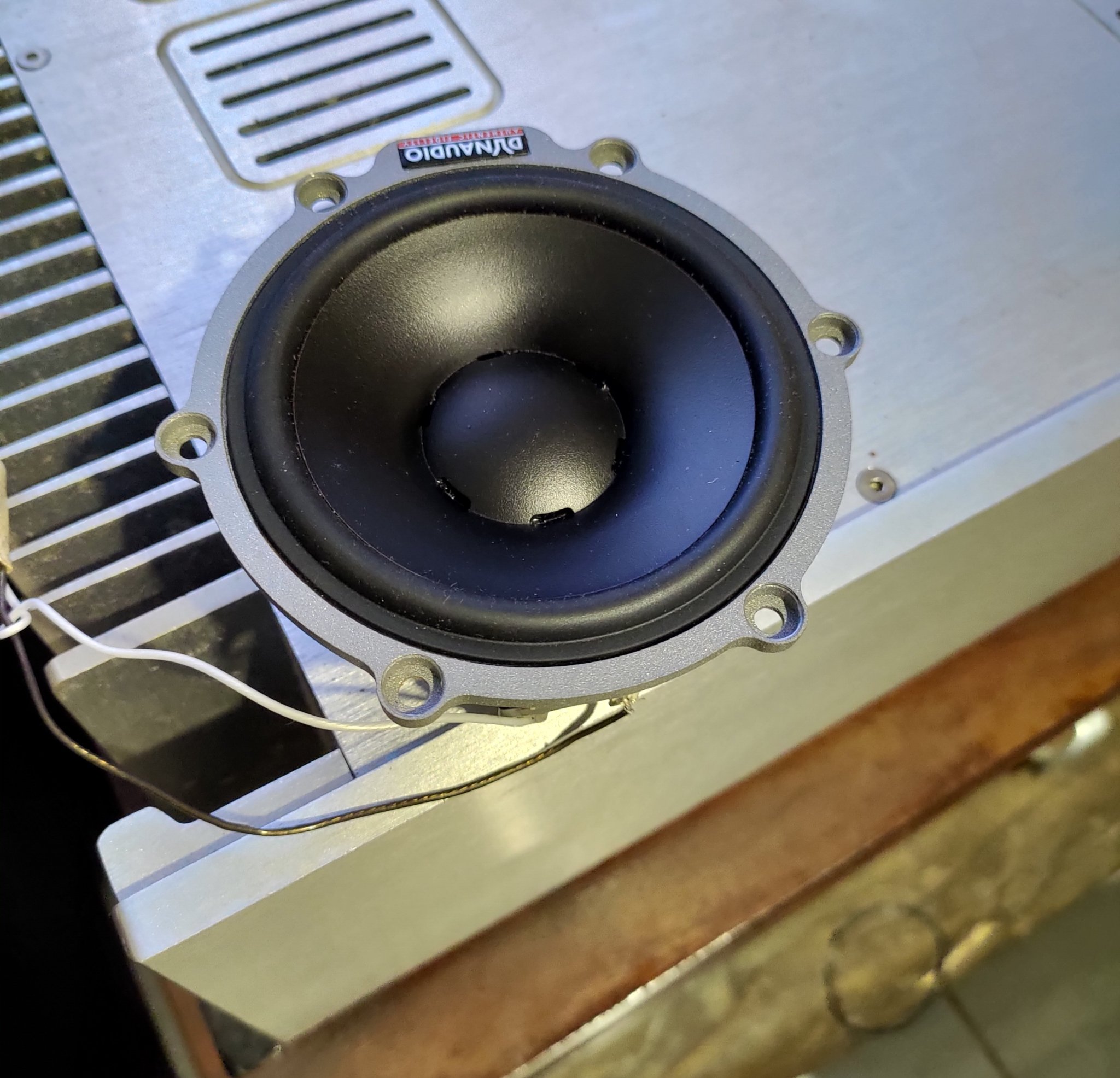

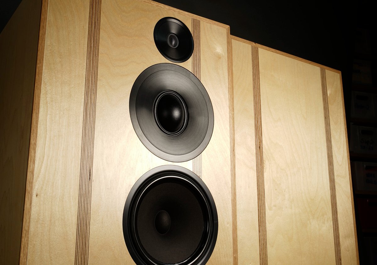

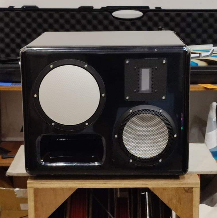

high end? hmm get one of this Dynaudio esotar 430 midrange, i will combine it with 650 midwoofer, my 24W100 just too big.
another midrange candidate will be : SS Elipticor mid which have been used in one of Troels project, or Accuton mid which is used by Vermouth studio monitor
