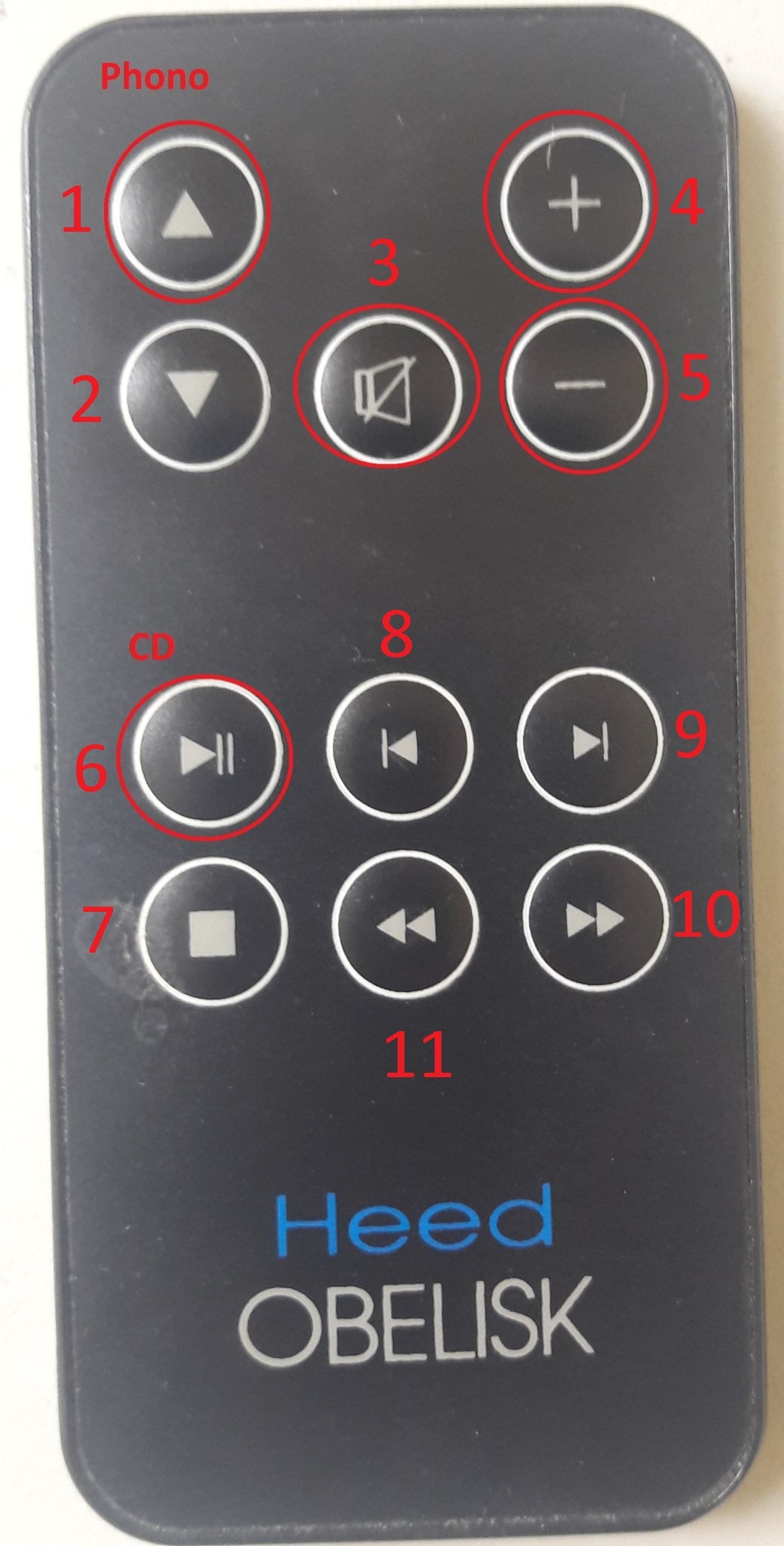

The +/-/Mute button works properly for volume control. I can switch between these two inputs by alternately pressing Phono and CD. The controller does not respond to any other buttons. I would like to be able to select the other inputs. A display on/off would also be great.
Are there any other functions currently available on the controller?

Load the attached contents of the attached zip file into a new folder (call it ESPRemoteTest) within the PlatformIO /Projects folder on your PC. Temporarily upload this to your ESP32 setup. It will enable you to press each button on your Heed remote and note down the address and command that is generated. These will (should be) displayed on the TFT screen. They will also be available via the serial monitor in Platform IO (available on the bottom toolbar of PlatformIO.
Once we know the address/command for each of the buttons on your remote, we can rewrite the relevant bits of the RC5Update() routine to suit your controller and what commands you want to have.

The codes (B=button)
B1= a:16 c:1 t:1 or t:0
B2= a:16 c:0 t:1 or t:0
B3= a:16 c:13 t:1 or t:0
B4= a:16 c:16 t:1 or t:0
B5= a:16 c:17 t:1 or t:0
B6= a:20 c:53 t:1 or t:0
B7= a:20 c:54 t:1 or t:0
B8= a:20 c:33 t:1 or t:0
B9= a:20 c:32 t:1 or t:0
B10= a:20 c:52 t:1 or t:0
B11= a:20 c:50 t:1 or t:0
When the same button is pressed consecutively, the value of "t" changes between 0 and 1, the values of "a" and "b" are always the same.

Deenoo:
I've gone through the RC5Update() routine within main.cpp and amended it to align with your requested button functions. The attached zip file contains that amended controller coding. Create a new folder within the PlatformIO/Projects folder. I suggest you call it DeenooMuses Then extract the attached zip file into it. If you upload this to your ESP32 that's controlling your Putzeys/MUSE72323 board, you should achieve your requested set of functions.

To help you understand what the decoded data means - a:16 - Address 16 is for amplifiers, a:20 - Address 20 is for CD players. The t:1 or t:0 (toggle0 or toggle1) relate to whether a button is being held down or a new button has been pressed.
For amplifiers (a:16)
  • commands 0 -9 correspond to digits 0 to 9
  • command 13 corresponds to Mute/De-mute
  • command 16 corresponds to Volume increase
  • command 17 corresponds to Volume decrease
For CD players (a:20)
  • command 53 corresponds to Play
  • command 54 corresponds to Stop
  • command 33 corresponds to Previous
  • command 32 corresponds to Next
  • command 52 corresponds to Fast forward
  • command 50 corresponds to Rewind/reverse
  • In the coding, it enables simple verification of what the user wants from a button press and enable correct functionality for short button press and button held down. Examples are as below
  • Holding down a Vol+ or Vol- button will allow the volume setting to be smoothly increased or decreased while the button is held down.
  • For Mute/de-mute, holding down the button will only toggle the mute on or off once, not continuously flip back and forth between muted and original volume.

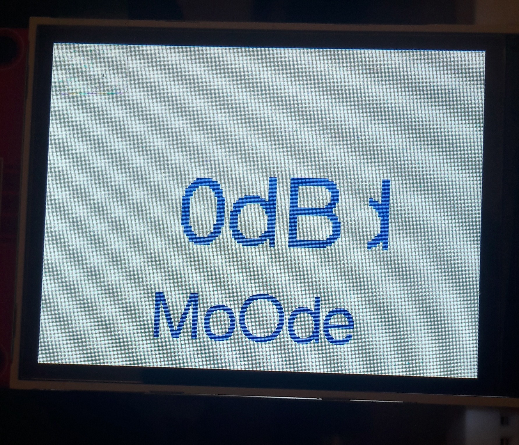

When muting (MUTED) is switched off, a character trash remains on the display in the range 0-9dB. Can this be removed? Thank you!
Yes. Simply add an extra space character into the line shown below of the setVolume() routine
sprintf(buffer1, " %.2fdB ", atten);​
This will then overwrite the leftover partial character from the "Muted" line.
You might take the opportunity to adjust your MoOde string too 🙂

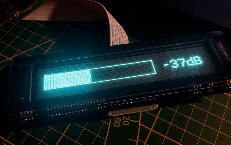

I've been following the original thread and thought that perhaps my display module would fit nicely as control + display board for MUSES72323:
https://www.diyaudio.com/community/threads/front-panel-vfd-and-control-knobs-modules.416868/
There is an STM32 mcu and all the necessary signals are routed to 12 pin header, such as:
1. SPI (this is what needed to control MUSES)
2. STM32 programming pins
3. UART, I2C - these can be used as GPIOs to select inputs, for example.
I'm using U8G2 library to draw things on display and there is a lot of support material for it, even code generators like lopaka.app.
The source can be published on my github, no issue here.
So far I've been using it with encoder to control relay attenuator. I do not have MUSES chip yet for experiments but perhaps someone would be interested in big VFD for such project.
