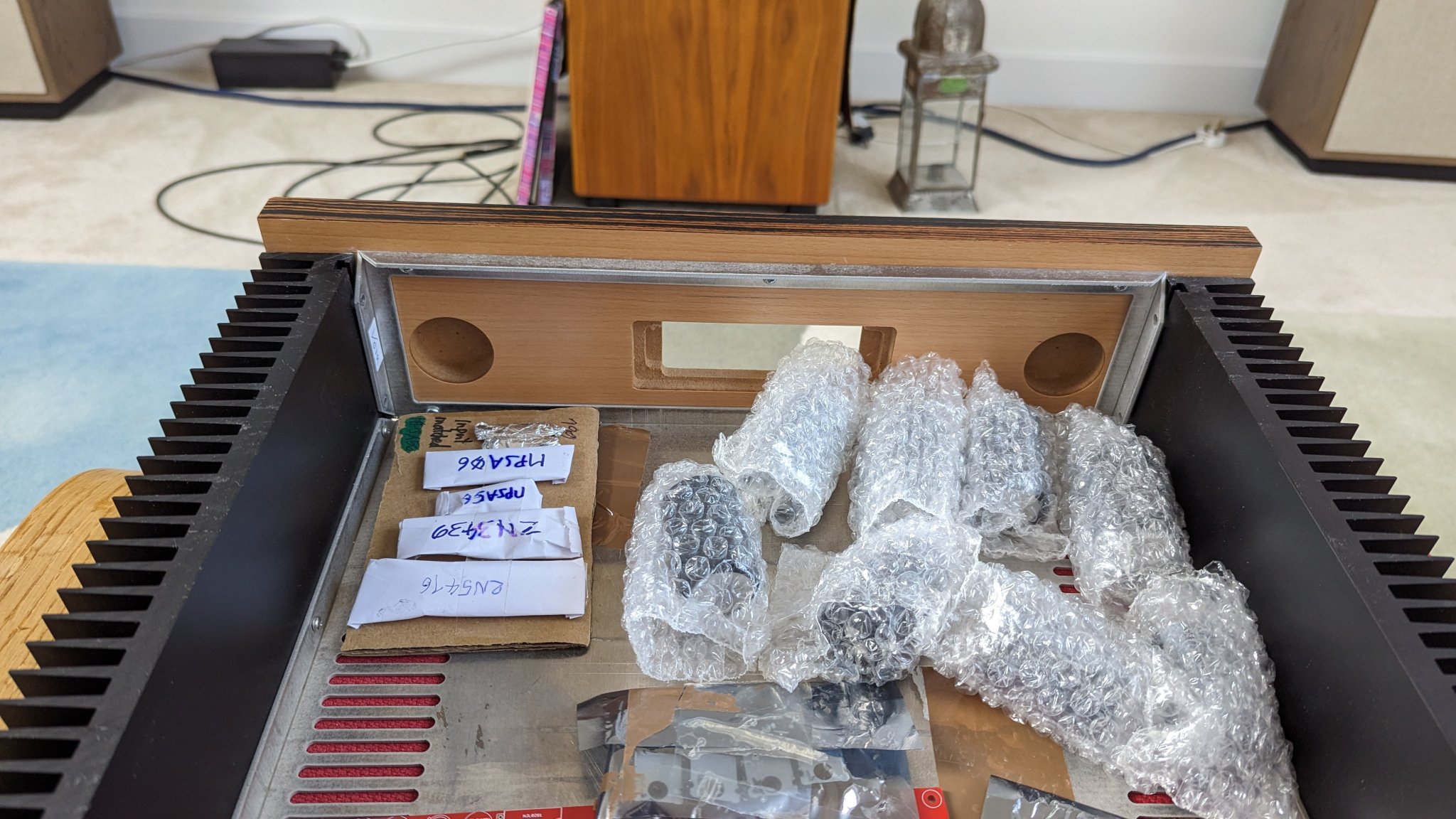

I'd be interested, can't start a message chain because I'm new, but I think you can message meStill sat on my shelf if someone wants to buy it.

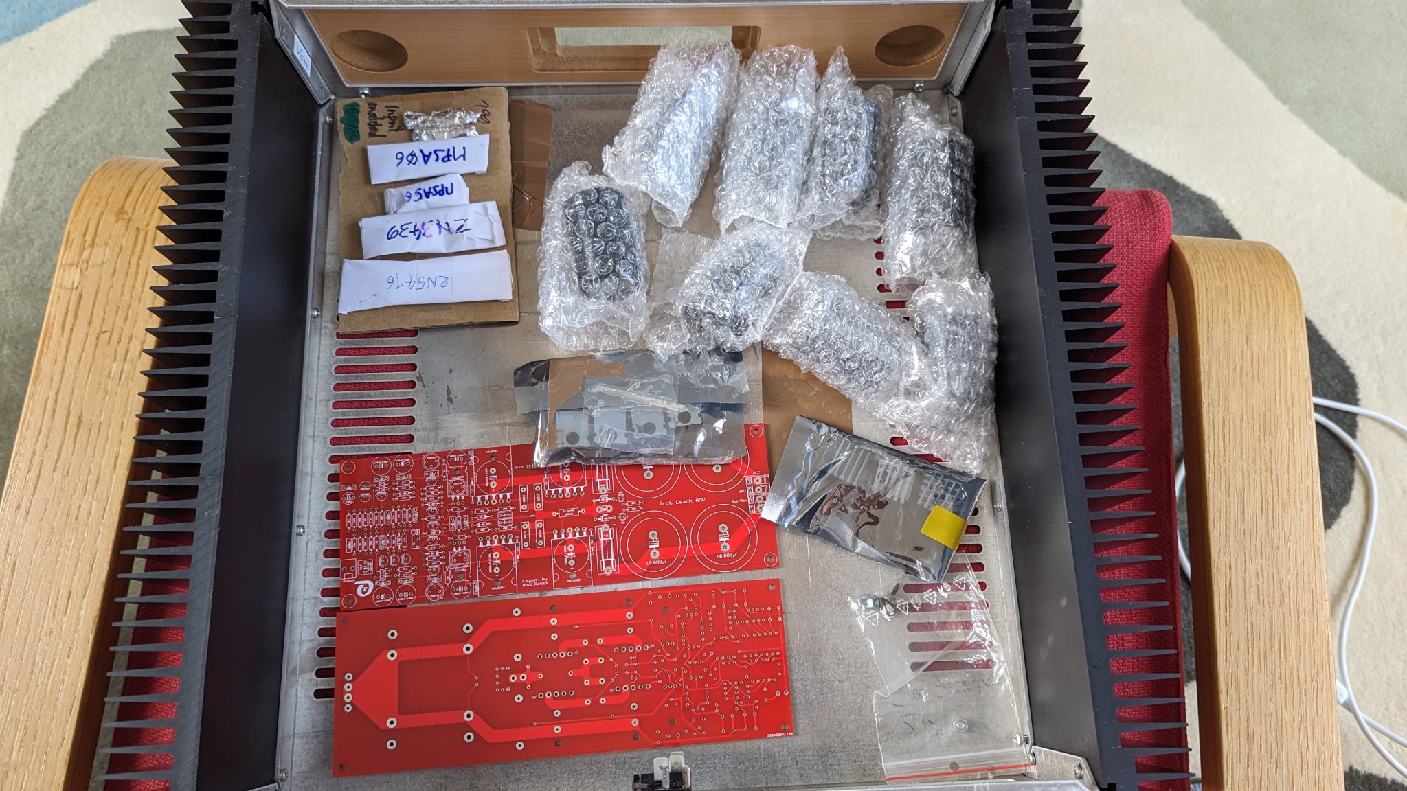

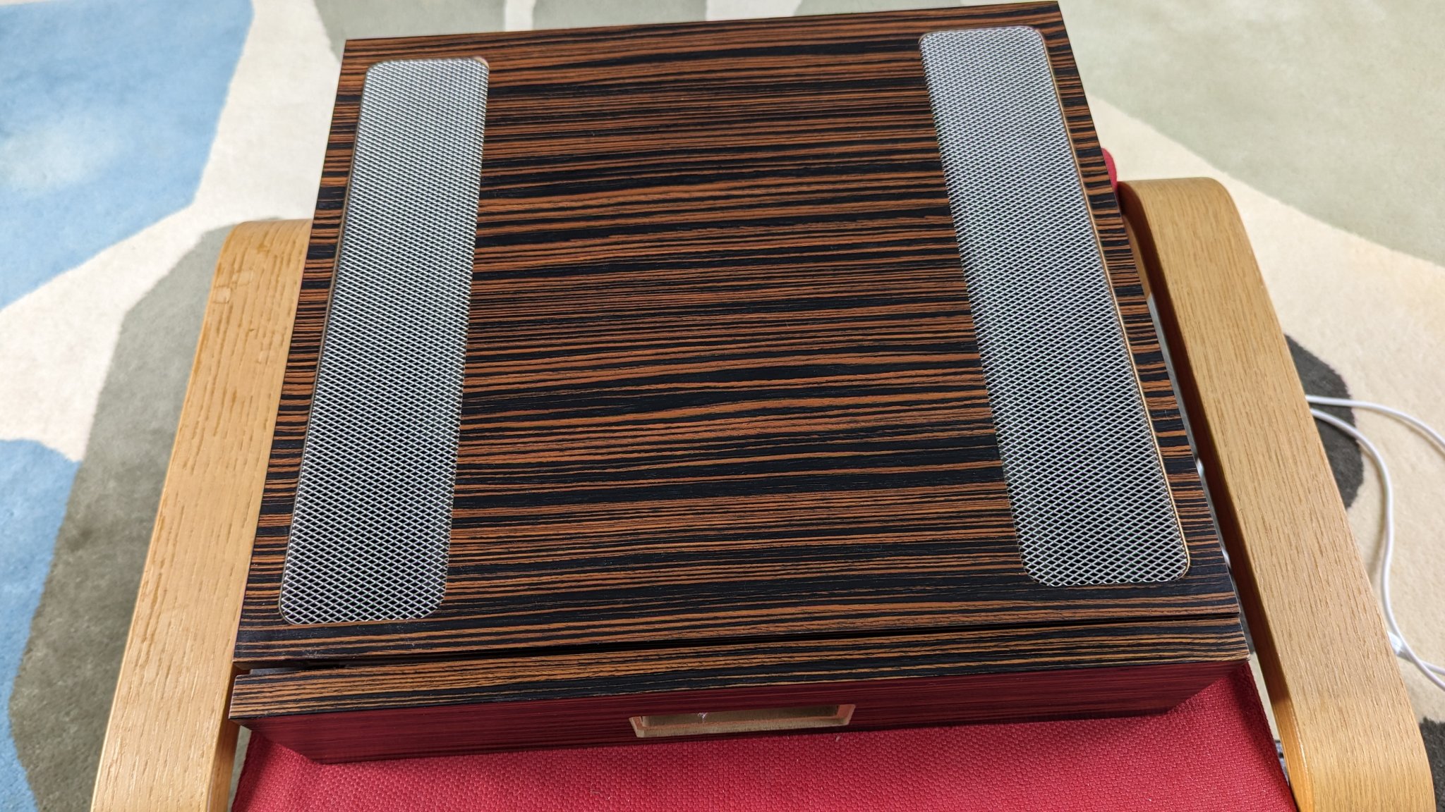

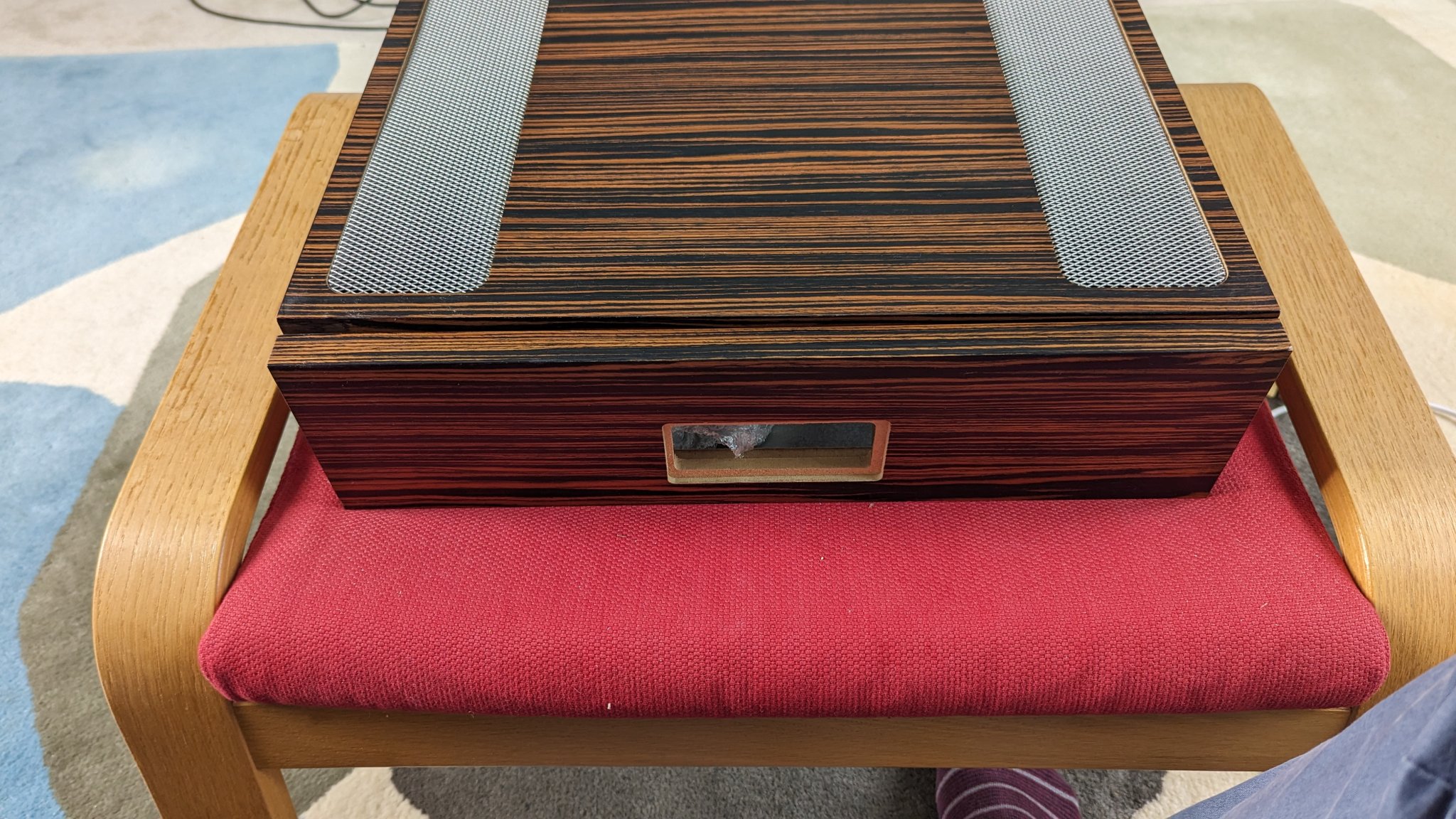

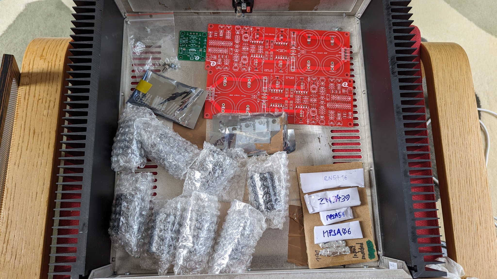

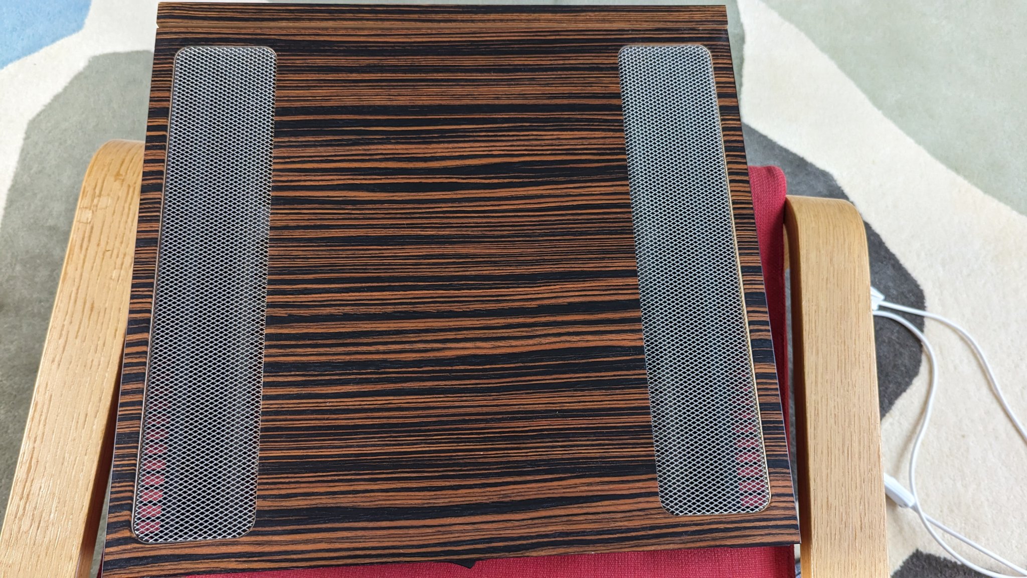

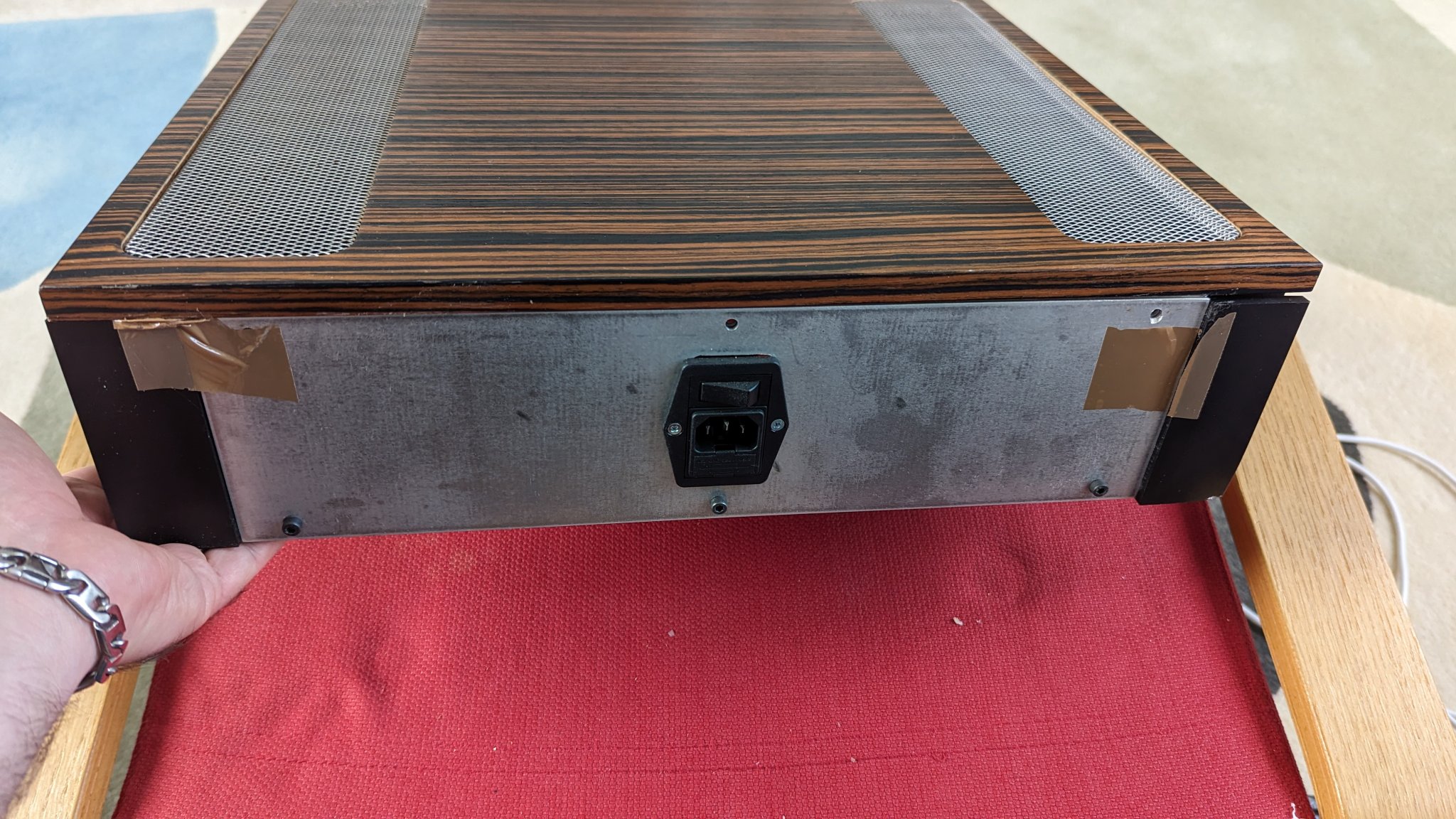

I'll post a few pictures here...
