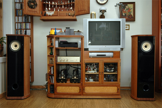

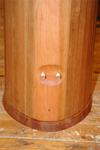

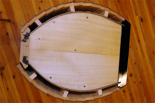

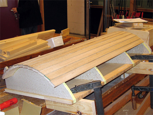

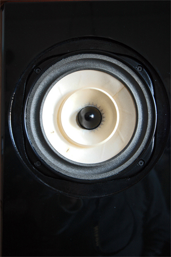

Ok, here`s some facts:

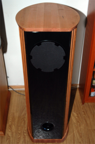

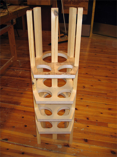

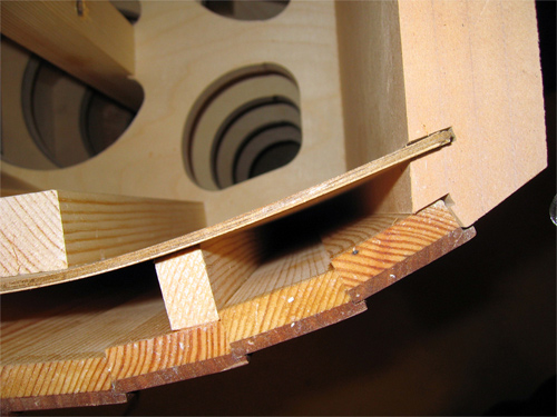

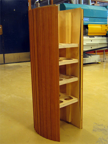

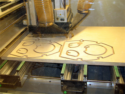

This project has been going for a while. Not a very easy project I have to say. A very complex construction with no square corners, and fine sand between the inner and outer panels. I am using Lowther DX3 in this project.
So far so good.
