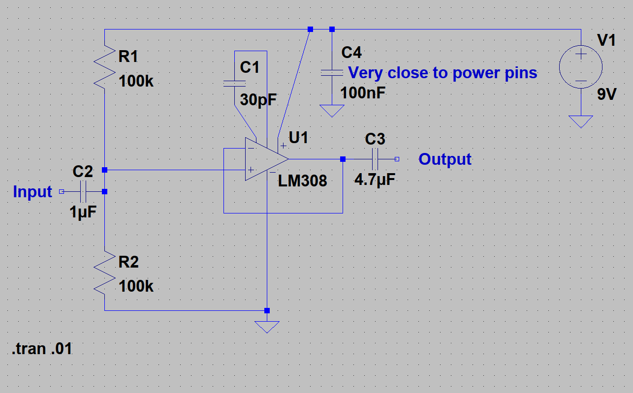

I suspect (but without proof at this point) that the problem is that your LM308 is unstable, and is oscillating at very high frequency (too high to hear). Fast op-amps often don't like bread-boards very much, and can be quite sensitive to layout.
Since all sorts of mysterious things keep happening with the Rat circuit, my suggestion is to start with a very basic circuit - an op-amp voltage follower - and once that's working, add on components one by one, until the whole circuit works as it should.
The attached screen capture shows the circuit I suggest starting with. It uses components you already have (they are all part of the Rat schematic you posted.)
If you have any pico-farad caps that are bigger than 30 pF (such as 47 pF, or 100 pF), I suggest using one of those for C1 instead of 30 pF; this will slow down the op-amp a little, and make it less likely to oscillate at radio frequencies.
Once you get it working, this circuit should behave as a clean buffer. No gain, no loss, whatever guitar signal goes in should come out virtually unchanged. And, as before, DC voltage on pins 2, 3, and 6 should all be half battery voltage, around 4.5 volts.
Get to that point first, then we can add on to it, step by step, until it becomes a Rat. Or one or both of us gives up in total frustration. 🙂
-Gnobuddy

I have output!!!!!
But not clear. It has a lot of noise and I can here the input in the background. One more thing that I noticed is that when I move my hand closer to the circuit without touching anything the noise increases in volume.

Okay, that suggests the basic circuit is correct. 🙂I have output!!!!!
The circuit may be oscillating, or just picking up electrical interference, or both. (This is why guitar FX pedals are almost always built inside metal boxes, which are grounded, to reduce noise and interference reaching the circuitboard inside.)...a lot of noise...when I move my hand closer to the circuit without touching anything the noise increases in volume.

Hmm. Pin 2 & 6 should be identical (they're wired together!), and pin 3 should be within a couple of millivolts of the other two.Voltages at pins:
2->3.7V
3->4.3V
6->3.6V
I'll buy 3.6V and 3.7V - they're close enough to be identical. But pin 3 being so very different raises questions. If the op-amp is working and stable, this cannot happen; so the op-amp is either not working, or not stable...and I suspect it is the second of these. I think your LM308 is not at all happy about being on a breadboard, out in the open, without a grounded metal box around it, and is oscillating like crazy.
This is where a good oscilloscope is worth it's weight in gold (it can show you the oscillations if they're occurring), but I'm gonna guess you probably don't have one; they are expensive tools.
Why do fast chips have problems with solderless breadboards? If you could look inside a breadboard, you would see a collection of short metal strips, spaced about a millimetre apart, each one about 25 mm long (see attached image.) This creates lots of small stray capacitances between adjacent metal strips (which correspond to adjacent rows of holes in the board.)
The net result is as though you had wired a small capacitor (a few pF) between every two pins of the op-amp. Some op-amps will tolerate this abuse (usually slower ones, which are fully internally compensated). Other op-amps will not, and will burst into oscillation instead. I think that's what you're dealing with here.
There is a chance that putting grounded metal under and above the board, as described earlier, will calm the LM308 down. There is also a chance that moving the LM308 off the breadboard, and onto a PCB, will calm it down, because there'll be a lot less stray capacitance.
-Gnobuddy

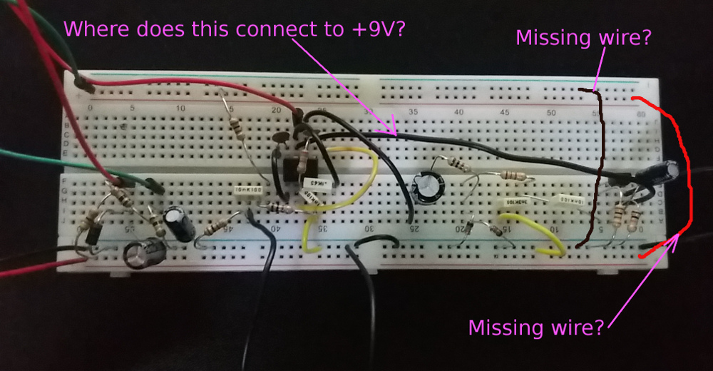

This might be too late, but in case the OP is still monitoring this thread:
I looked at the breadboard photos from post #18 again. I can't see any connection from the op-amp to the +9V rail - is it missing? Or is it well hidden and I'm missing it?
Also, I don't see a wire connecting the two (-) rails together - is it missing? There is no internal connection inside the breadboard that does this automatically, so you have to do it with a jumper wire. Otherwise one rail will just be floating, not connected to anything at all, useless for powering anything connected to it.
And the same thing for the two (+) rails - they should be wired together. Is this wire missing? I don't see it.
If you forgot to connect pin 7 of the op-amp to the +9V rail, and/or one of the breadboards (+) rails and one of the breadboards (-) rails was not connected to anything at all, it would explain why you kept getting 0 volts on the op-amp output.
If the op-amp wasn't grounded either, and just floating, it would explain the huge amount of noise you found.

Still here! Never too late!This might be too late, but in case the OP is still monitoring this thread:
It's the red jumper wire that is connected to pin 7 of the IC. The black cable that goes to the transistor is also connected to pin 7 so it has 9V.
I am connecting the two down blue rails with a black wire (under the number 30). I dont connect the upper rails to ground because I didn't use them.
Pin 4 is connected to ground through the yellow wire.
Excellent! This is such a simple circuit, and the issues you've run into are so bizarre, that I keep thinking there must be a very simple mistake somewhere. Let's keep digging, looking for it!Still here! Never too late!
Two questions:It's the red jumper wire that is connected to pin 7 of the IC.
1) Where does the other end of that red jumper wire go?
2) Where are the wires that connect the battery to the breadboard?
3) Then why is the dark green jumper connected to the top + rail at the top left corner?...upper rails...I didn't use them.
4) Also, the resistor crossing over the number 15 on the breadboard plugs into that upper + rail. Is there +9V on that rail? If so, how is power getting to that rail? I don't see the wire bringing +9V to that rail.
I did notice that.Pin 4 is connected to ground through the yellow wire.
But where is the 0.1uF ceramic filter cap that's supposed to be connected between pins 4 & 7, as close to the IC as possible? Without that cap, the IC is very likely to oscillate and misbehave.
-Gnobuddy
Two questions:
1)The one end as aforementioned is connected to pin 7 of the IC and the other end is connected the D3, C11 positive pin C12 and R11. (in the photo is next to the on end of green jumper wire- bottom left)
2)This are the two wires at the beginning of the rails (red is +9v and black is the ground, bottom left at the photo)
3)That's the +4.5V rail.
4)This resistor is R2 in the schematic.
Thats the cap 1k63 (its upside down) at the bottom right of the IC. I used a film capacitor. Is there a problem with that?
One pin is connected to the pin 4 of the IC and the other end is connected to the pin 7 through a black jumper wire.
The picture is misleading! They were connected to the same raw.

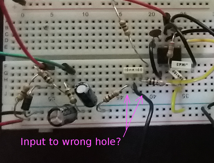

The picture is blurry and out of focus, and some of the colours are hard to see, so it's hard to tell resistor values. But are you 100% sure the input signal is actually getting to pin 3? Can you double-check if the wire really is in the correct hole? It sure doesn't look that way in the photo. 😕The picture is misleading!
In an earlier post you wrote "The signal is very low...output signal is lacking most of the low frequencies." Both these symptoms could occur if your input wire is plugged into the wrong row, and only a tiny amount of stray capacitance in the breadboard is actually connecting the signal to the op-amp.
Even if you've abandoned this project and move on, there is value in finding out what mistake you're making in the Rat prototype. That way, you can avoid making the same mistake in future projects. Mistakes are fantastic learning opportunities! 🙂

Excellent news! Congratulations!I used a dual op amp (specifically the TL072) and used only the one channel and it works!
If you go back and re-read my post #25, I suggested trying exactly this (using one half of a TL072).
