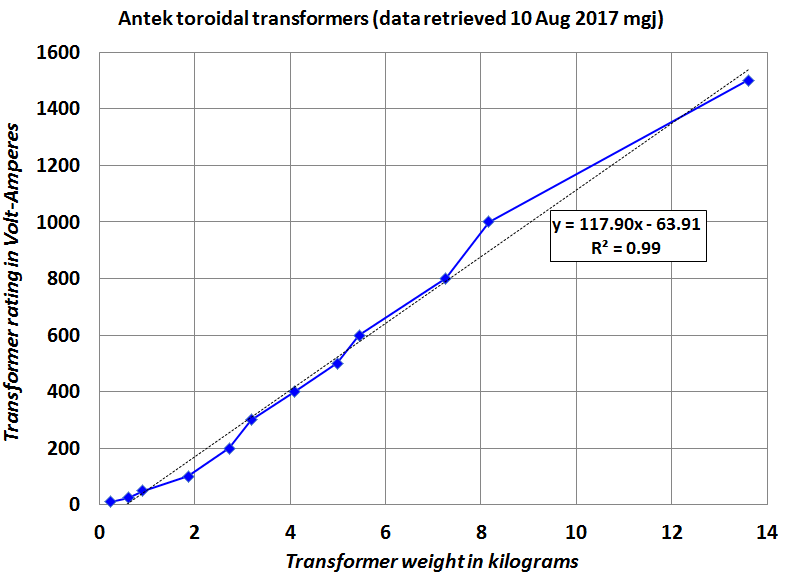

Assume your transformer manufacturer uses the exact same materials and the exact same ratio of copper to core, as the American transformer company "Antek". Then use this graph. Then get your 15 year old niece who's taken algebra, to help you interpret the linear equation which best-fits the experimental data. And Bob's your uncle.

Data of post 3 is going to be typical of 50-Hz-capable toroids. For 60-Hz-only you get a little more power to weight, as you can usually go down one core size since you drop the # of turns 20%.

  3. Estimate the total Volt-Ampere rating by weighing the transformer and interpolating on a weight-versus-VA plot
