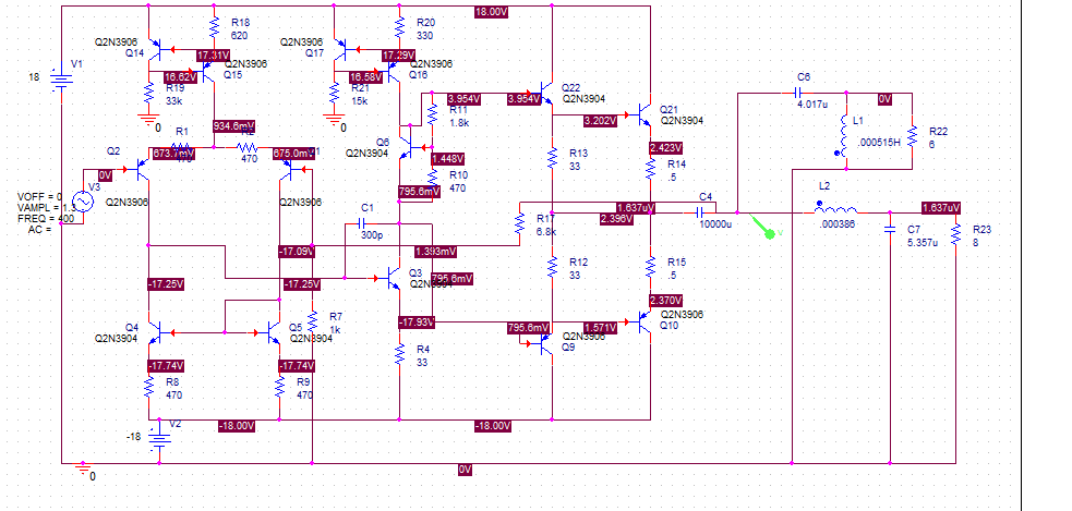

The Vbe multiplier to bias the output stage is not working correctly in my amp. When I disconnect the output stage from the rest of the amp, it works fine, dropping about 2.9V. However, when I hookup the output stage, the voltage across the Vbe multiplier jumps to about 11 or 12 Volts, which fries the resistors in the output stage. Maybe the base current drawn by the output stage is messing it up. I am at a loss because the PSPICE simulation of the circuit runs smoothly. Are PSPICE results generally not very close to reality? This is my first amp so I don't have much experience here. I have a picture of the circuit. The only difference is that I'm using BC337 for the small signal NPN and TIP31C and TIP42C for the output transistors. Anybody have any similar experiences that they could share with me?

Spice sim usually agrees pretty well for this kind of stuff, given good models...
a few questions...
1. are your really using 2N3904/06 for the output devices? They will last about 2 milliseconds in this application.
2. 2N3904/06 as drivers also aren't long for this earth...if things are working well, they would dissipate almost 350 mW...but not for long!
3. feedback to R17 is taken on the wrong side of C4...there's no DC feedback...so you see the input stage voltages look suspicious...
Perhaps I'm just mis-interpreting some of the connections, so please feel free to set me straight...

I am using power BJTs for the output. So you're saying that the negative feedback should be on the left side of the coupling cap?
Use the TIP31C and TIP42C power transistors in your simulation.

Tou will need something more beefy for pre-drivers as well.

Definitely do as djoffe says regarding the feedback take off point.
Could the amp be oscillating ? Try slapping a 22pf cap across R17.

So I took out the ouput cap completely as djoffe recommended. Now the Vbe multiplier is dropping a nice 3V but there is still a ~4.5 V drop across R14 for some reason which obviously results in way more current than it
can handle. I also checked the difference between the emitters of the pre-drivers and that was around 10V I don't understand how that's even possible given the difference at the bases of the pre-drivers is only 3V due to the Vbe multiplier. At this point I'm just thinking that either I'm hooking it up wrong or these components are fried from all this abuse and I should maybe replace all the transistors and resistors in the output stage. I'm assuming it's the latter because I have checked over my work several times...
First thing to do is apply a short across the vbe multiplier. That forces the voltage and output stage current to zero. The amp should work correctly in that state with just a small amount of distortion.
I would rebuild and recheck the amp doing that and only when its working correctly move on to adjusting and testing the vbe multiplier.
Did you try a cap as I suggested (although it won't help if parts are zapped of course)
