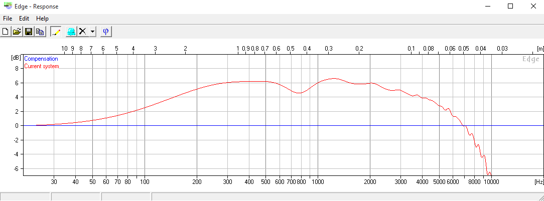

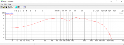

I haven't done much yet. I did do a sine wave frequency sweep using an audio frequency generator (real one not PC based) and no significant peaks are showing up. One thing I didn't like is the baffle step dip which showed up on my edge analysis program (between approx. 650 to 900hz) looked a lot deeper than the program projected. I don't think that dip would have anything to do with my problem though. Note this graph is midrange drivers only and my 290 - 360hz lower crossover point is just top of the baffle step thus that isn't an issue.
I'll get to the additional measurements. Free time has not been good to me.

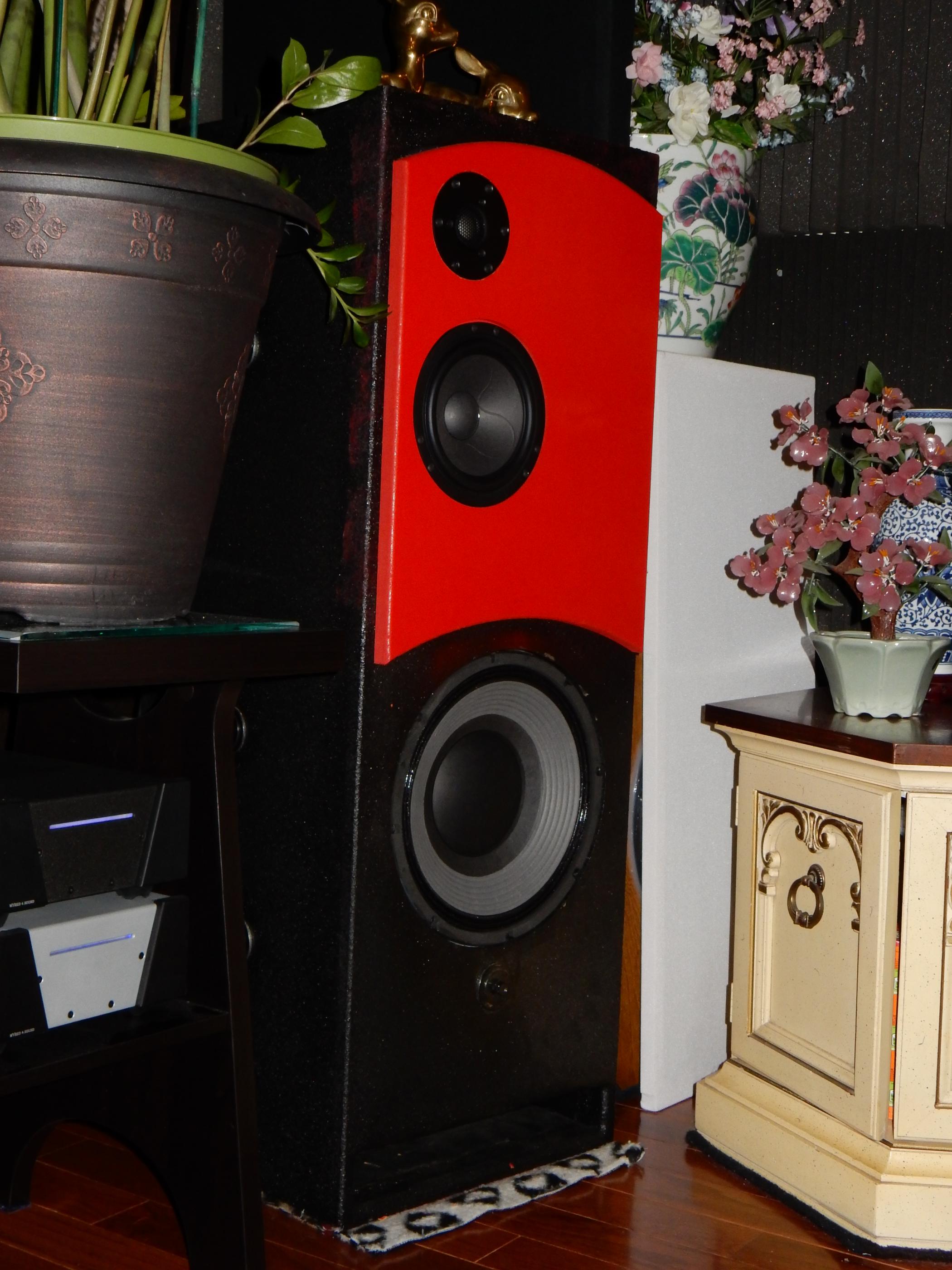

I know some will be disappointed but I gave up on using the two 12MU's. I don't know what the hell. I played for many many hours with the omnimic. Distortion and other measurements I got were all very similar to what I found for that driver on the internet. Nothing bad showed up.
I have one theory and again it's only a guess. I play my music loud at times. The anomaly I was trying to solve only showed up at fairly loud volume. To me not to loud but kind of loud. Turn it down a little an the anomaly disappeared. The 12MU only has 3.5mm Xmax. Possibly I was pushing Xmax at higher volume?? I don't know.
I switched to a single 18WU/4741T and everything is solved. It sound VERY good. Seriously I'm happy with them and can live with them.
Pictures below but please no making fun of my cabinets. I'm not much of a wood worker but they are nice and solid with bracing and what not.
If anyone lives near the north Denver area I'll give you a FREE pair of 12MU's as thank you for the help people tried to provide for me here. The other pair I'm going to use for a smaller system I'm gonna build for the tv down in the family room. The drivers are perfectly fine I didn't damage them in any way or anything. Again free if anyone is close enough to come and get. I can't ship them because I didn't save the boxes.

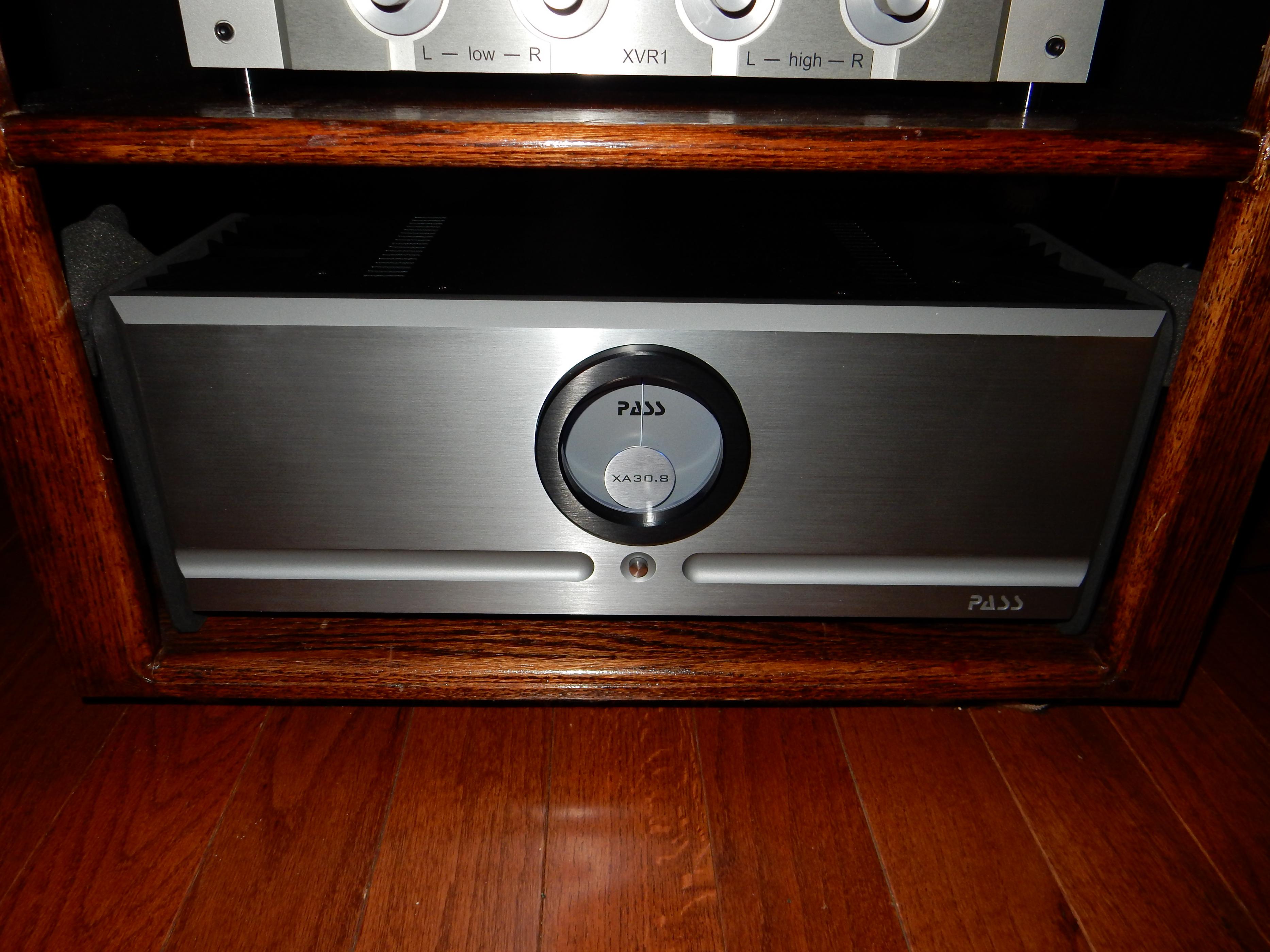

Pass Labs XA-30.8
I thought I'd give a quick plug for these new amps from Pass Labs. Conservatively I'd say I've owned more than 20 high end power amps over the last two years. Some of them 100 lb plus monsters. Prior to now, my favorite amp excluding Bass was an Audio Research Reference 110. It had a sweet midrange that was hard to beat.
The XA-30.8 is heads above every other power amp I've ever owned. I'm running it above 300hz on the ScanSpeak 18MU midrange and D3004/6640 Beryllium tweeters crossed over at 2500 hz.
Last night I cranked the hell out of I-Robot by Alan Parson's project. They hit hard yet the needle didn't even inch up.
This Power Amp is a keeper.
