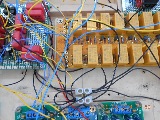

ZenMod, of course you're right, but I donT know wether the fotos will help.
Looks a bit like there are too much wires in ths dac, but most of the are really necessary.

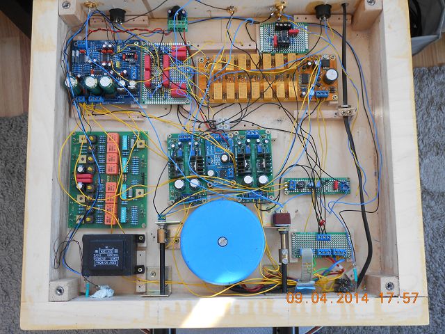

First picture is the whole thing.

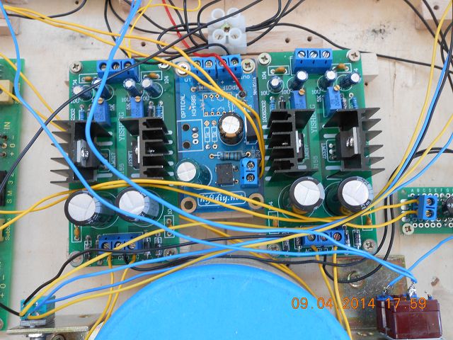

In the left corner there's the dac, then comes the balanced B1 Buffer with symmetric power supply and caps at the input and then the balanced relay volume control from ebay seller jimaudio. Above the volume board is a little, still unused cmoy headphone amp. The posts between the power supply boards is my star ground. I have all signal grounds here. Left under the dac is a subwoofer of course unused in the moment. I know I have to route the wires a little nicer, but I can't really think, that is the reason for the hum trough the balanced/unbalanced conversion. Moore detailed photos soon.

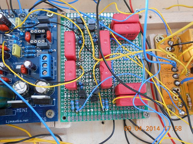

Second picture.
Balanced DAC output from chip with 0,47uF, 220Ohm and 100KOhm to ground.
Than volume control with input impedance between 10K and 1M and output impedance between 4K and 1M Ohm. From there I go straight to my Aleph 5 and that works very well, but the conversion to unbalanced is huming.

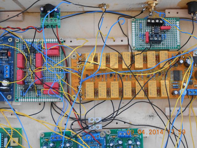

Last a close up of the board arrengement.
My diverse balanced unbalanced converter boards are not in the pictures, but they are standart schematics. I tried one with ina134, one with one ne5532 and one with ne5532 and buffer, but all have the same problem: hum.
Only when I go from the output of the volume board through the 1K Ohm resistors in the output stage of the dac board (NE5532) I get no hum, but a very distorted sound.
When I install my NAD S300 amp with its balanced input and left it trough the rec out, there is no hum but the balanced unbalanced stage of the NAD is not really easy. Lot's of discrete transistors and two OP amps.
Next thing I will try is an INA134 board with + - 9V batteries, but I don't have time before weekend.
Any help ould be vary welcome, maybe I made a totally dumb error somewhere (It would be not my first one...).
