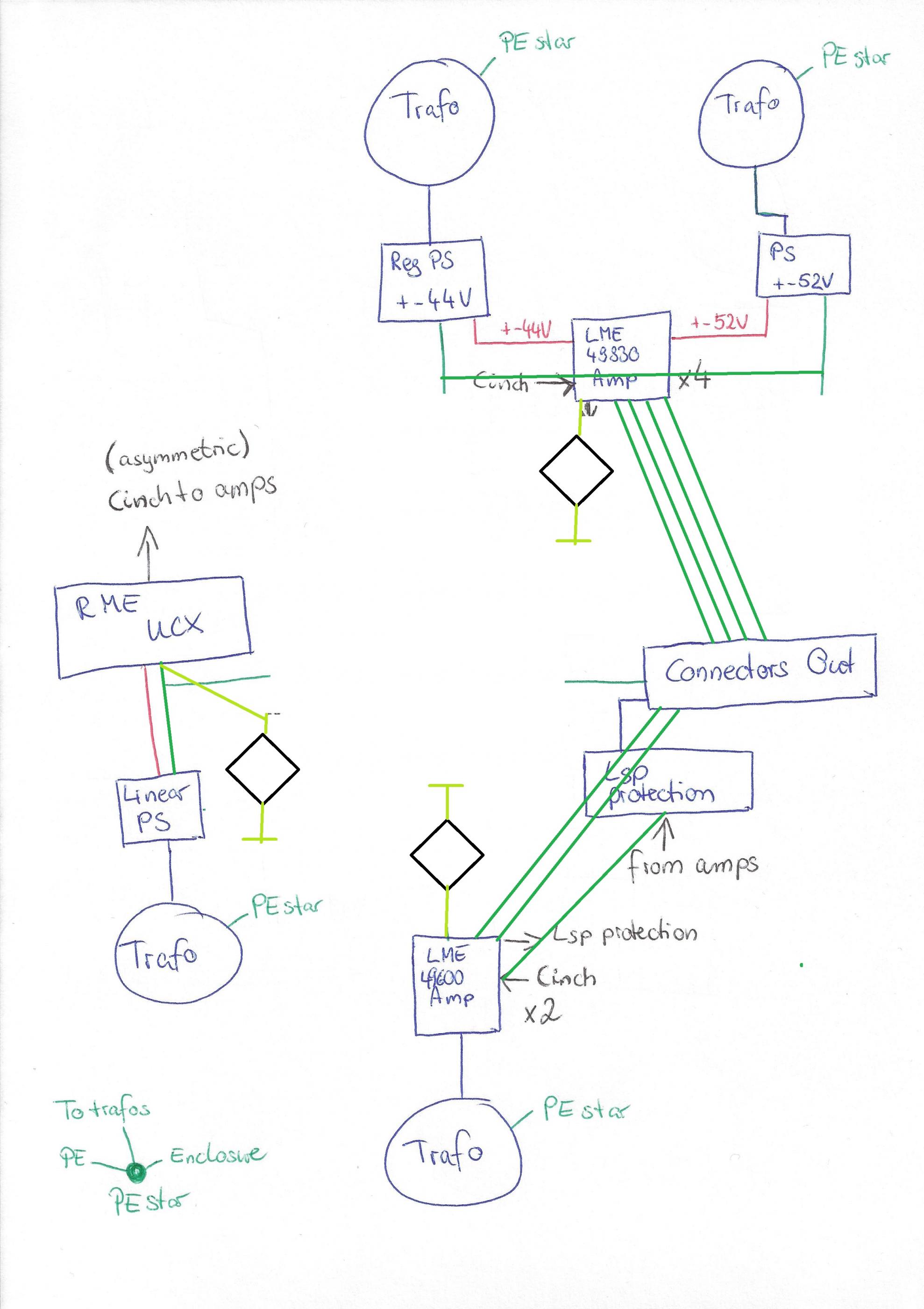

Hi guys,
putting together 6 amps (active concept, 4x LME49830 and 2x LME49610, both from OPC, all asymmetric) I realized, that I get some hum from the speakers, when I connect the amps to the RME UCX.
Every amp is deadly silent, when unconnected, but connecting more then two amps together (to the UCX) it begins to hum.
Grounding is realized with a GND-star, so that all components are strictly connected together at one place (including amp-out)
I tried several combinations with grounding the UCX, disconnecting the Cinch-gnd, connecting resistors and capacitors, but had no solution yet.
My first issue is: Is there a recommended combination of connecting all components to the GND-star? Now I have following:

The limitation is, that all power supplis are on the lower level, all amps are on the upper level of the enclosure.
My second issue is, that the 49830-amps are connected to the gnd-star with one wire, speaker-cables are also wired to the star. Does the amps have a problem, when the (speakers-) gnd-reference is connected to the star, and not directly to the amp?
Ground-cables are thick and soldered, should reflect in less resistance than Cinch-to-UCX in any case. Another grounding cable from the UCX directly to the gnd-star has no influence to hum.

Some photos and a system schematic showing amps, PSU and inputs will make it easier to help you. Your problem is called ground loops. There are a few things that you can do to reduce the hum.

Here we go...
The ground loop breaker didn't help btw. Hum got really loud!
I would have to disconnect the gnd within the UCX if I wanted to break the loop :\

Add safety earth connections to your drawing.

In my humble opinion I think connecting the gnd of five different power supplies on a single point to speak of star wiring is not at all good for mass loops. Take the case of a dual mono and you will see that the gnds of the power supplies are not brought to a point. Another point, the only connection that should be connected to the box is the earth connection (no ground).
Begin feeding your amplifier stages as it should and forget about your center ground point.
You should be thinking about something like this. Where possible keep the grounds per PSU separate. Use a ground loop breaker for each PSU.

Disconnecting PE does make a difference, because PE can save lives. A bit of hum will be irrelevant if you or someone else gets electrocuted. But I guess that was not your point.
It's weird that inserting ground loop breakers results in more hum, while disconnecting PE does not change the hum. From your drawing I'd suspect there is at least one loop involving the audio GND + PE, but I do not completely understand your drawing with respect to the GND and PE connections.
Is PE connected to audio GND in any way? Use a Ohm meter to test.
Do the speaker protection modules have a common GND for the different audio channels? This might cause ground loops. Check by removing the protection modules. The protection modules may also have their own power supplies, and have audio GND(s) connected to PE (yet another loop).
Your Cinch connections from UCX to the amps probably have audio GND connections. Add these to your drawing an you'll see ground loops. Do you really need the combined star ground for the UCX and your amps?

PE and GND is NOT connected, multimeter shows infinite resistance. The trafos are connected to PE with their screen winding.
The 6-CH speaker protection module has a separate 12V ps. Both, the ps and the protection module are connected to the gnd-star.
PE is mandatory, but of course I meant it has no influence to the hum.
Yes, objectively speaking the UCX (source) is making a ground loop, but is an interface not always causing a loop? Which connection is to be disconnected? I tried disconnecting the Cinch-gnd on both sides, while using R's, C's, diodes, connecting to the star-gnd etc...
In my 4 channel set up with 2 stereo speaker protection circuits I had to use two separate 12V windings or I had hum. They are not connected to audio ground, the speaker pair pass through the protection circuit only
