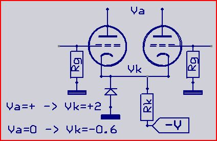

At normal conditions the -Vg is there thanks to the fact that the cathode is at +1...3V above ground,the grid is at 0V.During warm-up and/or without Va the cathode is pulled below ground,causing gridcurrent.Simply put a diode (1N4148)between cathode and ground (anode diode on ground).Now Vgk may go negative but only 0.6V positive.

A diode from the cathodes to ground won't work because the voltage on the cathodes sits at around 1.6V when the HT comes up. (The cathodes are returned to a -15V rail via a BJT current sink that sets the tail current at 12mA). The cathodes sit at around -12V when the grid current is flowing with no HT present.
