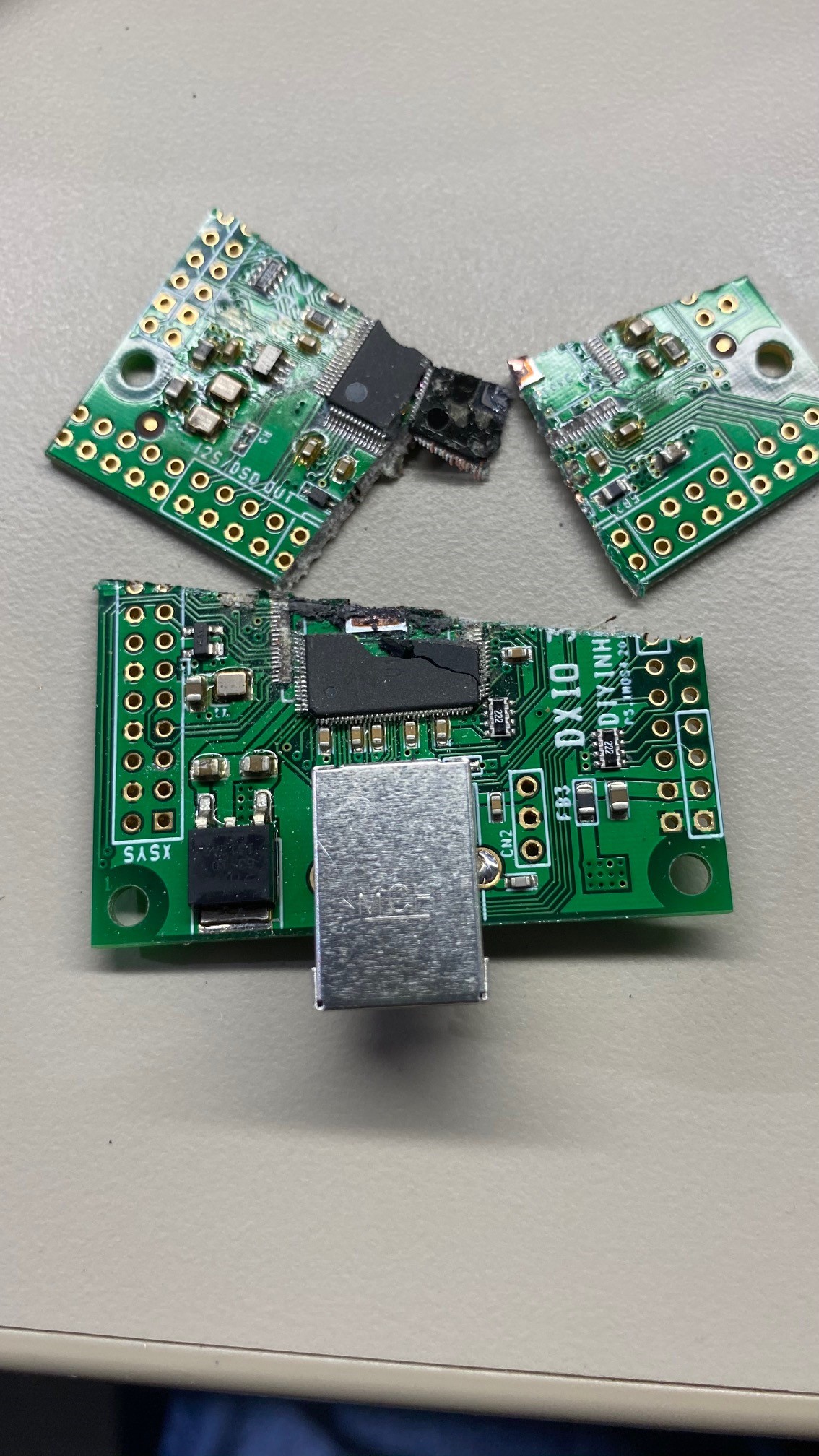

DIYINHK DXIO trouble shooting
The DXIO board failed due to EOS (an ESD event).
The specific item that failed is the 3.3V regulator.
As part of requirements for refund DIYINHK required that I destroy the board. (see photo).
So no more trouble shooting will be possible. I will however install the GMF05C-HSF ESD diode array on USB DP, DN, +5V (attached) and anywhere else I may use XMOS device I/O.
The diodes are rated for 12Amps peak for an ESD event.
