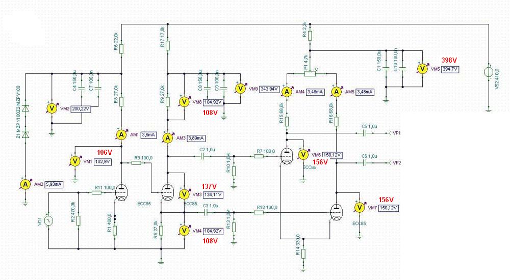

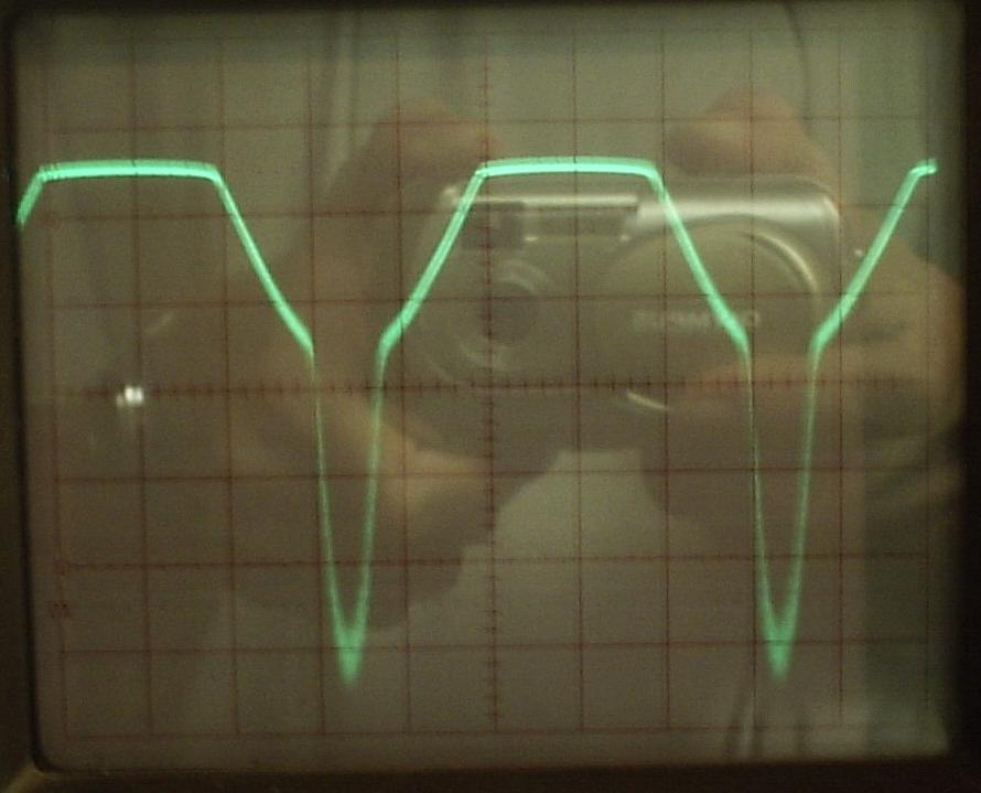

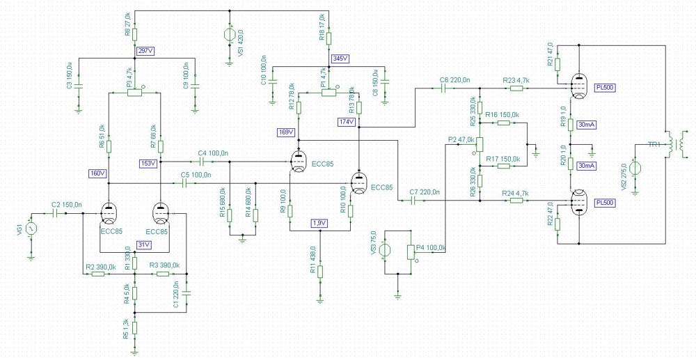

I built a driver for PL500. The schema and the pictures of the cathodine signals is in the attachment. The upper side of cathodine has a big distortion 🙁
I was tried with other tube, but nothing changed.
If I pull out the second ECC85, the two signal is full symmetric.
What's the problem?

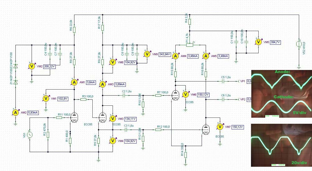

Sorry, I can't measure anything in this circuit, because I built a new one, without a cathodyne 🙂
The new scheme is in the attachment. It seems to be working 🙂
I would be grateful, if you check the operating points, because I'm not sure in.
