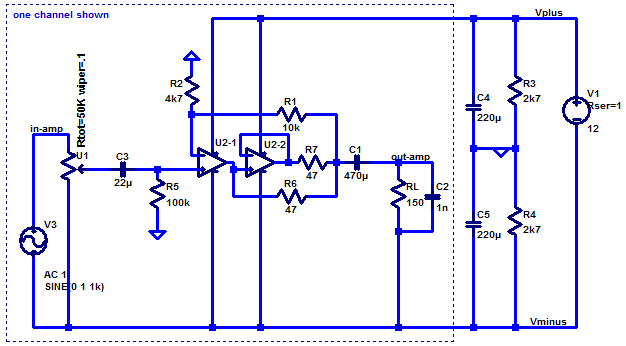

I am not quite sure where the problem with #2 is though. It looks like it's a take on the classic apheared-47 circuit, adapted for single supply with a cMoy-like virtual ground. So my educated guess at the schematic would be something like this:
attachment.php
(Vplus / Vminus = power supply connection, so Vminus is your "real" ground, while the ground symbol is attached to the virtual ground; RL = external load)
(EDIT: Sorry, I forgot the small film cap of ~100 nF, which should go across Vplus-Vminus at U2.)
Which has some issues like bad PSRR but I have no reason to believe that it should not work, unless there were something stupid like a routing mistake or reversed electrolytic caps going on. (With these cheap Chinese kits, you have to be prepared for goofs like that.) Please verify that output jack ground goes to Vminus rather than virtual ground. It is easy to misroute when the layout software is a fancified drawing program with no physical checks like EAGLE.

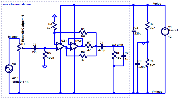

Incidentally, I'd suggest a slight modification to the virtual ground section in order to fix the PSRR problem:
attachment.php
IOW, remove the capacitor that goes from Vplus to virtual ground and reroute its negative leg to Vminus instead.

Using the schematics posted by sgrossklass as a reference, R3, R4 are 2.7K and C4, C5 are 470uF 25v electrolytic caps. The psu is delivering 12.1volts, the voltage between R3 and R4 is 6.07v and the voltage on the grounds of the input and output is also 6.07v @ 4.5ma.
As far as I can tell, the input and output grounds return to the virtual ground between R3 and R4. I have drawn this conclusion because I am seeing a 2.7K load when I test between the input and/or output grounds and V-. Also, when I test between the input/output grounds and the output of R3 (input of R4) there is 0 ohms.
The virtual ground layout looks like the one in the first link posted by sgrossklass with 12.1 volts going to C4 and R3 and 6.07V (from R3) going to the C4-C5 junction and to R4.
I have tried the alternative design where C4 and C5 have separate connections to V-, unfortunately this test didn’t alter anything.
There's your problem.
I can only guess that someone wanted to convert a split supply circuit to single supply (else why would there be coupling caps?) but simply forgot rerouting input and output ground. Maybe they did eventually notice but not until the boards had already been made. So what do you do? Oh well, just dump 'em on eBay. That's cheap Chinese kits for ya...
Better do this later, ideally with a noisy power supply so you can appreciate the difference.
So, would diverting the input and output grounds to V- cause any problems?
Not if you do it correctly (obey star grounding and all).
