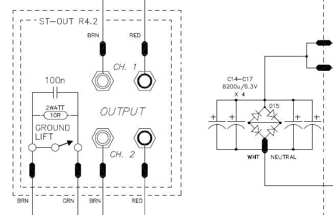

you need to rearrange connection between audio gnd and safety gnd on one F5
instead of NTC use either pair of anti-parallel connected diodes , or include switch in-line with NTC
that last solution use with care - only when amp is connected with other equipment , which already have that safety link
observe existence of "ground lift" switch on many professional gadgets ; same reason

Ok. Though I do not understand this completely, I get the gist. We are basically trying to eliminate multiple loops of earth from source tom the amp i guess.
Will try what you guys are suggesting and report back, though I hate to open a completed & tested F5 and mess around. May be I should add the earth lift switch.
Cheers.
Glad to give same back
Yes you quite right about the eliminate loops.
Small differencies in potential cause same of the electrons to go shopping in the wrong places.
No need to open the case if you Just cut the cables screens to start.

The ground lifting switch will be safer located in parallel with the Disconnecting Network.
Closing the "lifting" switch shorts out the Disconnecting Network and directly connects Safety Earth to Audio Ground with just a few milli-ohms of cable and switch resistance. Able to pass Fault Current.
Opening the "lifting" switch puts the Disconnecting Network in circuit and now Fault Current must pass the inverse parallel diodes. I have proved to my self and reported that this can be done safely.
When there is no Fault Current the Disconnecting Network has a choice of 10r // 10nF // lifting switch // inverse parallel diodes // Thermistor for parasitic currents to pass to Safety Earth.
I cannot recommend and will actively champion against ever fitting a lifting switch in series with the Safety Earth to Audio Ground connection.
This wiring option is potentially FATAL
Safety earth should ALWAYS be bonded directly to any exposed conductive parts of an enclosure, this is not an option. Technical earth from circuits or cables can be isolated from safety earth via various decoupling networks if required, but if these have the potential to go live with high voltage, such as from a valve amp or powerful power amp, they must also be isolated from touch, using something like a Speakon connector where exposed to the outside world.
I don't care what your PA or other style of amplifiers have done.
What you propose is dangerous.

for instance - Bryston ( almost properly) made GND lift switch
it's on left side ; on right side is DC blocker circ , implemented in amp
