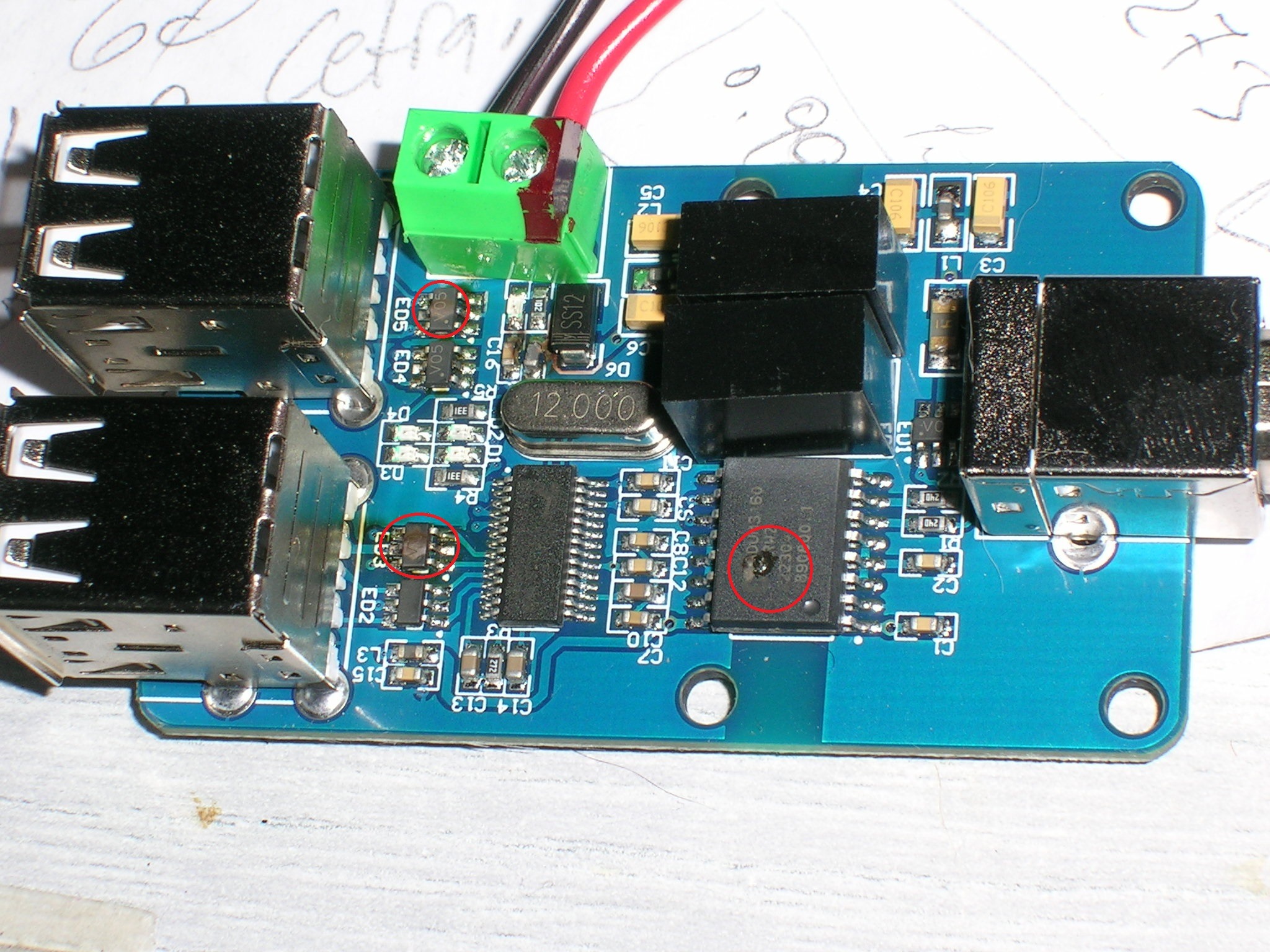

I purchased from ebay a USB isolator hub naked unit
https://www.ebay.com/sch/i.html?_fr...570.l1313&_nkw=usb+isolator+quad+hub&_sacat=0
With no external power connected to it, the host PC did not see the USB to I2S device connected downstream of the USB isolator hub (which it was detected and functional when the isolator was not in between).
Therefore I connected an external 5Vdc source to the isolator (voltage and polarity tested) to see if the unit will function properly.
Well, immediately, light, smoke and smell came out from behind the USB-out area of the isolator PCB.
Post-mortem inspection revealed two ‘V05’ ICs (ED3, ED5 on the PCB, which are protection diode arrays) as well as the ADUM3160 IC having visible damage (surface bulging).
I can take the chance for buying a-non functional unit from ebay from time to time, but the really bad news here is that, what happened with this 15.754Euro useless USB isolator, took with it the downstream USB to I2S device (Amanero clone) costing 29.51Euro.
So, this comes as a warning.
If anyone has some similar or different experience with these units, I would like to know.

Very sorry to hear of your double misfortune here George.
The hub-isolator already has two DC/DC converters on it (those black boxes next to the ADuM chip) so I'm wondering if the unit has a way to disable those when applying external power.
Doesn't amanero require USB2? The isolator linked to doesn't actually support anything over USB1.1 (12MHz) even though it claims compatibility it isn't.. Plug it into a USB2 socket and the USB port will run in USB1.1 mode and devices requiring higher speeds will not work. I haven't tried hard but I've never found an affordable isolator that supports UAC2/USB2 audio devices.
Hi Abrax
Unfortunatelly, there is no recognisable way of doing this with that PCB, nor anything in writing (instructions ect).
Hi Kevin
This is probably why the host PC wasn't seing the USB to U2S device.
