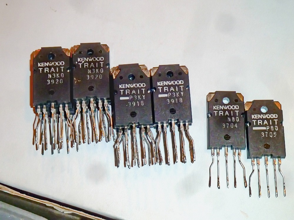

Could these help? Some time ago I got them from a working AVR.
