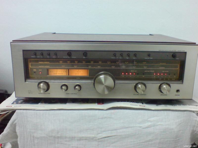

Hi, I've been reading through this forum, but I'm not sure if I have a similar problem. I was able to grab my dad's old 1050 before he tossed it because it wasn't outputting any sound anymore. I did a little research and decided to replace all of the fuses on the amplification board and Bam! it's alive! however, I can not get any audio to come out of the left channel. I have tried both the A and B outputs, and my headphones, and no audio comes out of the left channel for any of those outputs. The left channel LEDs on the front also don't light up, but the right channel LEDs do.
I'm a novice when it comes to audio equipment repair, but I do have some basic electronics and soldering knowledge. Does anyone have any suggestions as to what could be wrong here?
Thanks.
