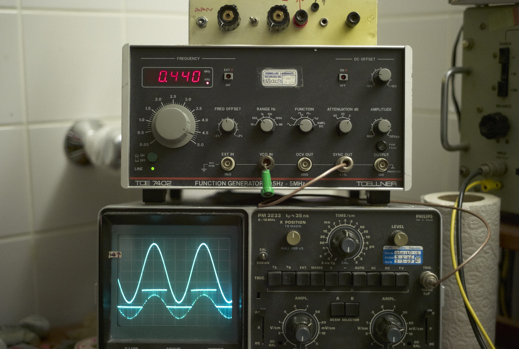

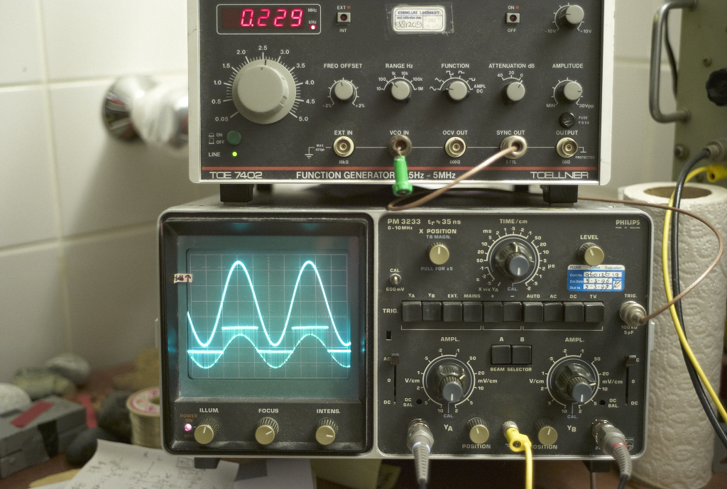

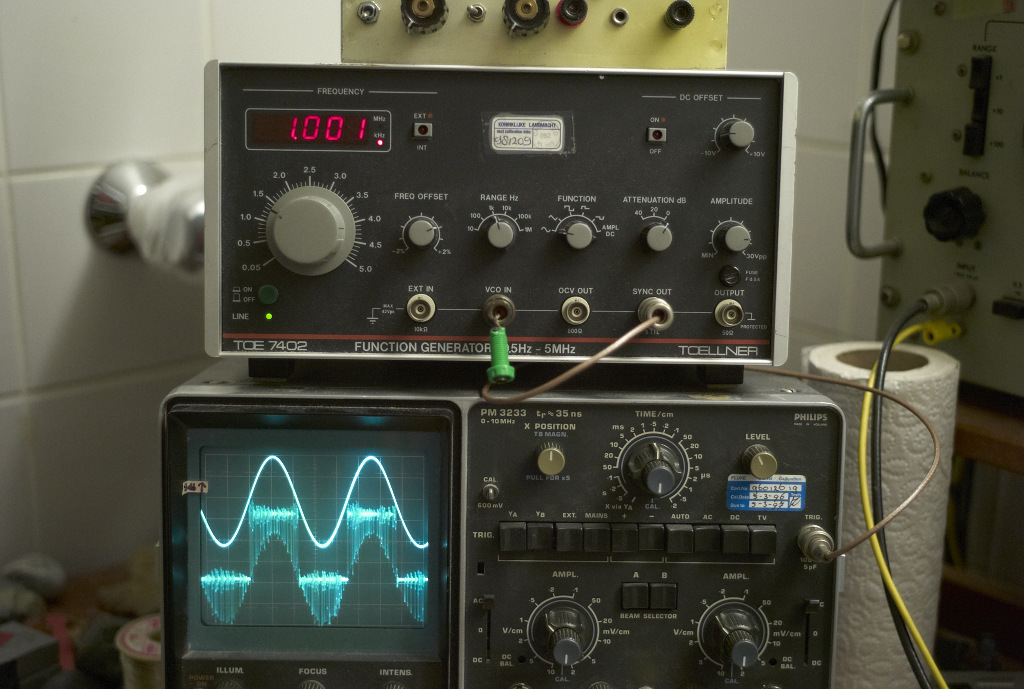

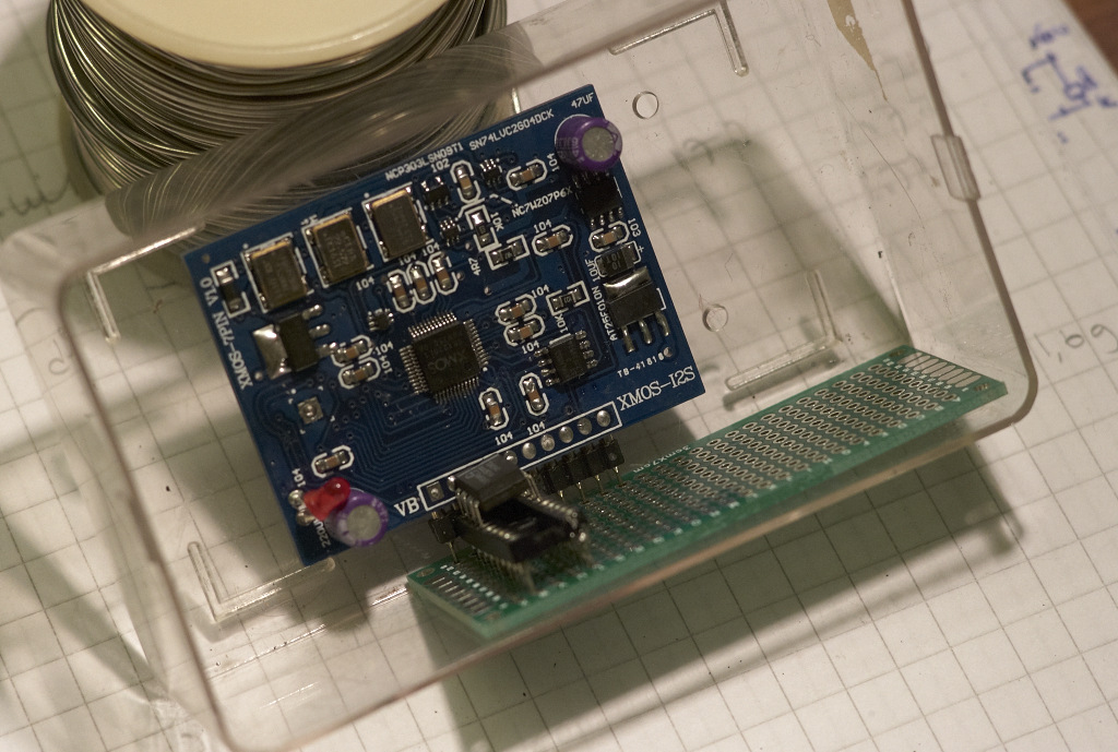

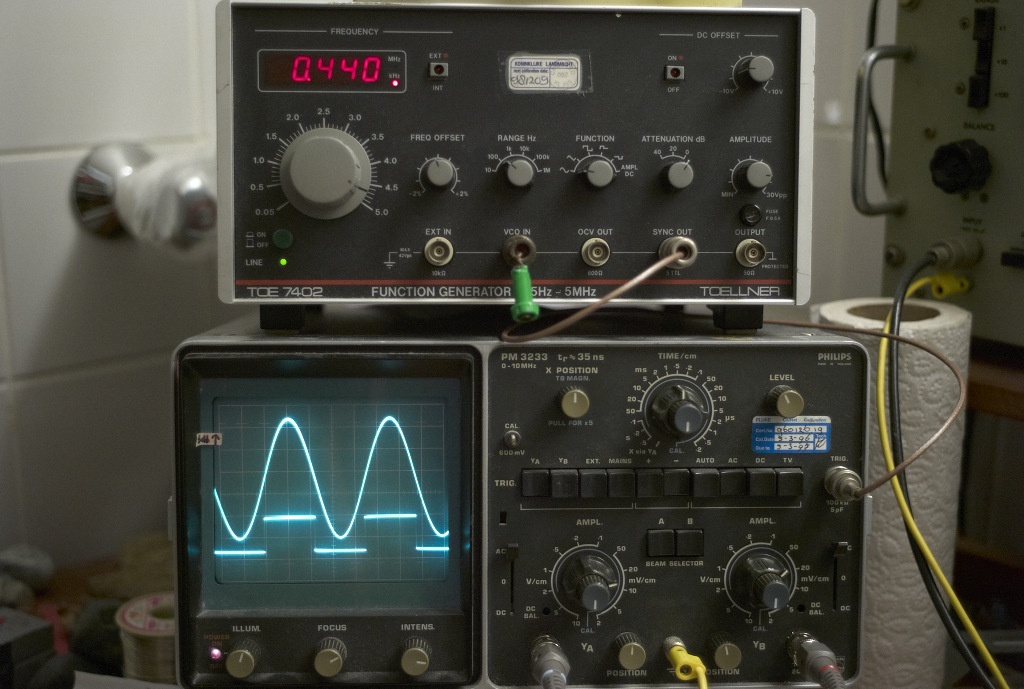

I bought a Weilang XMOS card - 10 pins version that outputs I2S - to integrate is a TDA1543 DAC.
But I have some serious problems. The left channel is up and running, but the right is a square wave at best or a noisy popping signal.
  • Strange enough the output distortion differs per chip - I tested various chips on the DAC boards.
I attached XMOS card to DAC as follows:
pin 9, BCK --> pin 1 BCK input;
pin 8 DATA --> pin 3 DTA input
pin 7 LRCK --> pin 2 WS input​
No attennuators.

here are some funny pictures and these are not intended as art . 🙁
Nijntje TDA1543-XMOS 62 L1020683.jpg Nijntje TDA1543-XMOS 63 L1020684.jpg Nijntje TDA1543-XMOS 64 L1020685.jpg

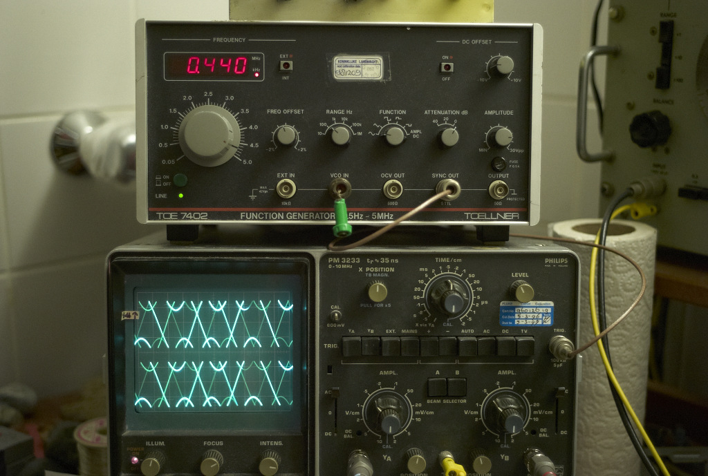

while this the result for these same chips to the CD player:
