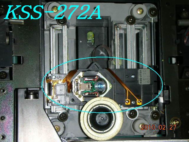

Are you one of the few lucky user's, where not that the laser unit has to be replaced - probably by only a few hours of use while the whole lifetime.
In most cases the laser diode SLD 104 is muddy, so must the entire laser unit "KSS-272A" to be replaced.
Currently here which are offered:
KSS-272A ²ð»ú¼¤¹âÍ· KSS-272A ͳ»õ¼¤¹âÍ· KSS-272A ²ð»ú¼¤¹â¶þ¼«¹Ü KSS-272AÏÂÏß¼¤¹âÍ·
Please note - the optical pick up's from Sony's KSS-Series are the ones with the shortest life time of all exist models, independend of the price class. I. e. - the life time of a KSS-272A isn't longer than that one of a KSS-210A or KSS-213C.
Check out this threads in this case
