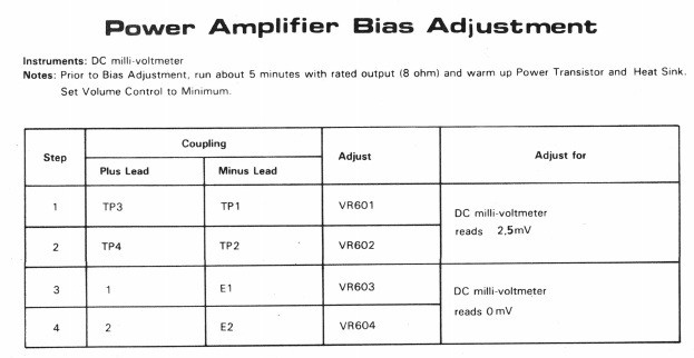

Start off with checking bias?
Best regards
Hans
Rotel Advice 2.5mV, giving Iq of about 11.4mA per output tranistor.
Set up as they advice, if after setting bias, it still sounds bad,
maybe increase bias abit, see if it changes your listening experience.
Attached picture is to set offset and bias.

Ok - so i'm back again, the check up took a couple of weeks as first my voltmeter, then small tools had misplaced themselves...somehow 🙂
Anyway, the good channel measures ok, allthough idle current was a little high (does it hurt - if the sink is not to hot i suspect it's ok with a little higher idle current??) - dc offset was spot on with almost unmeasurable offset.
The bad sounding channel i could not get below 0,5 volt in offset - and there were NO voltage over the bias measuring points of TP1 and TP2 - closeby resistor R643 (2watt 910 ohm) have been hot i can tell.
Any ideas?

No bias is a bad sign. R643 being hot would indicate either one of the output transistors Q631/Q633 has failed, or the driver Q625 has.
The schematic indicates DC voltages at various nodes in the circuit. It would be helpful to measure these nodes on both the good and bad channels and compare. This should give you an idea of where to look next
