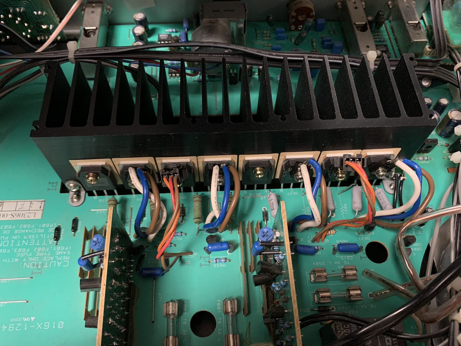

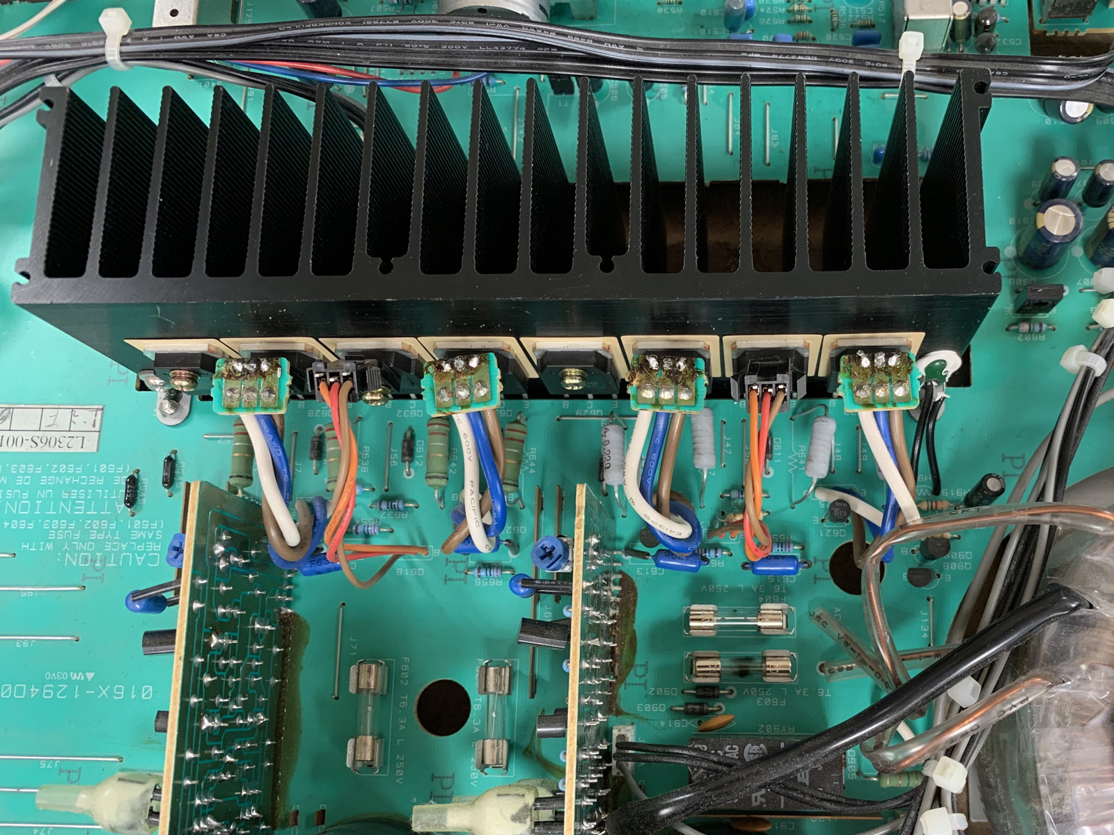

The two separate PCBs, X-1294D03 and X-1294D04, can indeed be pulled off at K1A+K3A and K2A+K4A respectively. I can't find any jumpers on the main board that can disconnect B+/- from the EF’s. Would you still recommend disconnecting the two boards?
You say that worst case I’d need to pull 18 transistors and test them. Are you referring to Q617-634? How do I go about testing them the correct way? I assume I need them off the board in order to test?

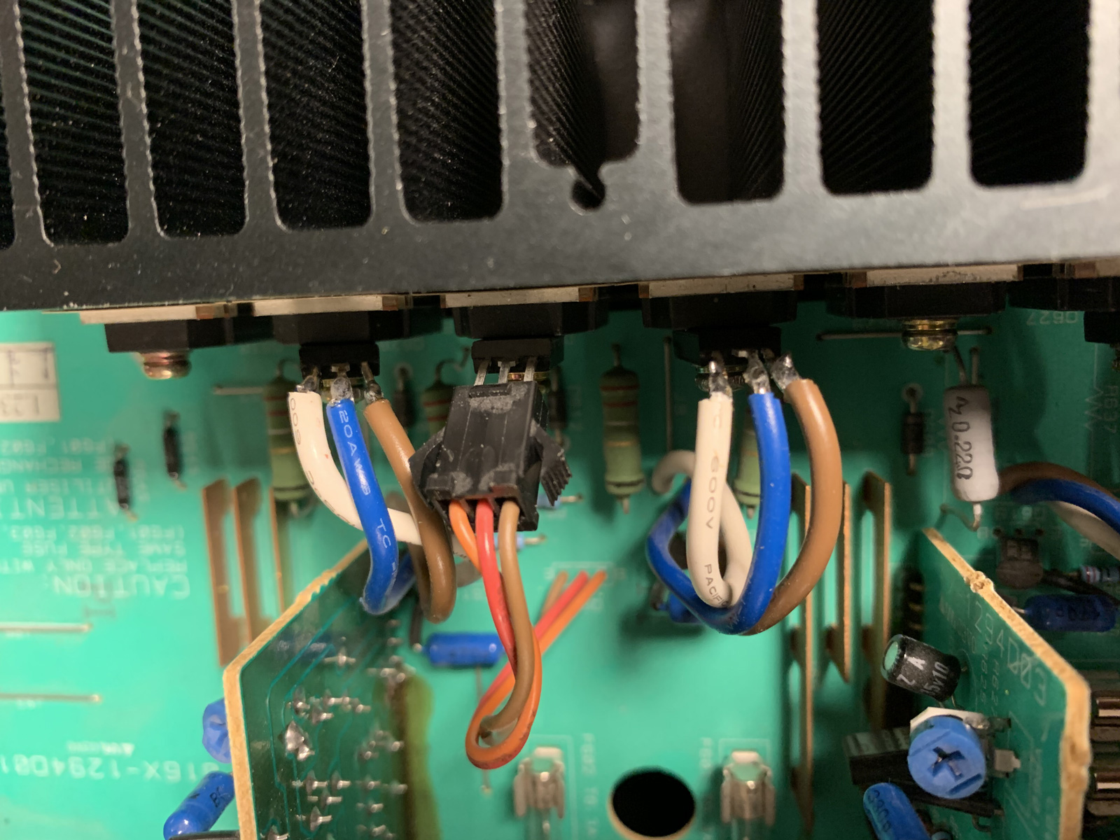

Btw when I corrected the PNP/NPN mistake pointed out by Lojzek, I removed the small prints connecting the four transistors, Q623-626, to the main board. They looked burned/damaged, so I decided to remove them, and then connect the cables directly to the transistors. I guess that’s okay to do?
See attached photos.
Again, thanks a lot for your help!
