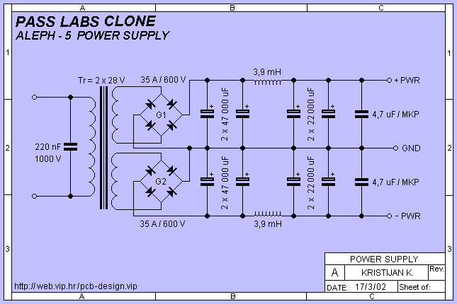

I would like to use pi filter to my Aleph 5 project, what is the suggested inductance (2mh or 5mh ...) and what/ how to calculate the current rating for the choke in amp/ rail (for 2 channel) ??

My Aleph monoblocks are using 2 times 33,000 microfarads for a total of 66,000 microfarads of capacitance for each rail. At full load (3amps per side, 6amps total bias) the ripple on the caps were at 63millivolts. I found some 12 gauge .56 millihenries chokes at a surplus store for a dollar so I thought I would give them a try. With these installed between the caps for a test, the ripple went down to 10 to 11 millivolts. Thats a reduction of about 16db.
I'm in the process of completing my project and have'nt listened to hear if I need them. The measurements were made with resistive loads to test the results. I put two of these chokes in series and the ripple went down to, guess what, half, 5 millivolts. I have left provisions to install them if the noise is objectionable.

You can use the power supply like shown on the enclosed circuit.
It is possible to drive two channels with the one power supply, but if you can, try to use one per each channel.

I don't have the power supply PCB of the Aleph 5 amplifier.
The circuit is very simple and it can be builted without the PCB.
I tried the above circuit, one per channel, with air core coils and without PCB, and there is no any kind of hum, even when you put your ear on the speaker.
Also, you can use the one supply for two channels, but it is much better if you use one per each channel.
Only thing that you must watch out, is the gaugue of the Cu wire on coils, like also Mr.Pass said.

you don't even have to use coils
If coils are not available a 10 Watt 0.22 ohm resistor works pretty
well with a large capacitance supply. It is not just the 120 Hz conponents that are worth reducing. The ripple voltage contains many higher frequency components as well that even an RC filter can significantly reduce.
