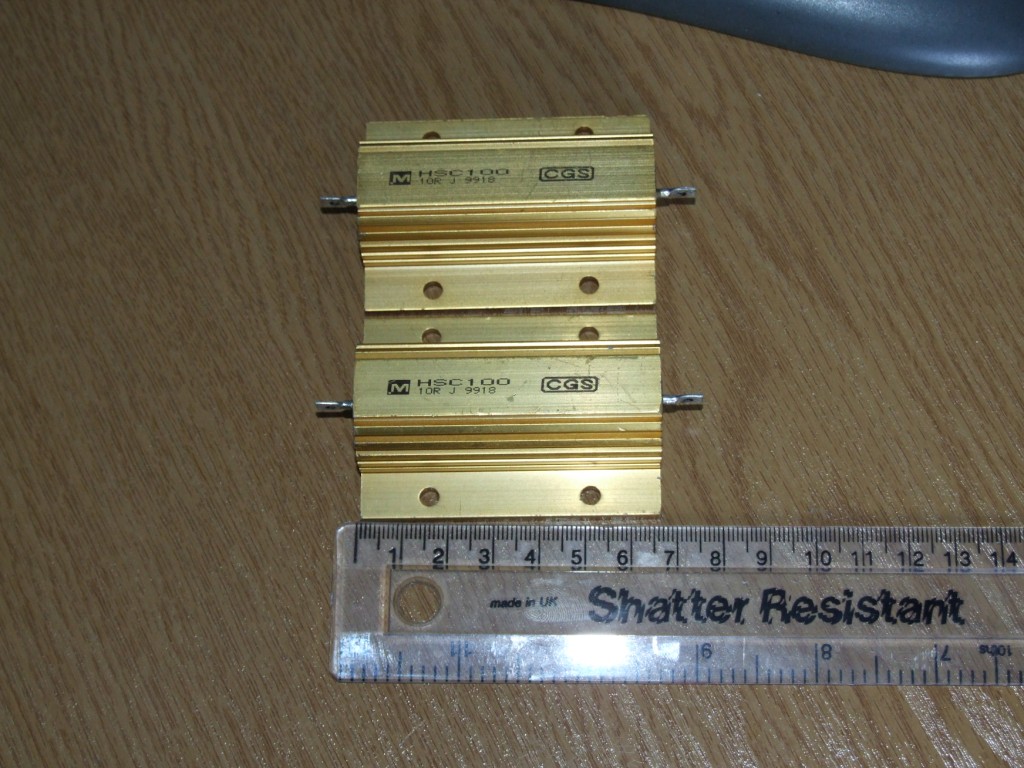

Try using some rather large 10R resistors in place of the fuses during fault condition testing.

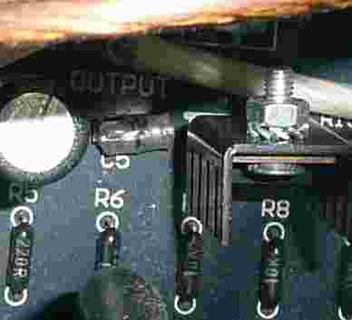

For the 220 uF caps I used Panasonic FC
For the small C8 (10pF) I used this one (styroflex?):

I've got some 300W (yes 300Watt) power resistors just for this purpose - a boxful of various values.
We used them at work to fault find a degaussing fit where the amps were outputting 30A in error.
I'll lend you the 2 x 10R if you want to pay the postage.
Whatever you used is largely immaterial. Something has failed.
Lucas,
exchange those, and for other types.
Polystyrene capacitors should be soldered with extreme care, when the core reaches 85C they're a goner.
Means that 1 of 3 DIY folks who pick these for a project terminate them during the build-up (2nd one was lucky, 3d got wiser after an earlier mishap)
The styroflex cap is sitting right next to the heatsink of the input IRF9610, the 5-finger does 24-25 C/W thermal resistance.
With a T1 dissipation of +1/2W, that makes more than 12C above ambient temperature inside your Aleph 2 case.
With all the wiring around/above it, slim chance of decent air circulation, the heatsink temperature will likely be above 60C.
A foil cap that handles 85C max, placed next to a +60C heatsink, is what you'd call a sitting duck.
Secondly, if your memory fails you on the cap type (styroflex ?), good chance you picked a junker.
9 out of 10 axial polystyrene caps are garbage, only a handfull good axial types were manufactured in the styroflex era, of which most don't even look like half an inch of transparant hose with a silver wire (aka similar appearance as the 'buisjes' used to fix chronic inner ear infections
C8 should either be ceramic or mica, better as a cap and more fail-safe.
In Cheesica you also have the luxury to pick PTFE for peanuts, or polypropylene versions, should be possible to squeeZe in between T1 and C4.
