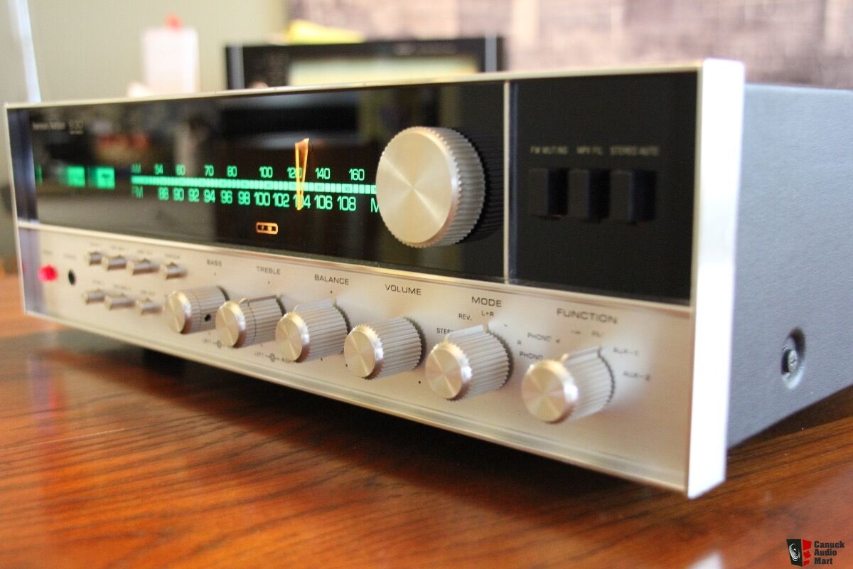

Everytime I turn on/off my vintage Harman Kardon 930 receiver, my woofers on my speakers "pushes out and then gets sucked back in." Almost violently.
I have tried different speakers with the same results.
Does anyone know what likely could be the problem?

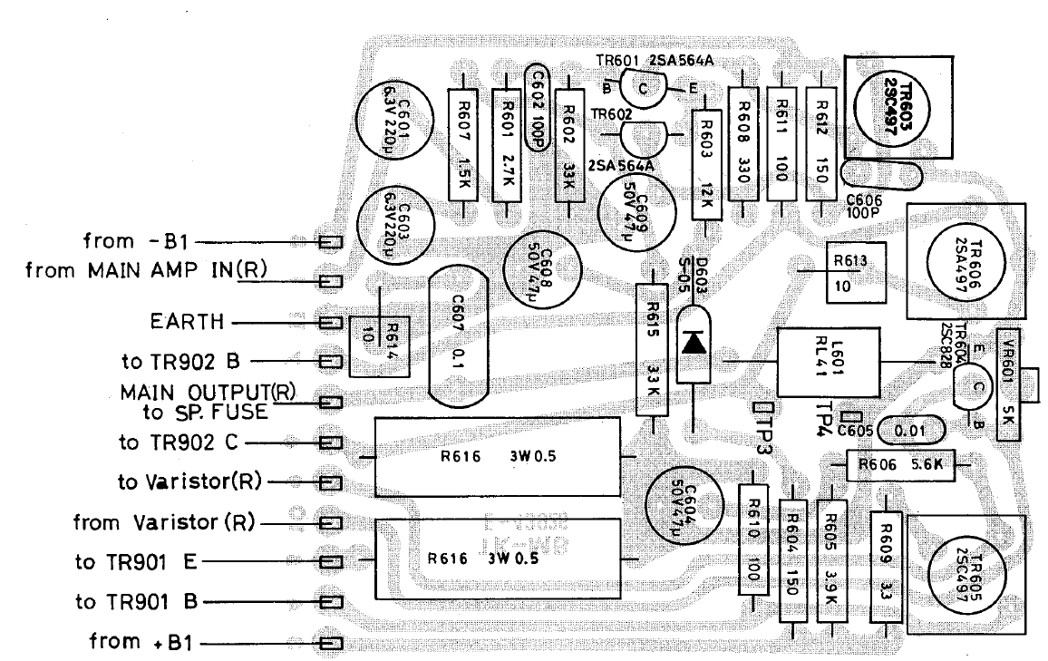

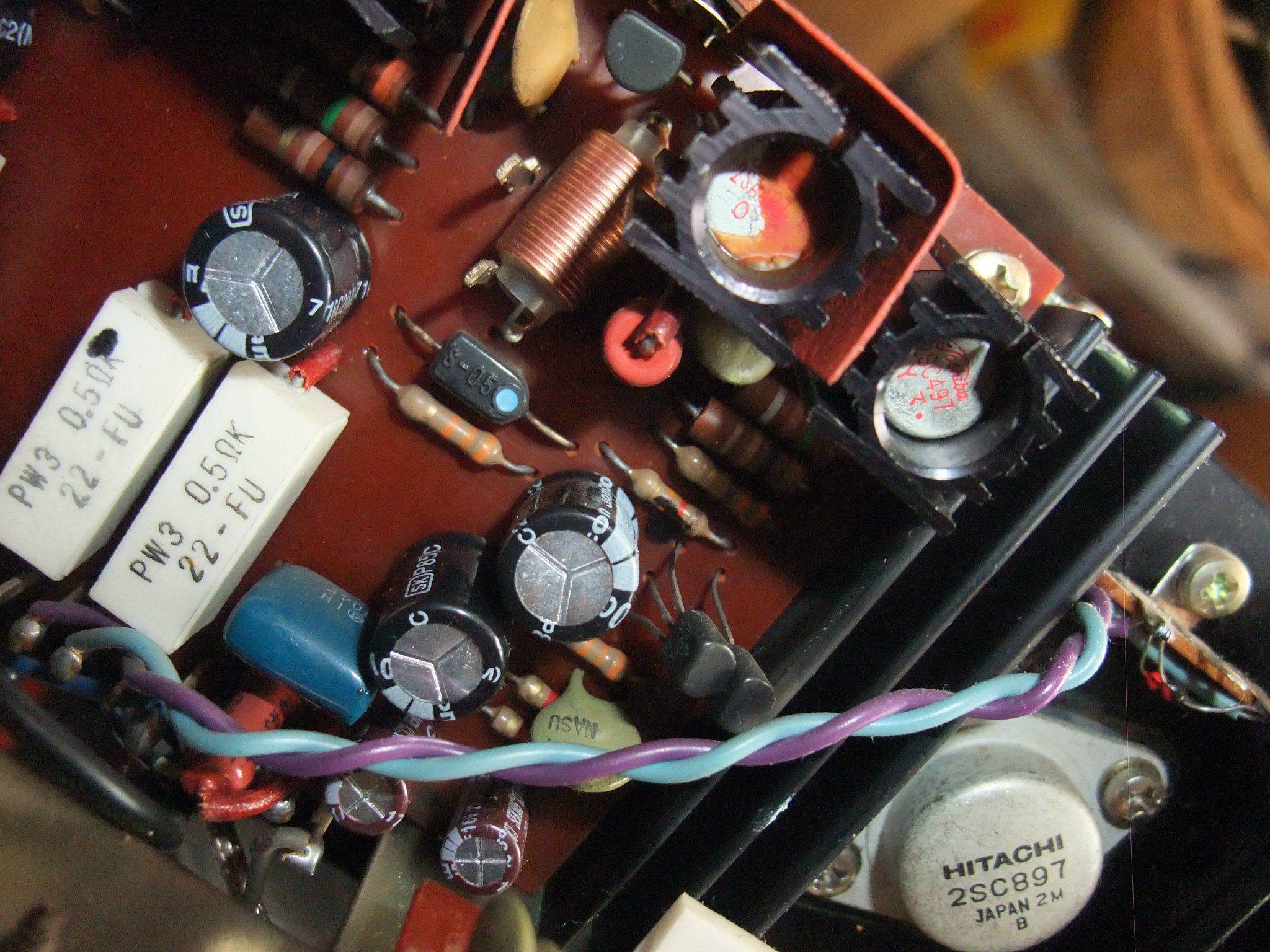

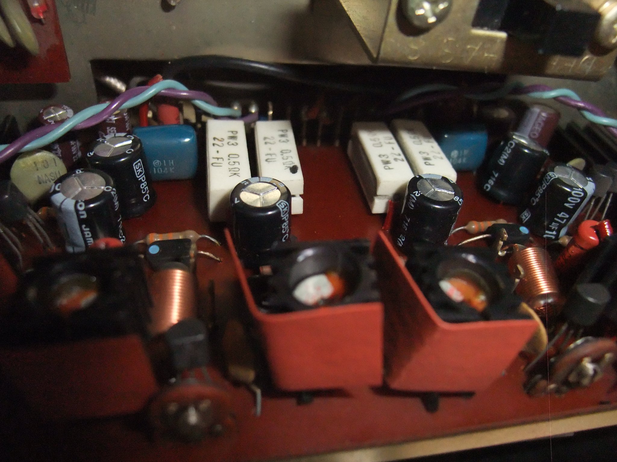

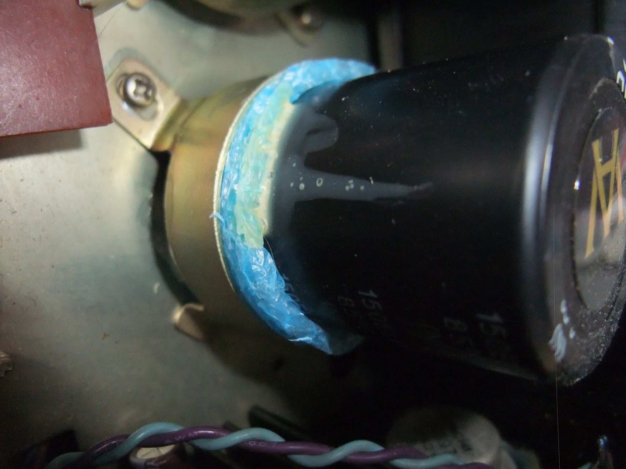

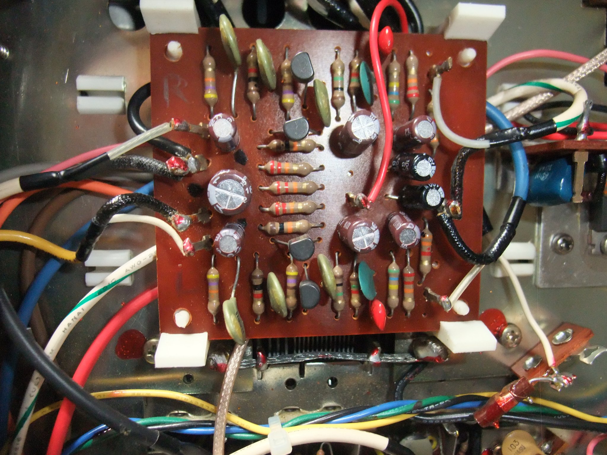

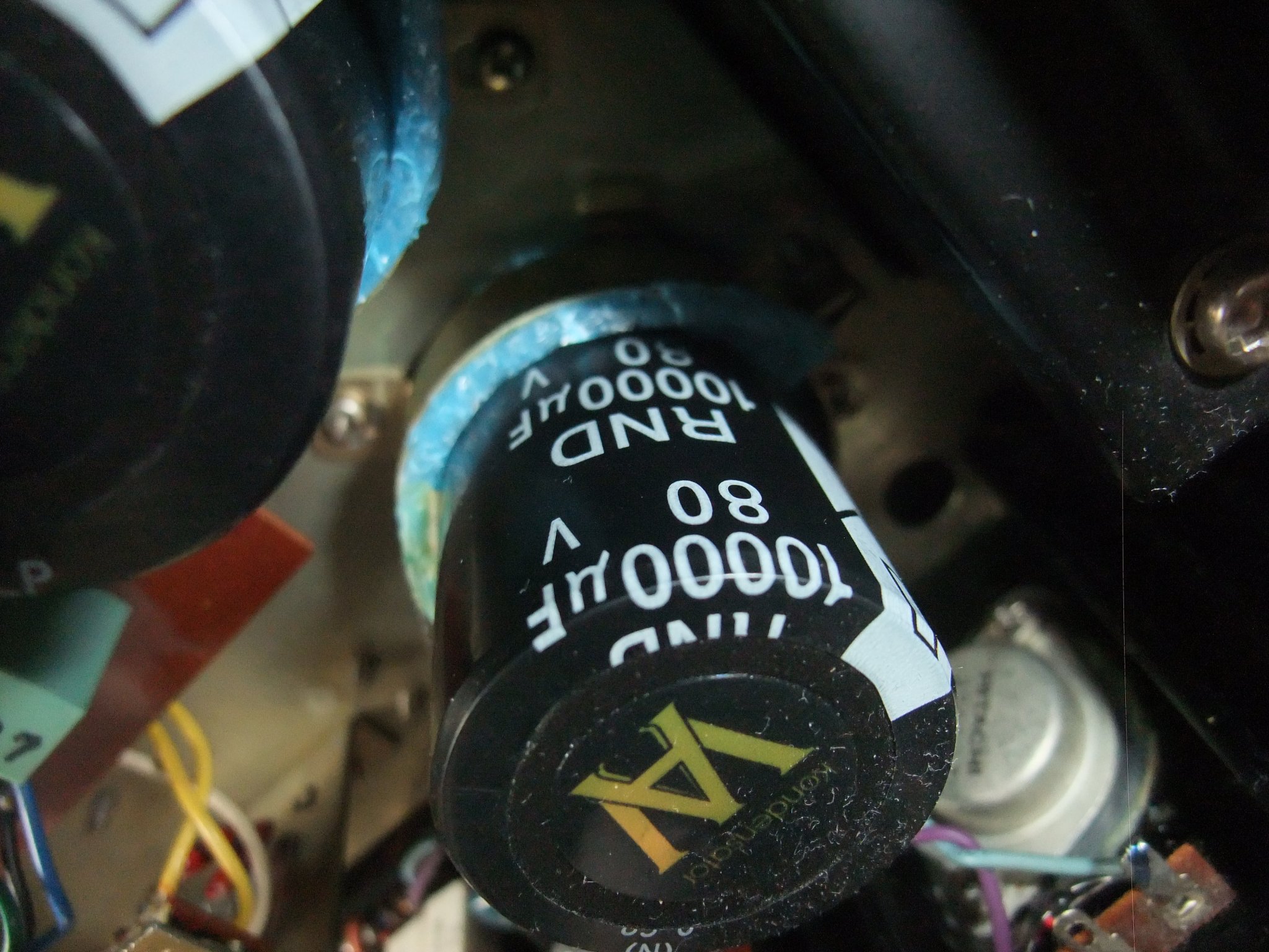

Some of the capacitors in the final power stage dried out. You should replace all of them. Start with C603, 604 (623, 624 on the other channel).
Also the ones in the power supply might be of lowered capacity - replace them too.
Thank you very much. All the capacitors are still original, so that makes perfect sense!

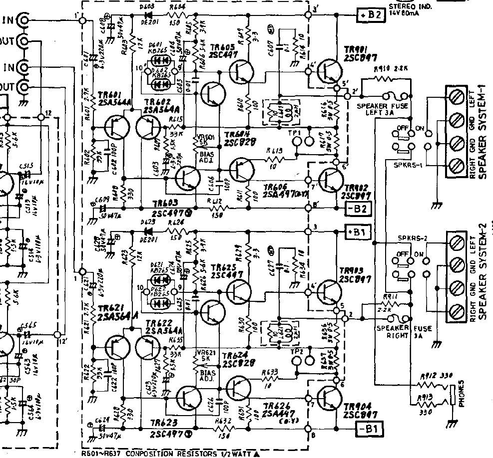

Change all the caps you want it will stilll switch on with a large thump its to do with the vas stage having a resistor and bootstrap There is no way to keep this topology and not then use a relay timer if you want to avoid the thump I used to selll these when they were brand new ! I always instructed my customers to use the spk switches

Altho due to age i'd personally still replace all of the alum electrolytics. All should be cheap except for the filter cans. Those you may want to check and just leave if working good.

In temporal section between "OFF" mode and "ON" mode most of power amp topologies haven't perform steps to prevention popping inside the power amp circuit itself. Therefore a lot of circuits exist to drive a relay together with DC and over-current protect for speaker interrupting. A good known integrated circuit (sip outline) was released from Hitachi, Toshiba and NECEverytime I turn on/off my vintage Harman Kardon 930 receiver, my woofers on my speakers "pushes out and then gets sucked back in." Almost violently.
- Sushimaster
http://www.ic-ts-histo.de/fad/ics/ta7317/ta7317br.htm
But in this model no protect unit with relay is in use. This means, an appropriate modification of the circuit is necessary.
Who know the right steps ?

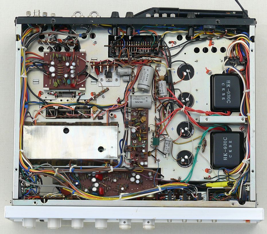

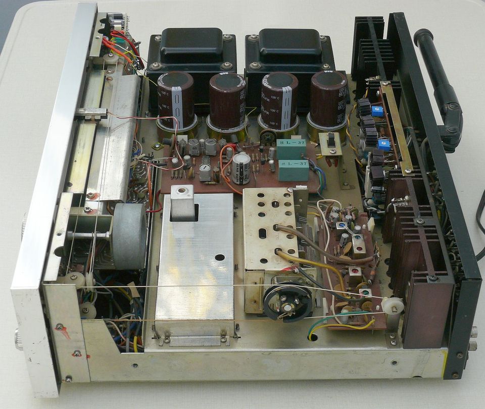

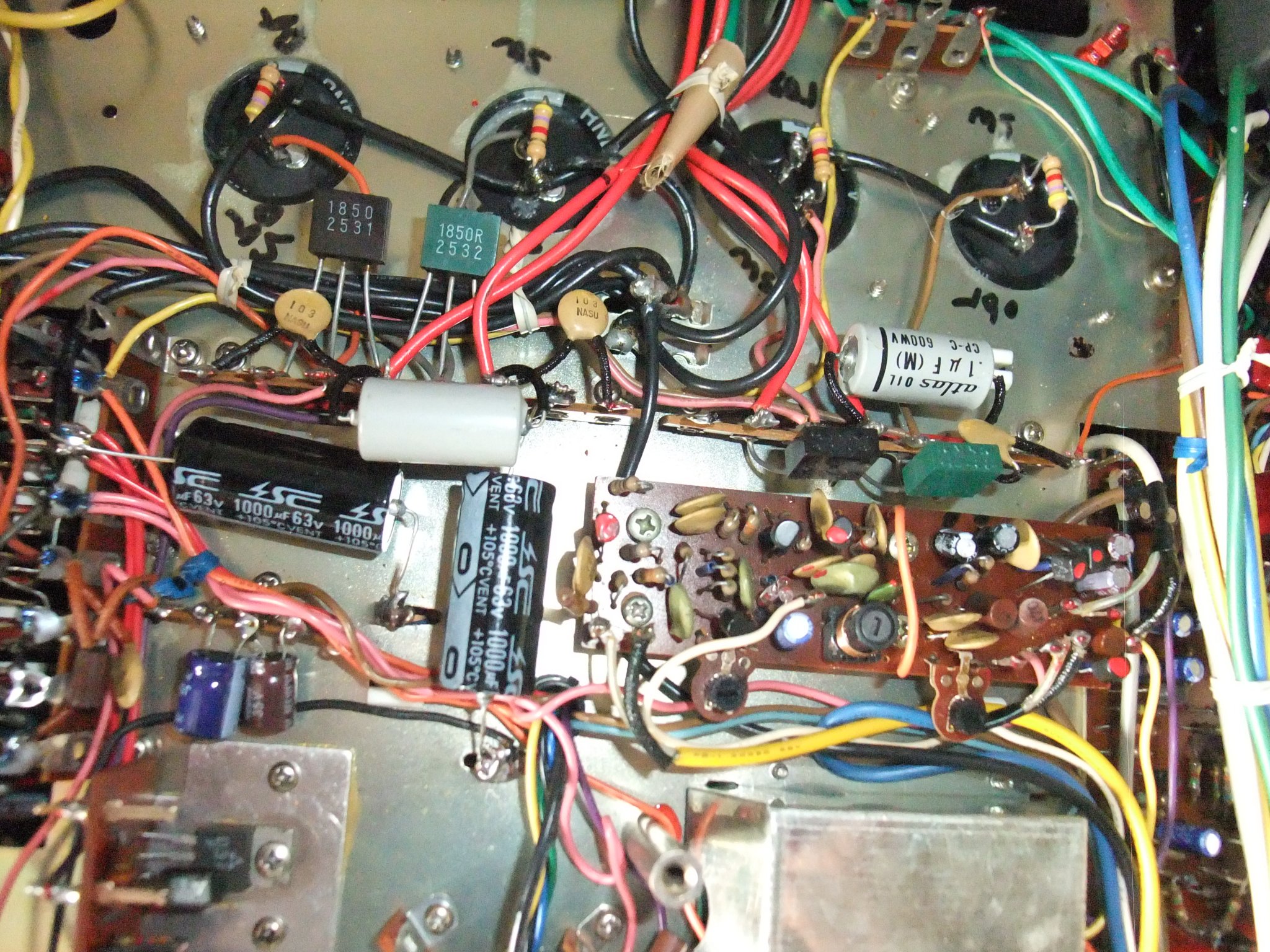

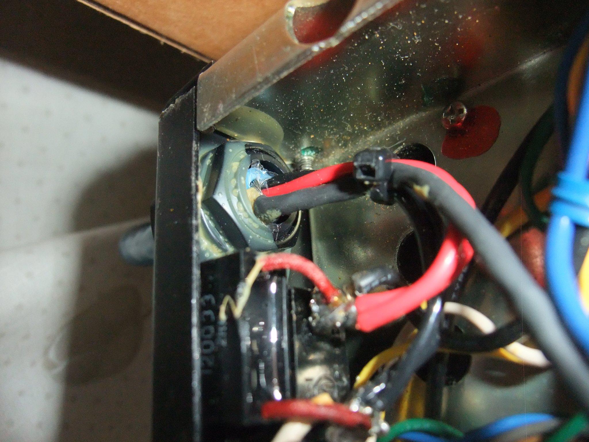

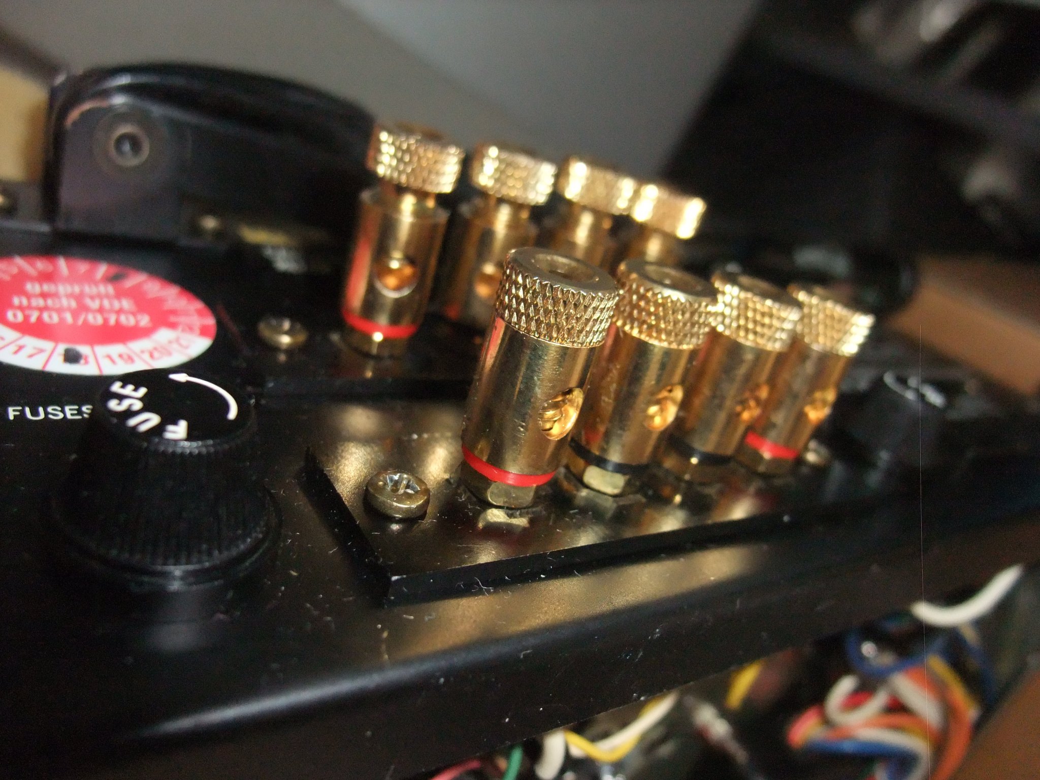

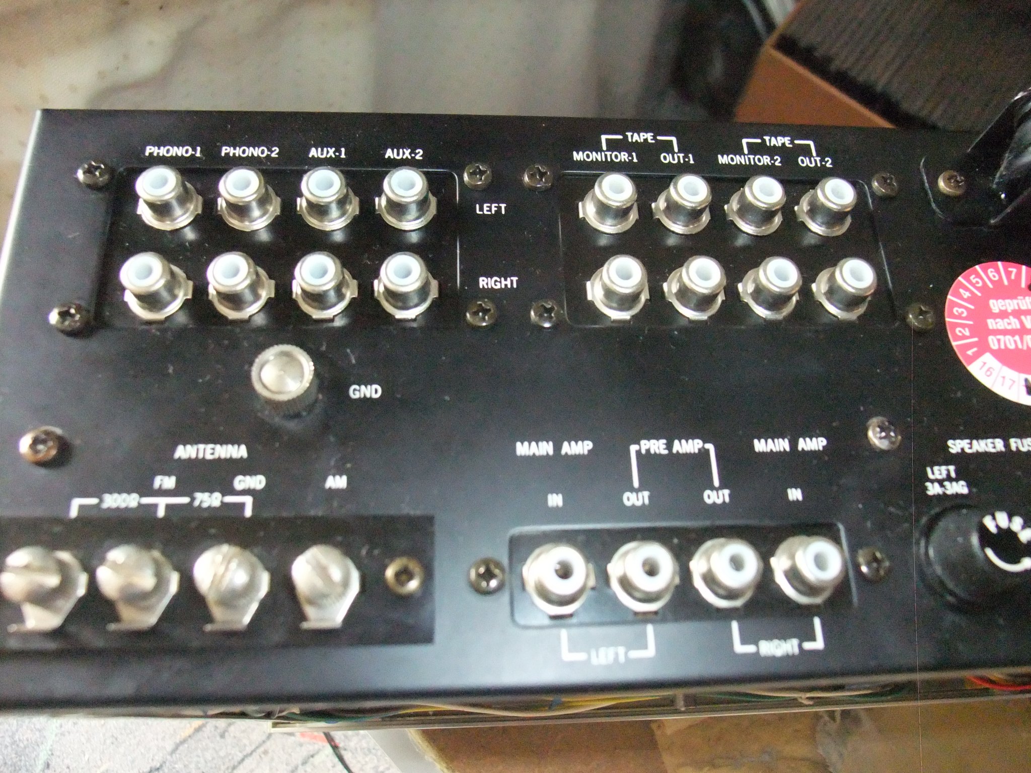

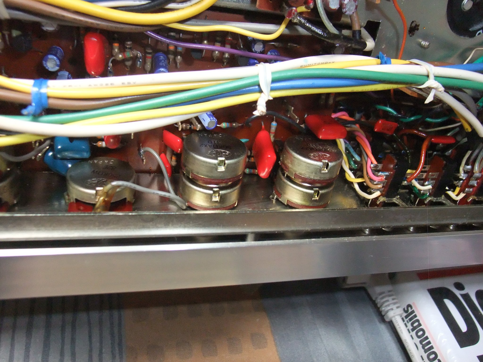

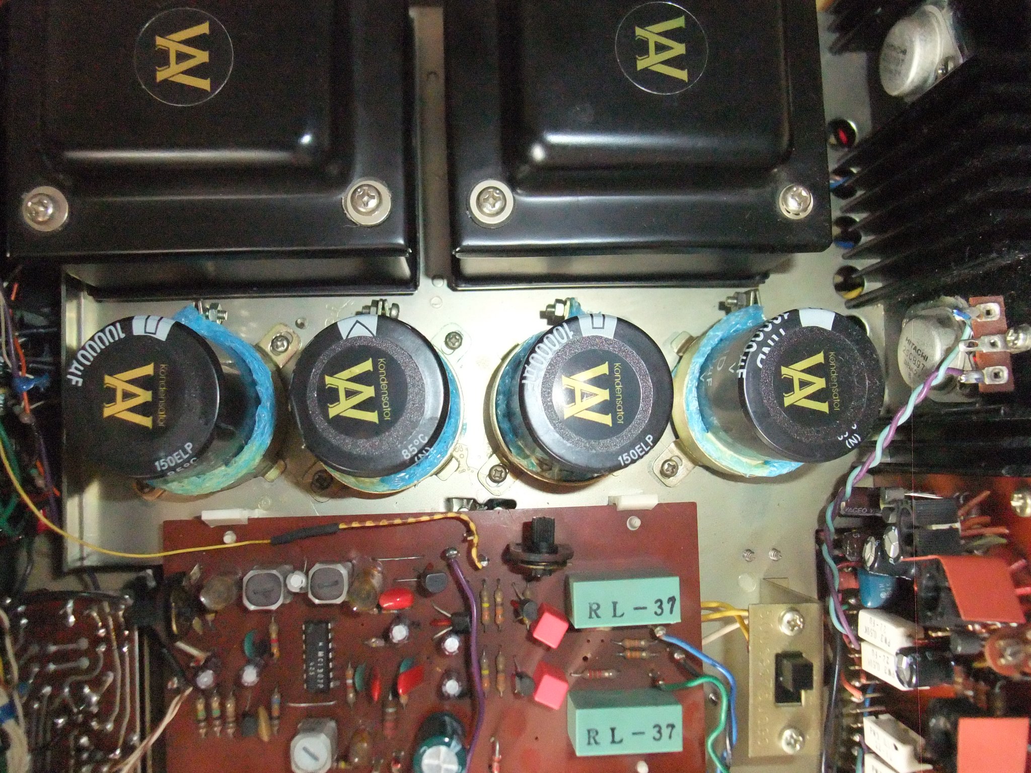

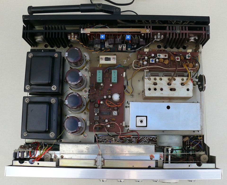

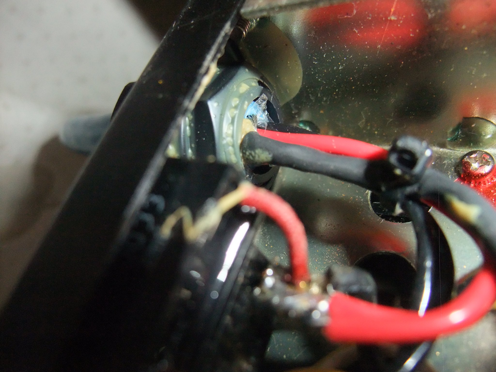

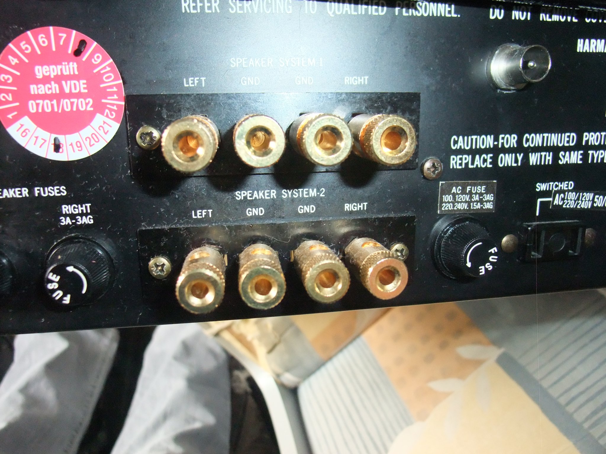

In the attachment several images of this model after modification by a professional company special made for old (vintage) stuff - images in genuine condition under
https://tonbandforum.de/showthread.php?tid=10082
more images from me:

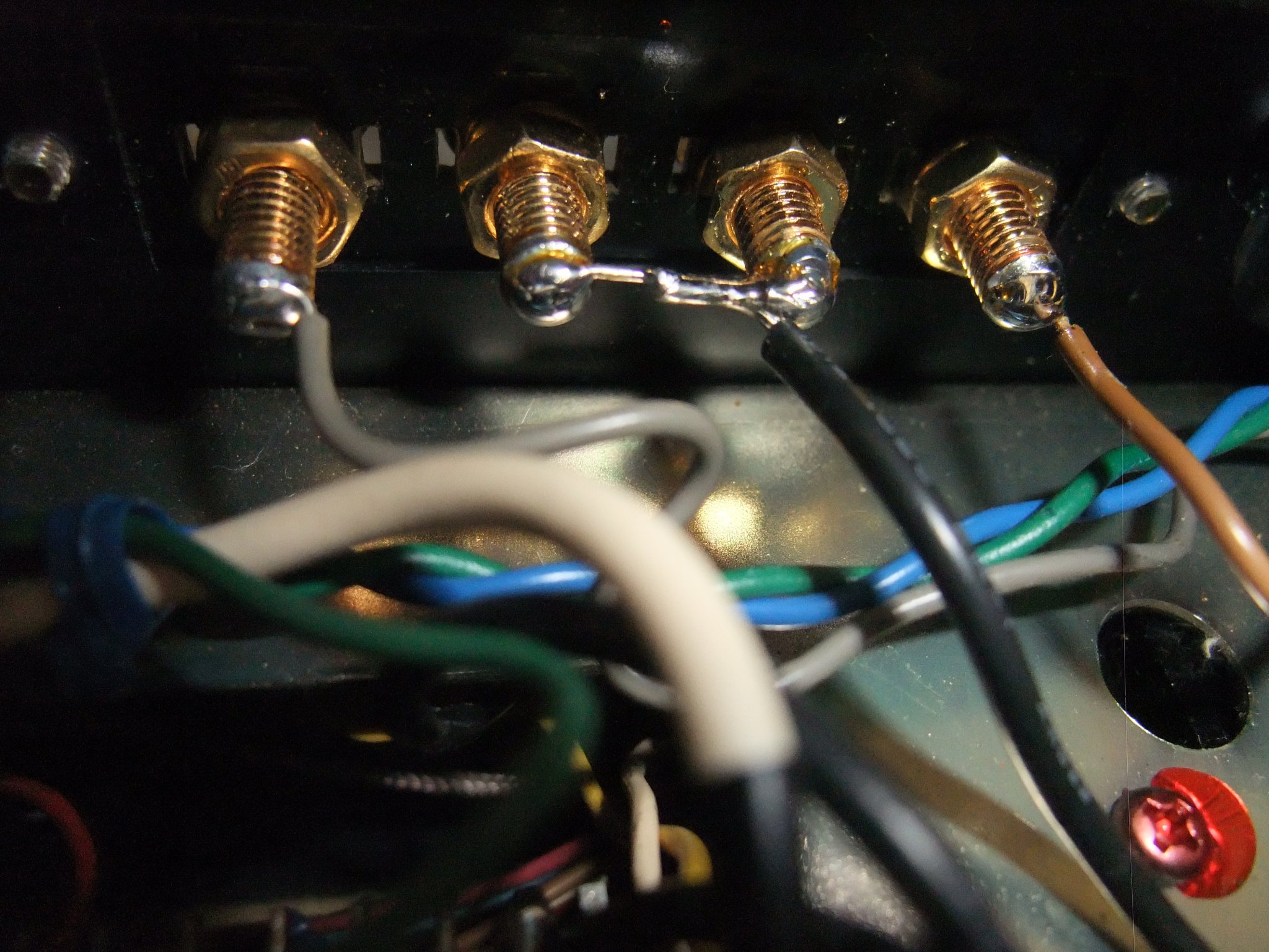

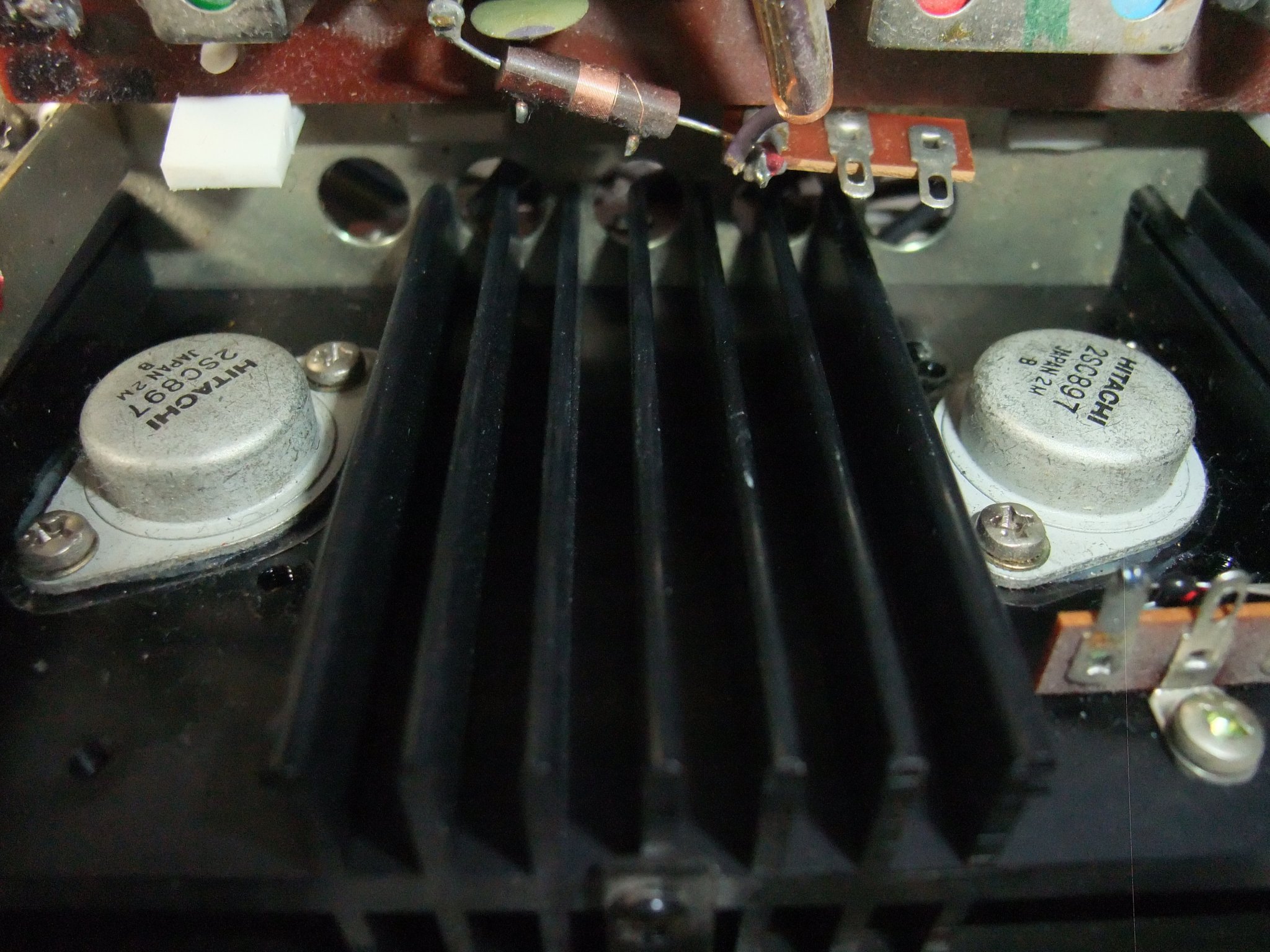

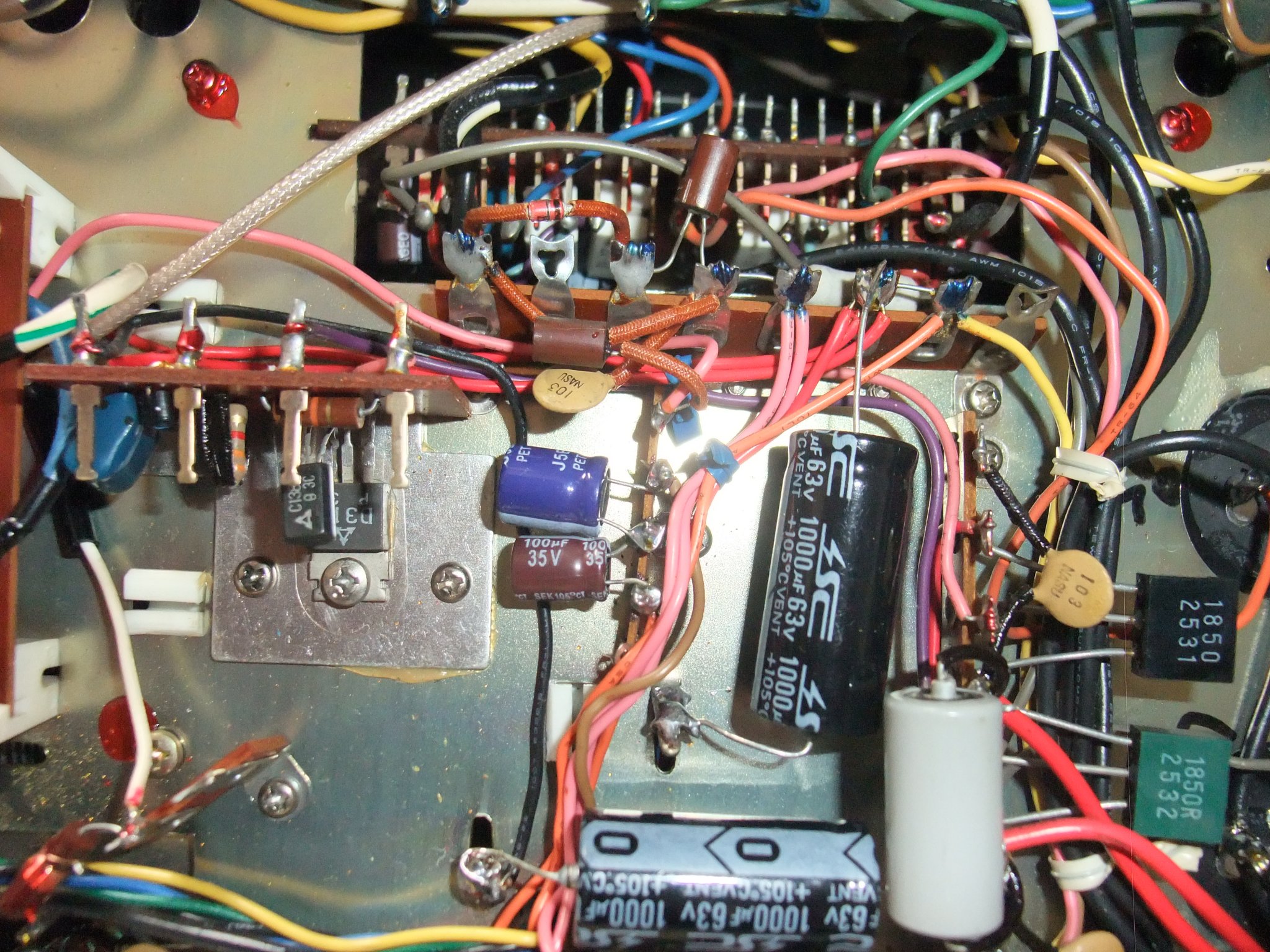

Images from an other device, modified in the similar way
