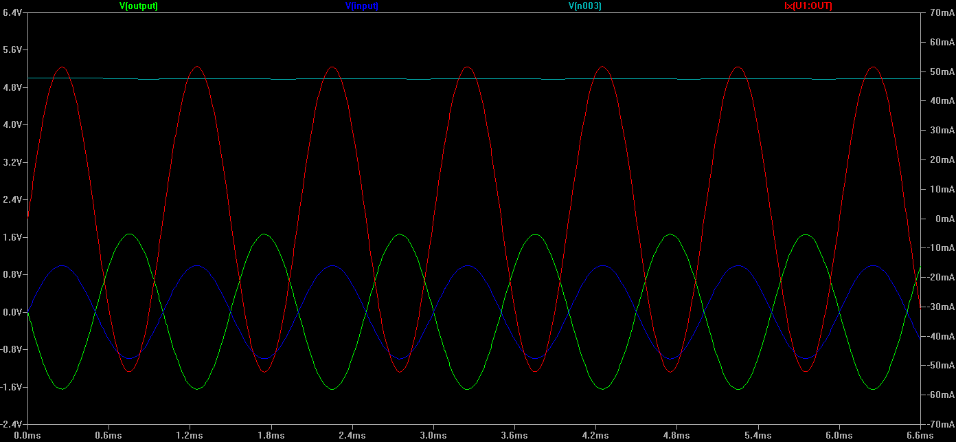

000940's comment about not taking the simulation results too seriously is right on the money. Especially at the extremes of any parameters - power supply voltage in this case. Sounds like that LME49723's output voltage isn't going to get as close to the power rails as the sim results suggest. So instead of getting 0.53Vrms you may only be getting 0.1Vrms or worse.
I would expect better results from chips that are made for 5V, like that AD8656 and the OPA2835 that 00940 found. Both those chips are rated for a maximum of 5.5V so definitely designed for 5V usage. Both chips have minimums around 2.5V - 2.7V so that covers some range of fluctuation on the USB 5V bus.
The NJM4556A might not work well either. Even though the datasheet says +/-2V on the low end of the power supply range it didn't simulate well at all on 5V. But that is another chip that isn't really designed for 5V, it goes all the way to +/-15Vdc.

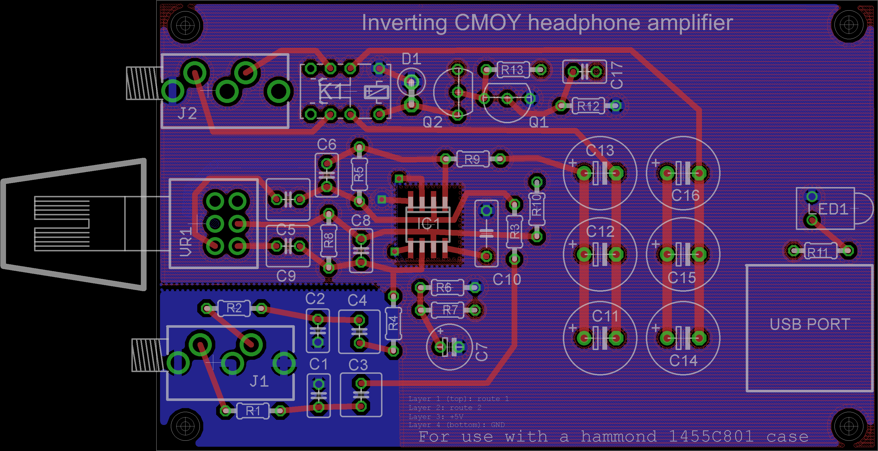

I'm going to send the PC board below out for fabrication and see what happens. 🙂 I've sized it to fit a Hammond 1455C801 case, the same one AMB uses for his mini^3 headamp. I tried to fit things into the smaller 1455D801 but the jacks wind up too close to the pot. Turns out the OPA2835 and AD8656 have exactly the same pinout in exactly the same SOIC8 package, so either should work. If the board works I'll post the Gerbers (for making PC boards).

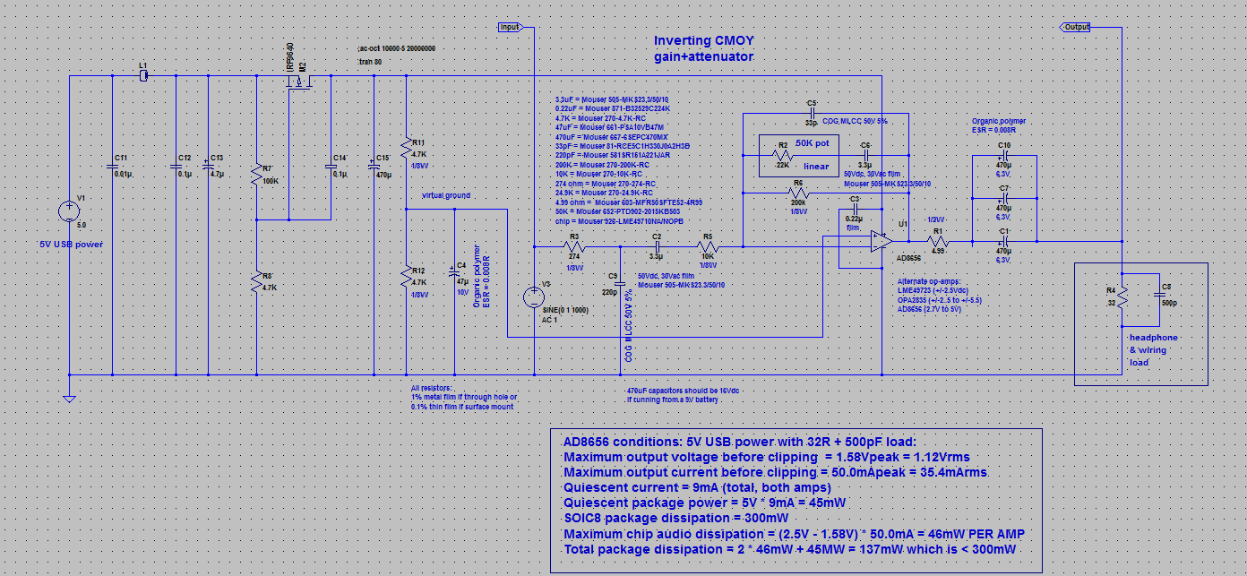

matdogg - something else interesting, after some reading. I had forgotten about the 100mA/500mA high and low current modes on the USB bus, Turns out that until anything plugged into the USB port has had a discussion with the host CPU (enumeration) only 100mA will likely be supplied. You should still be OK at 100mA, since your headphones would draw 25mA peak, times two channels, then a few mA more for chip quiescent current.
But for higher current draws, like 50mA per channel with that AD8656 chip up near the 120dB peak SPL, that 100mA/500mA issue has to be dealt with. I'll take a guess a chip exists out there somewhere that can deal with the 500mA high current "handshake" data exchange with the PC, without having to put a microcontroller on the amp.

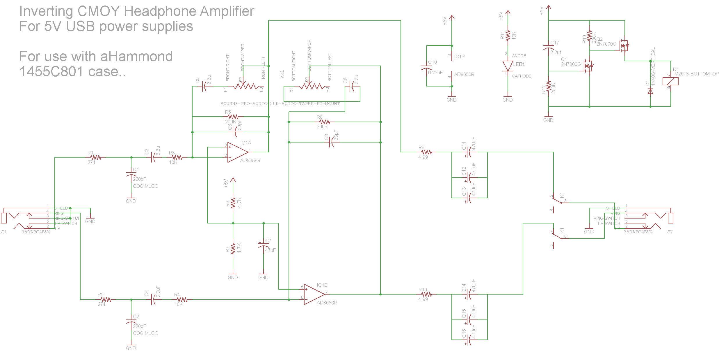

If you remember, I'm the one who posted the circuit with the volume pot in the feedback loop.
Another member stated it was a bad idea, so I went back to keeping the feedback loop fixed and using the pot to control the audio signal going to the first stage.
I see that you like it well enough to have some boards made up and actually try it.

Here is the answer to your second question about the cap to ground in the feedback loop. It is the difference between DC and AC gain, with DC defined just as a signal at 0 Hz. At DC, 0 Hz, that cap to ground is an open circuit. So you can re-draw the feedback loop as just the resistor from output to inverting input, which is a unity gain voltage follower. Whatever DC offset the chip has internally will only get multiplied by 1. But at AC frequencies > 0 that cap now has some low(er) impedance and the resistor to ground in the loop is back in the circuit, increasing gain past 1 for AC signals.
The cap to ground is just a neat trick to keep DC gain at 1 while AC gain is something higher. But the downside is it puts a fairly large value (electrolytic) cap in the signal path.

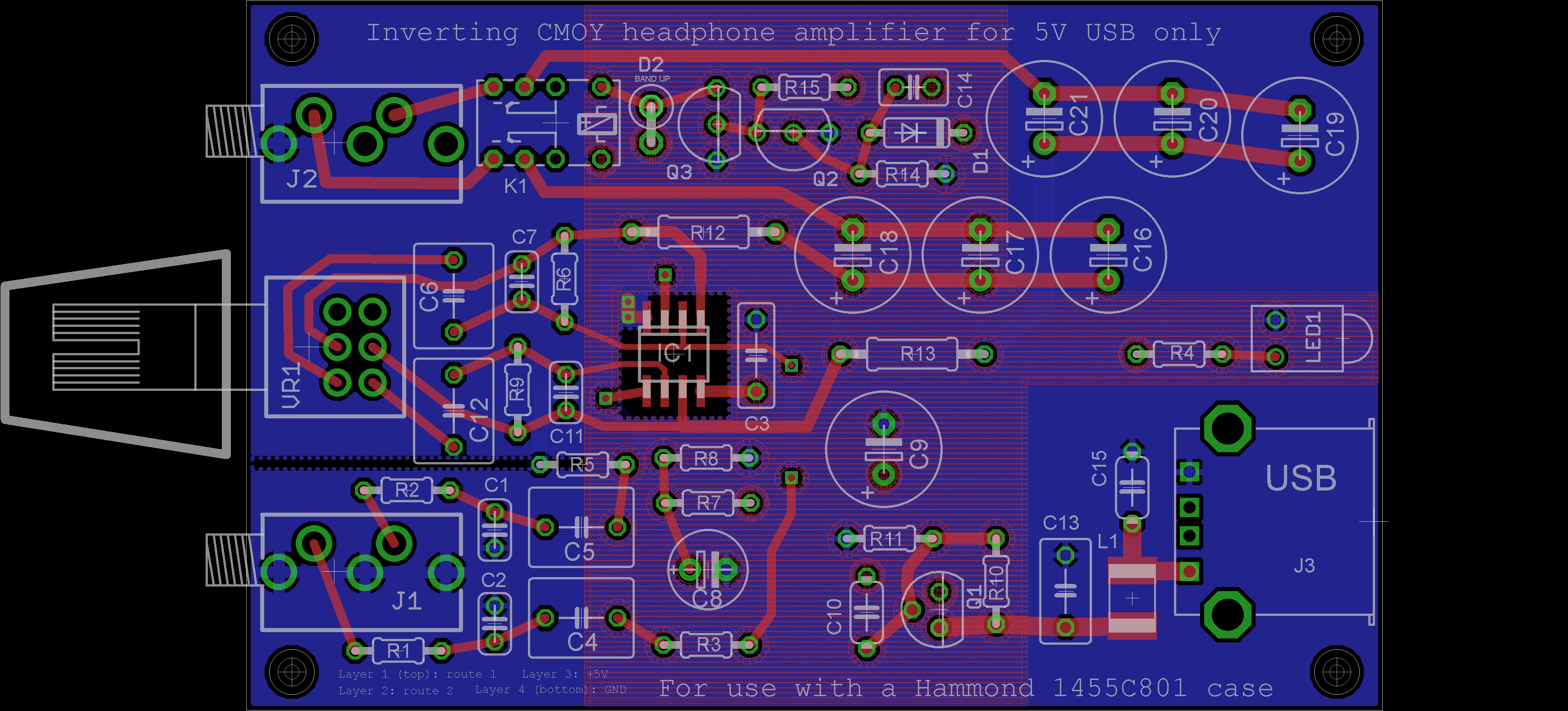

I spotted another trick in the reading I think I'm going to add to the board, a common mode choke right after the USB port power pin. Apparently the single ferrite bead chip is useful for reducing differential mode noise, but does nothing for common mode noise, which I expect will be high with PC clock harmonics getting into everything.
It turns out the AD8656 is good for a whopping 220mA per channel at 5V. I was looking at the wrong table, the 2.7V power supply table, which shows the 75mA max output. Good grief, if it can really do a 1.6Vpeak swing and up to 220mA out that would be useful for several headphones. With the low voltages involved power dissipation in the chip won't be a problem. If that attenuator function on the low end of the pot range works as predicted the amp would even work to cut the level of high output sources, for phones that just need current buffering.
