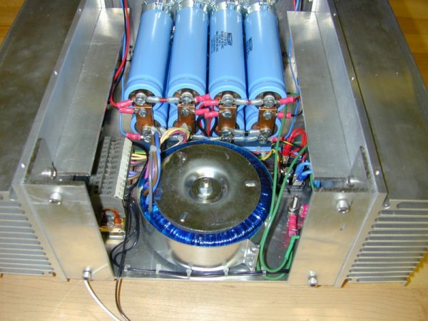

The power supply is fine. I'm doing my testing now with a laboratory power supply. I increased the fuses rating to 8A then I blew up some resistors and one IFR240. I double check the circuit three time and found no problem. Is there a procedure to start up the amp? I tought to unplug all IFR240 and first keep only the differential stage at the input. Then connect just one set of FR240. Will it work?

Here a picture of the power supply and frame

Real nice metal work! Looking at the terminals to the left side, I was wondering if you by any chance are an electrician?
