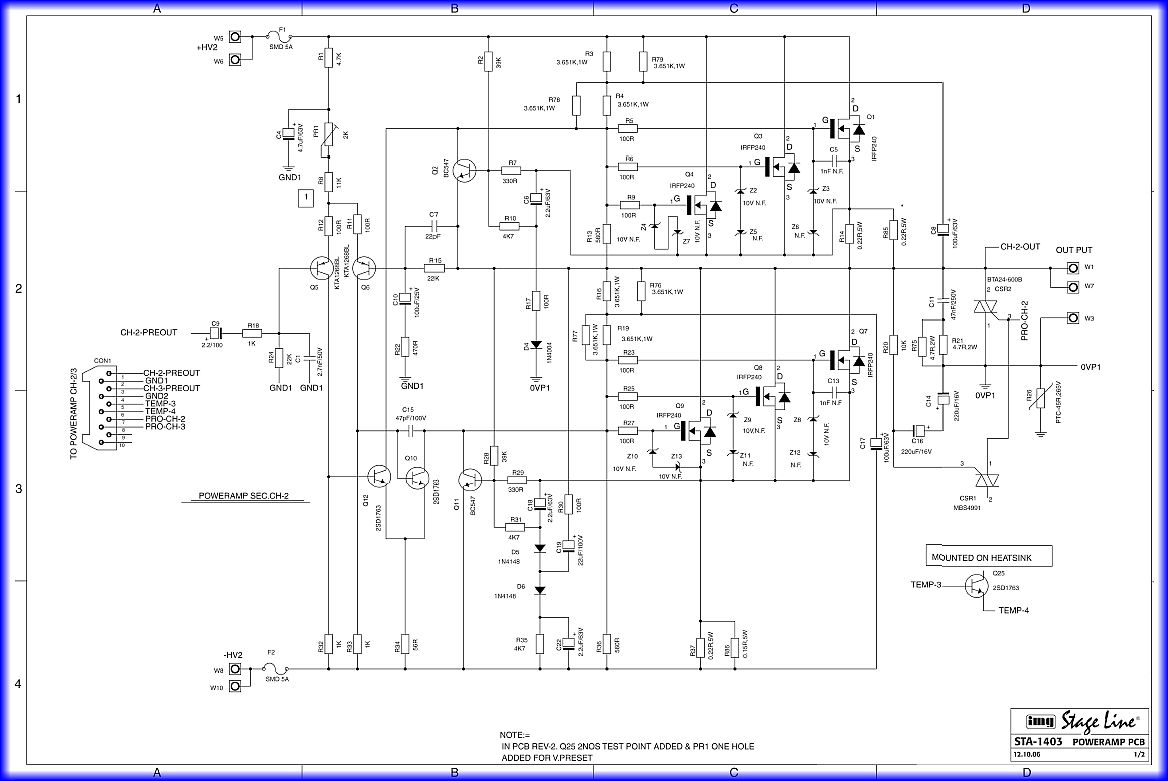

Problem with Monarch 8 Series 8000 amp
Sapte Mari , try this is schematc :
