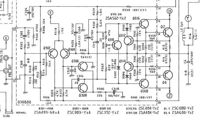

I've attached the power amp part of the schematic. The main reason I would like to save this amp if possible is that it fits into my rather modest system of a Yamaha CD player, a Yamaha T-7 tuner and Yamaha NS 555 speakers very well. It's quite substantially built with shielding over the input circuitry and elsewhere.
I've had the covers off and cleaned the PCBs and checked for poor solder joints but couldn't see anything faulty. The amp does have what I think is a speaker protection device in each channel. This thing has two flat strips of metal with what look like contacts enclosed in a small glass envelope. Maybe some kind of bimetal switch which heats up and opens (hopefully) when any DC is present. I did think that this might be the cause of the noise. But I haven't done a channel swap to check that yet.

Hi Roy,
That doesn't look like it's too bad a little amp. Absolutely, fix it.
That "white noise" sounds like a transistor breaking down. Old carbon composition resistors could make this sound also.
So, I'd replace all the electrolytic caps if I were you. Take a picture or four before you start in case a component spins in your fingers. Most these caps have a polarity.
After this, allow the amp to begin making the noise. With a can of freeze spray, cool one transistor at a time. Wait at least 10 sec between each attempt to give the spray time to work. A little frost is enough, and that takes a second to appear after you stop spraying. Start with the small transistors first (Q302,304,306,308). Then move on to Q316,318 2 and 4. If you suspect a transistor, test it by warming it up (noise starts) and cooling it down (noise stops).
If you feel the breaker is causing the noise, play low level music, a tone is better. Tap the device to see if the sound cuts out.
-Chris

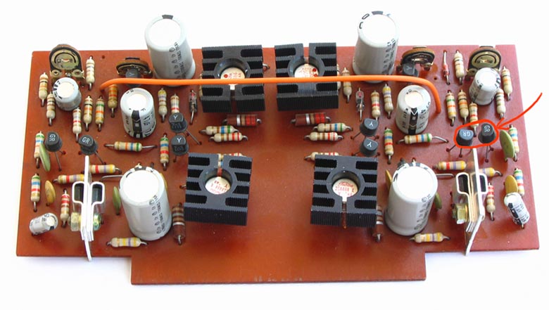

It's been a fair while since my last post (work etc intervening) but I do have some progress to report.
I used the freeze spray, as suggested, and when I sprayed two transistors (Q302 and Q304 in the schematic and red outlined in the pic) on the power board, making sure they had frost on them, the crackling noise stopped instantly.
And interestingly, the noise has not returned even after about 24 hours of continuous use or being left on. I used the amp both with the cover on and off - no noise either way. I ran the amp biwired to the speakers at around 11 o/c volume, the heatsinks got quite warm but no noise reappeared. I thought that the freeze spray might have affected a dry solder joint, but I couldn't see any sign of that. And, in any case, when the amp was checked out a couple of years ago, the tech resoldered all the joints.
So I'm wondering what might be the next step. Should I replace the 2 transistors on each side. If so, are these transistors sitll available (or could somebody please give their equivalents).
From my very limited understanding of amps, if the transistors were replaced it would be necessary to adjust the DC offsets and quiescent currents. Would it be necessary to replace the trimpots with sealed ones, for example, following the recommedations here http://www.tnt-audio.com/clinica/bias_e.html
Any comments on all this would be welcome.

Hi Roy,
Bingo!
Don't worry, the noise will come back. Replace those with 2SA970 (match the gains). Touch the cases together with a touch of heatsink grease between them.
Your 2SA493 are rated at 50V, 150mA, 400mW and a beta of 120 ~ 400 against the 2SA970 which is 120V, 100mA, 300mW and a beta of 200 ~ 700. I don't think that circuit comes close to exceeding the 2SA970's ratings. Buy a bunch so you can match them in pairs. You can use others but the 2SA970 is a very linear transistor, good for diff pairs. They should be available. Don't bother with replacement brands at all.
Your trim pots are fine. Use some contact cleaner on the center metal part and work the control a few times. Reset it to the dent, you can feel it lightly while rotating the control. Sealed pots can get noisy just as fast and multiturn controls will not help you. I would worry about those more than the originals.
-Chris

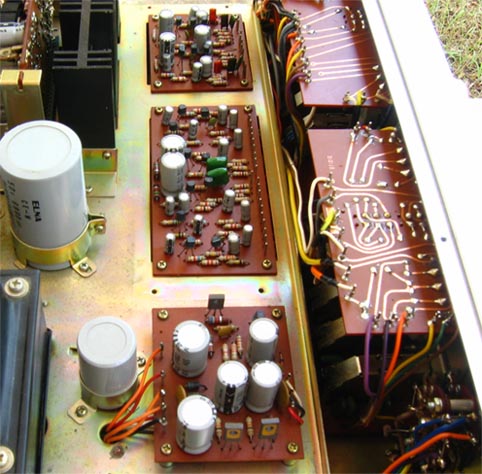

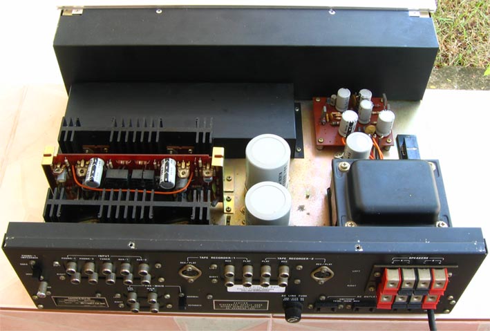

I've attached a pic of the amp with the covers off.

Hi Roy,
Buy 10 or 20 transistors (they should not be expensive) and you can get some excellent matches. You want to match the beta. You can use the hFE function in your DVM, but my Heathkit IT-18 gives much better results. You don't care what the actual value is as much as how close they are. Pick the highest gain devices that are matched.
Basically, inject a base current and measure the collector current. You can try to measure the base current, then the collector current (difficult since the base current will be uA). The base current will be your target collector current divided by the beta (approximately). So if you want 1 mA collector current (good test value as that's where the transistor normally operates), the base current may be 0.0025mA assuming a gain of 400. That's a small current. Your meter may upset that reading.
It may be better to supply the base through a variable supply and some resistance that gets you in the range and note the voltages to give 1 mA collector current. Match them on that basis. Use 5 to 10 volts for your collector supply and a 1K resistor to measure across.
-Chris
