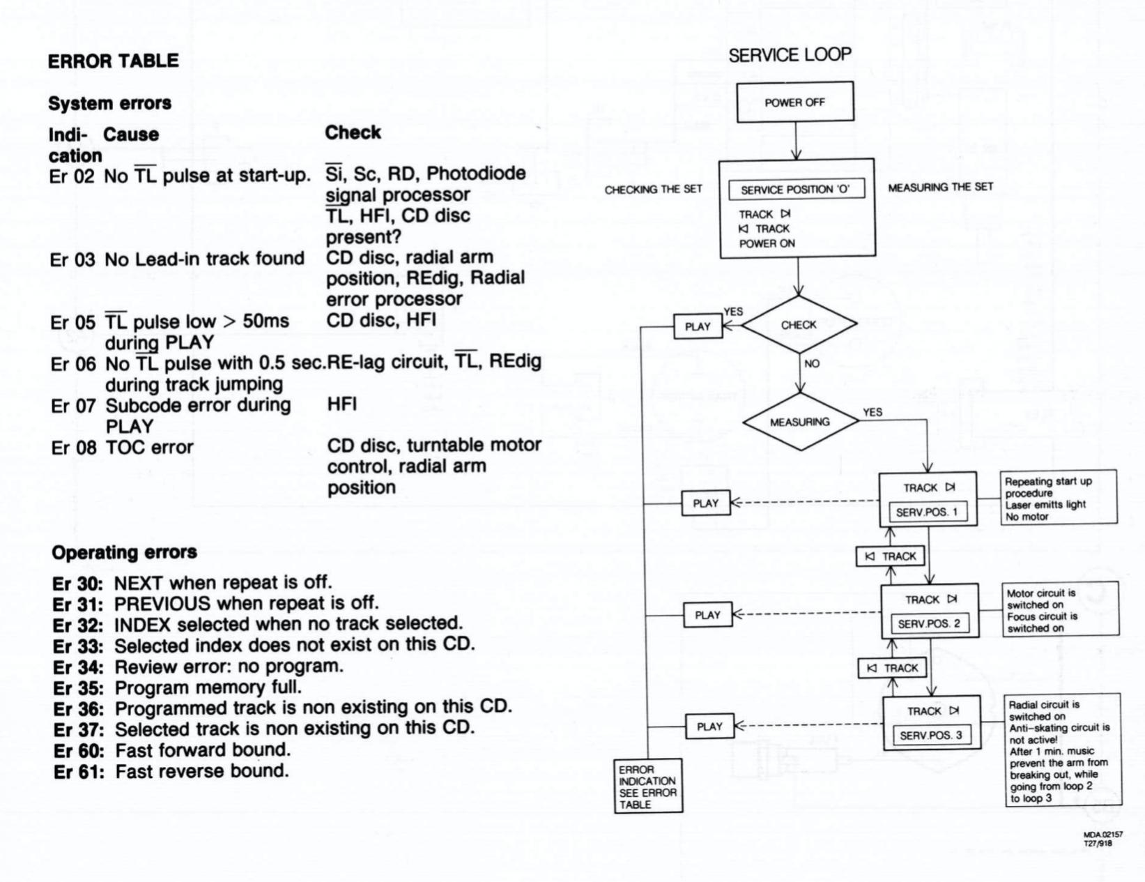

What results do you get in service mode?
Service mode will guide you to the general area of the fault.
Follow the Service Manual instrictions.

Hi!
I do not know how to enter to service mode.
I was looking this image did following - while CD is out of power keep pressed both skip back and skip fwd button and then switched power ON. I have on the display this message 0P117 - see photo. Do not know what is this.
new situation with Marantz
I was keeping pressed Prev and Next track buttons and switched player on. First message on the screen was 0P117 and when I pressed Next track button mechanism was making strange noise and was changing numbers from 01.03. After I pressed button PLAY message 02 Err was displayed.

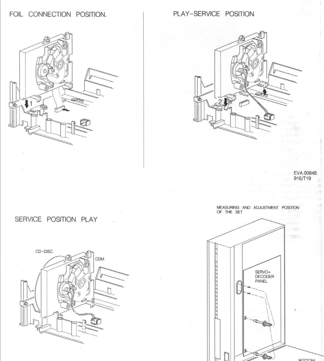

I have the Philips CD-60, almost the same as the OP's unit.
When the manual refers to Service Positions, are those actual physical positions or settings once service mode is entered?
(See attached image)What is the difference between Play-Service Position and Service Position Play? Is Service Mode supposed to be conducted while the CDM is standing on its side?

According to service manual this means the disc isn't recognized, it says:
Err 02 = No TL pulse at startup
I will send you t he service manual by PM if I manage to do that, it contains instructions what to do to isolate the fault. Otherwise it's also pretty easy to find on the net. It's from CD50 but it's almost the same, I've used it to modify my CD40.

Did you ever figure this out? I'm scratching my head. This service manual is hard for me to follow.
Service mode can be conducted with CDM standing on its side (if the CDM supports that - I will stand corrected if I'm wrong, but some CDM versions don't support this. I think the CDM-4 does, though), but it can also be done with it in normal position (and this might be preferrable first, if it has reading problems, as vertical mode often makes it read worse).
They are settings only, which command the mechanism. Basically, it's a special program which has several steps (which are user selected - the key for that is often slightly different from model to model, it is mentioned in service manual) for testing several things. It starts with fundamental functions of the reading process and then progresses to a higher level with each key press (example: in one mode it only focusses, in the next it will try to spin the disc, after that try to play, etc.). You can also move the RAFOC (the laser head unit) to inner and outer positions with two keys, so to be able to test function of the swing mech.
Service manuals from Philips can be a little complex and sometimes contain errors, but they also are very comprehensive and complete. Just take it slowly. Hope this helped a bit.
