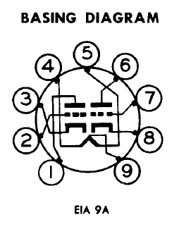

Looks like section 1 (pins 6,7,8) is not conducting current/conducting very little. Are both heaters lighting up? If not you may have a wiring mistake.So, can you solved? I have the same problem with a 12ax7
My B+ is 290v
Pin 6 = 288v
Pin 8,3 = 55v
Pin 1 = 170v
Mabe by the tube is bad?
For:
6.3V pins 4,5 connected together and pin 9.
12.6V pin 4 and pin 5. Leave pin 9 unconnected.
Or you may indeed have a bad tube (one of the heater sections is blown). Always check the simplest things first.
