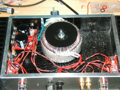

My output voltage is about 20% higher out of the right terminals. I haven't hooked up any speakers yet but measurements with my meter shows more output gain on one side.
A little info: BrianGT's Stereo kit with Antek 300v 22v rails.
Measured the secondary voltage and everything was perfect: around 32v dc each. Hooked up the chips and now have what seems to me more gain on the right. Only thing that's different to me is the length of cable is longer to the left. Could this be it.
Don't want to hook up speakers to it yet so any help would greatly be appreciated... Thanks JohnnyP.
No way
I followed the instructions as per BrianGt's kit.
He states "measure the output DC voltage between the + and - output terminals to verify that a low DC offset is obtained."
I did that and also measured the ohms just to see if there was a difference.
I used the kit so unless I screwed up a resistor, didn't really check the tolerances too closely. I'm going to comb through it again... Thanks for your help... JohnnyP.

But what did you measure? If you measured mV's of offset and had say 32mV on one channel and 75mV on the other, that is 'normal' and is down to the variations in the chips.
I'm a noobie when it comes to measuring DC so this could be wrong. I got 104 for the left and 92 mV for the right.
using the ohm setting I got 222 and 196. Which from what I understand doesn't mean anything but shouldn't they be closer in tolerances... JohnnyP.
I didn't install the dc offset cap(Ci). I'm thinking that's maybe why my DC offset is high. From what I understand it should be safe to wire speakers, I hope!!!

There's really no need. You won't be able to hear any difference. 😉
Well amp is up and running and have tested extensively with speakers but am still kinda purturbed about the high DC offset. Also there's a slight buzzing coming from the right speaker only no music playing. Could this be caused by the DC?
Is there anything to improve this. I thought about putting a 2.2 uf obbligato input cap. Will this help or too much bass roll off will occur.

JohnnyP00 said:Also there's a slight buzzing coming from the right speaker only no music playing. Could this be caused by the DC?
Hi Johnny,
This is more likely caused by the right input crossing the AC Mains input..
