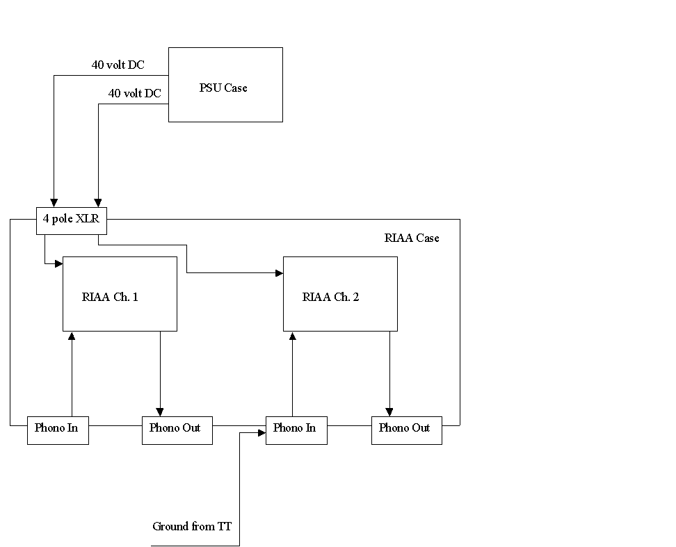

a monster ground loop i think ?
Nope, thats the trafo trying to make two +40 volts with the same GND. You will propably have a trafo "melt down" if you let it run for some time😉 Regarding the hum, I still think it is possible to have a wooden case. Try to connect the GND from the turntable to the GND of the PSU's. Not in the PSU case, but where the grounds meet at the Pearl boards! There have to be a way out of that problem. Can you draw a schematic of what you actually have done? I have a separate GND connection for the arm, running out from the starground. No hum whatsoever. It's not connected to the chassis or the RCA's.
Steen🙂
Hej Steen
Here is a block layout of what I have done. You say connect the TT ground wire to where the ground wire from the PSU enters the board, you mean where the wire is soldered to the PCB ? - should this be done on just one of the boards ?
I hope you can use the block layout......
1000 tak for hjælpen !
/Hans

Try to connect the TT GND wire to GND(0V) at the XLR connection.
Just connect it to one of them at first. If that doesn't do it, try both. If that still doesn't help, you might want to try a real Stargrounding. Somebody posted a drawing some time ago that was very good. I will try and find it.
Steen.🙂
I found it within the edit time😉 It was jh6you that made the drawing. It kind of makes it very clear, how the starground is made!

Your noise is most likely a transformer issue. You need a dual secondary transformer to do the supplies. The center tapped, is okay for a single dual rail. But not good as two single rail supplies.
With the low current draw of the Pearl it could be wired as a single supply using half the output. But the best would be to get a dual secondary transformer.
