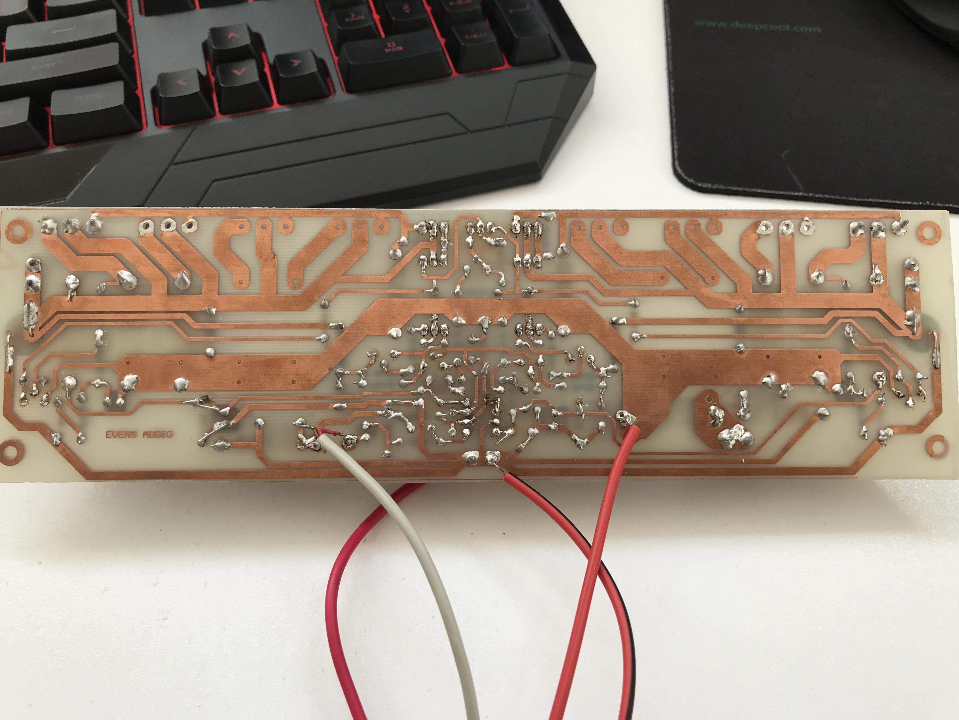

I changed the board. the result is same as before. but DC output reduced from 14mV to 4mV.
Could it be cause of cap type?
I used mkt instead of Ceramic Multilayer and Polyester.
hfe(s) of some transistors is higher than datasheets numbers.

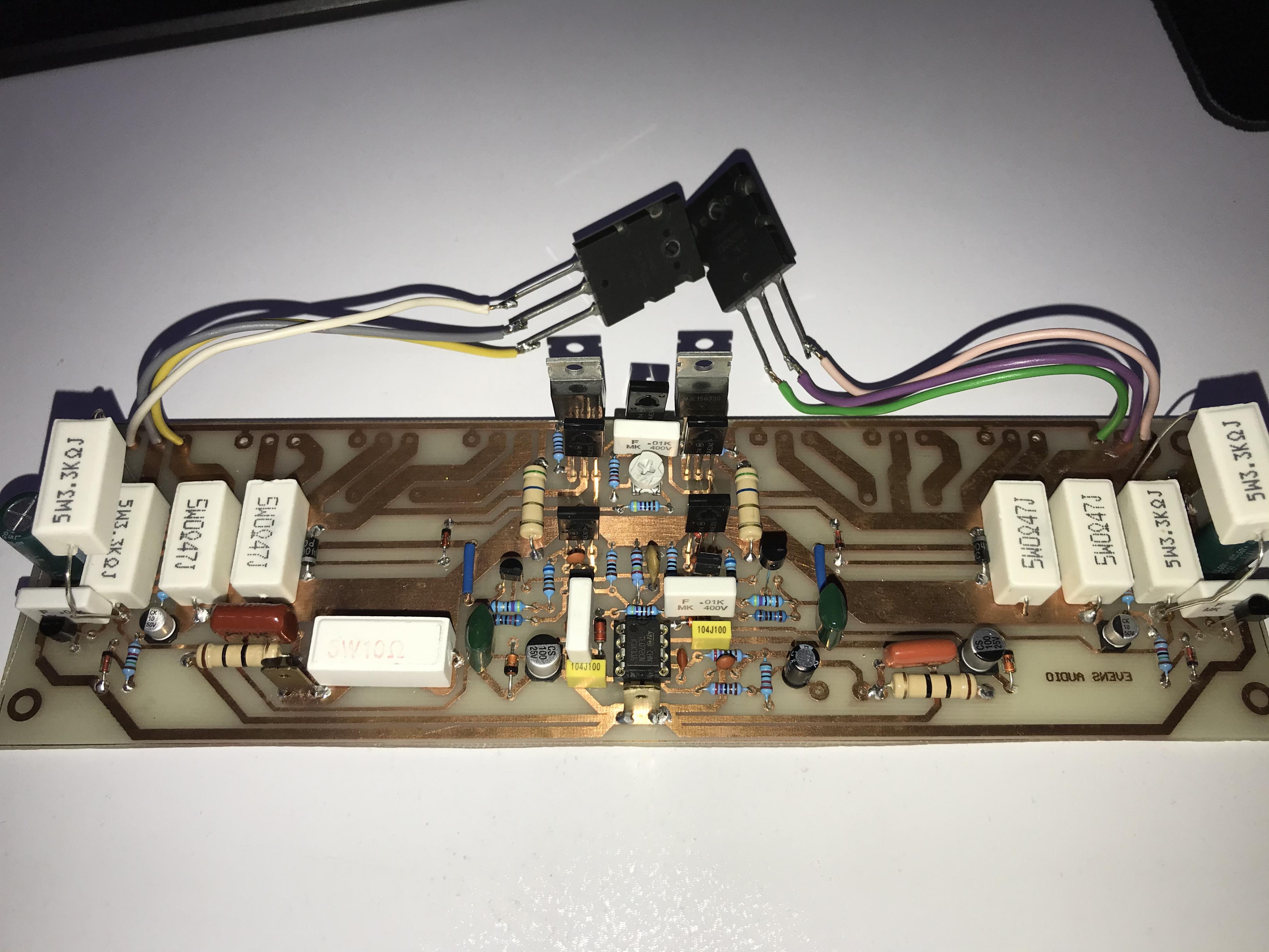

Two things. You should earth your heatsink, not doing so can cause all kinds of minor funnies. But I don't think that's your problem here. Is your 4mV offset rock solid or does it wander about a bit? The reason I ask is that you might have low frequency oscillation or "motorboating". This is where a modest oscilloscope would be invaluable.
If your new PCB layout just follow the previous PCB layout then one of the transistor you soldered the wrong pins, fix it to see if it can work properly.

Yes you're right,I connect the ground to heatsink. It wasn't stable.
How big are the capacitors in your power supply?
They are 4700uF. but I'll change them to 10000uF.

Thanks a lot Patrick. It works very nice. But one more thing, The output DC increased to 93mV. Could it be cause of my mistake that damaged to components?
Yeah me too. Isn't MOSFETs protection better?
Other parts should be OK. For output DC voltage, you can add a 100uF in the feedback network circuit and some other caps to improve amp stable
Should I prefer MKT cap to use?
I hear a hum sound. Is that because of DC output? Or power supply noise? and how to fix it?

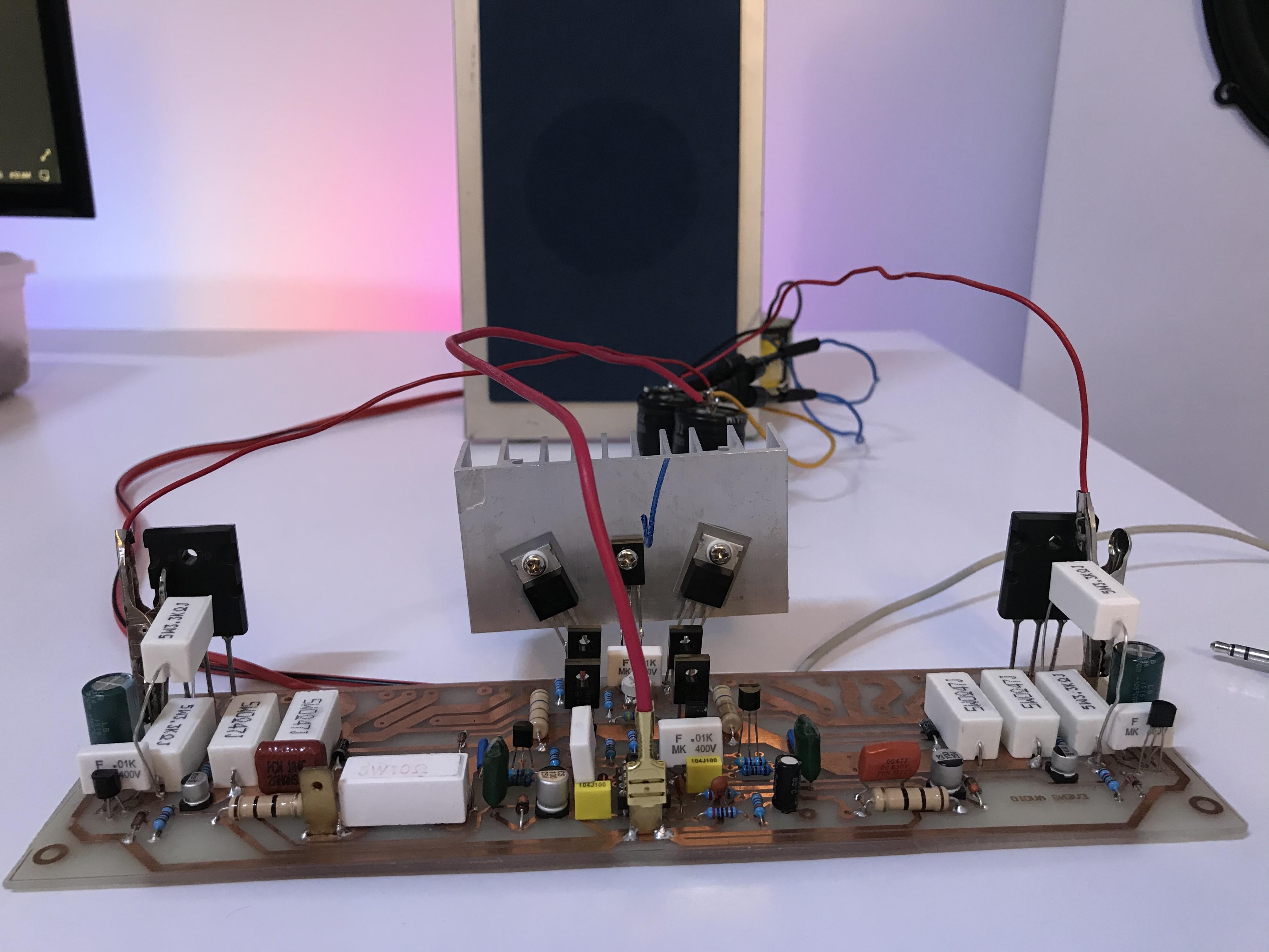

Amplifier is working well, I used a TL072 wich input offset is 3mV.
It's connected to PC. but I still have noise related to GPU load and Interface.
After replace it with OPA2134 noise got lower, But I got distortion at high frequencies at any volume.

For test I used a low voltage transformator.
Thanks I'll change them.
Yes, I connected them to large heatsink.

The amp should be ok for audio purpose. If you connected to PC and have noise and distortion, it's hard to determine the cause

1. OPA2134 is not working right and
2. You've got a ground loop between PC and amplifier. (I presume you built it as an IEC Class I device? Well, hi-fi gear typically is Class II for a reason...)

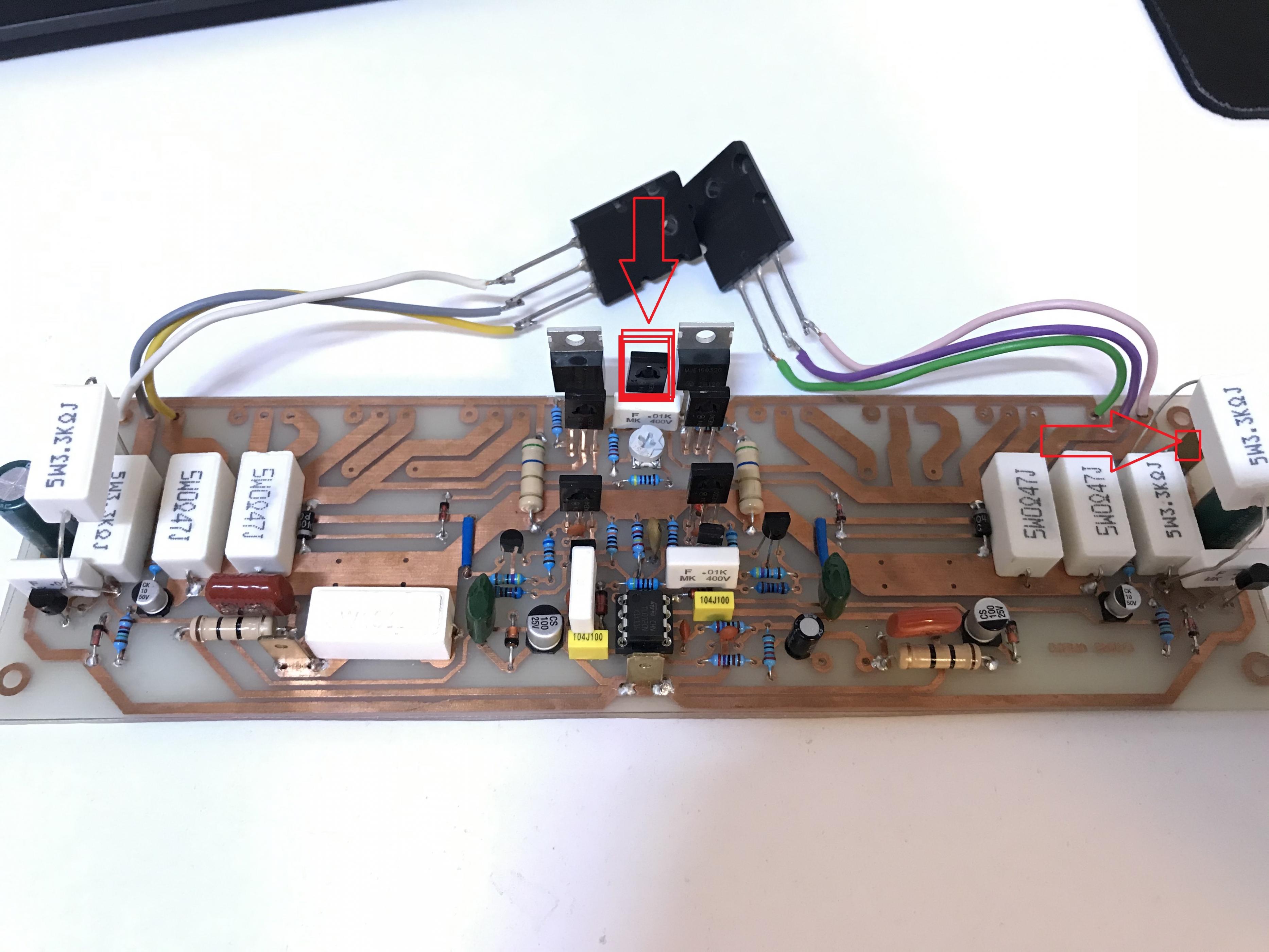

You should have the transistors planned to be tied to the heatsink really tied to the heatsink..... Do not leave them in open air. Besides the SOAR limitations even at low power, there is a reason for some of the drivers/ gain stage to be in the same heatsink which is thermal compensation. I didn't test this design but many others are very sensitive to thermal drift/ compensation. Try it again with everything properly mounted. You don't necessarily need all the output transistors mounted, but whatever quantity you decide to wire, keep them tied to the heatsink always...
