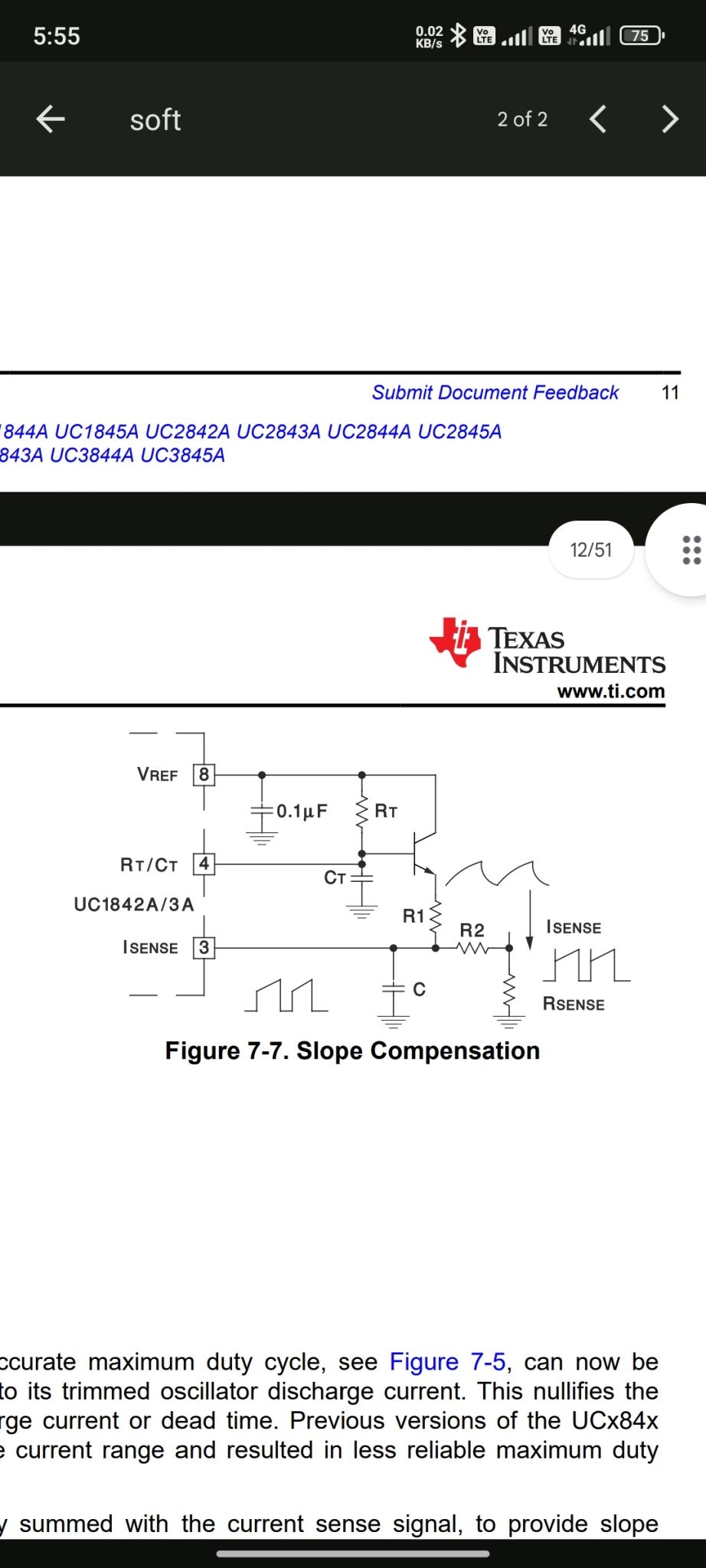

Slope compensation effectiveness depends on max duty cycle. Above 80%, continuous mode subharmonic alternate cycle and RHP instability become much harder to control

I will note that the schematic you posted does not show a gate resistor in series with the FET's gate. 10 or 20 ohms is a typical value. If I remember correctly the resistor stops gate oscillations. Also, this location is used to shape turn-on and turn-off behavior of the FET. The magic in power supply design is all about these parameters. Fast switching improves efficiency, but also drives noise.
I believe an earlier post indicated you are using continuous conduction mode. That is, when the FET turns on there is still current flowing in the inductor and diode. The schottky does not have the reverse recovery issue but it does have capacitance. So the diode goes from having Vforward across the capacitance to having Vout across it when the switch turns on. Charging that capacitance requires current and that current creates noise. Tayloring the turn-on speed of the switch FET to get the right balance between efficiency and noise is what makes power supply design fun.
BTW, the TI webpage shows a newer device, the UCC3802 which has features to resolve issues with the 384x series. You might find the app notes on those issues informative in working with the older part.
