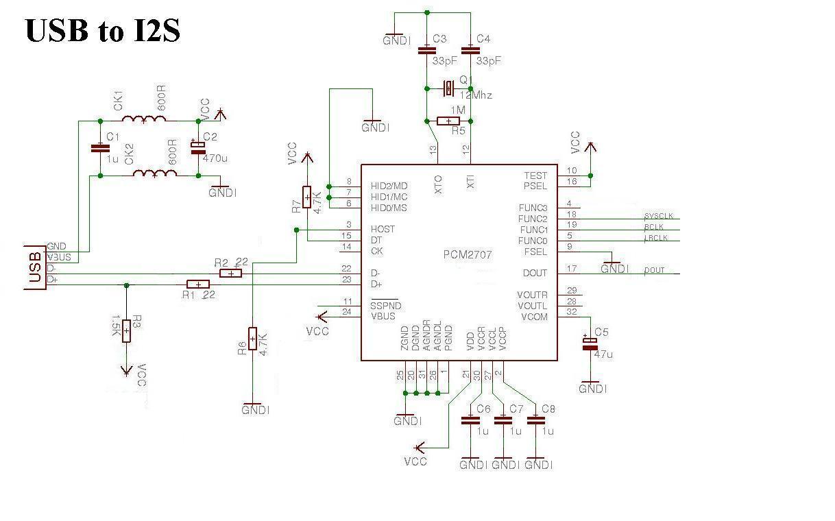

I have rigged up a circuit which is used for USB to I2s conversion..
I am using PCM2707 IC from Texas instruments...
And i have attached the schematic of my board also.. I am facing problems in making it recognized , meant to say that when i connect the PCB onto USB port.. A message pops up on windows saying USB not recognized...:headbash:
I dont know what fault is in my Schematic.. I cross checked the wiring , the components many times .. but didn't find any mistakes..😕

Take a look on the configuration i use for PCM2706.
Thanks for the circuit... But i don find much changes in yours and mine.. Mine is Bus powered and yours is Self powered.
Then you have connected all the Analog Vcc's to 3.3V and i have connected to ground.. I think , this will not be of much concern..
But whats that AND gate doing with that HOST pin???
Yes, i mean if the 12MHz oscillates. The 1M ohm resistor and ~27pF capacitors are critical, the chip will not work without them, even if you see oscillation. Show us a photo of your PCB, maybe we can spot something.

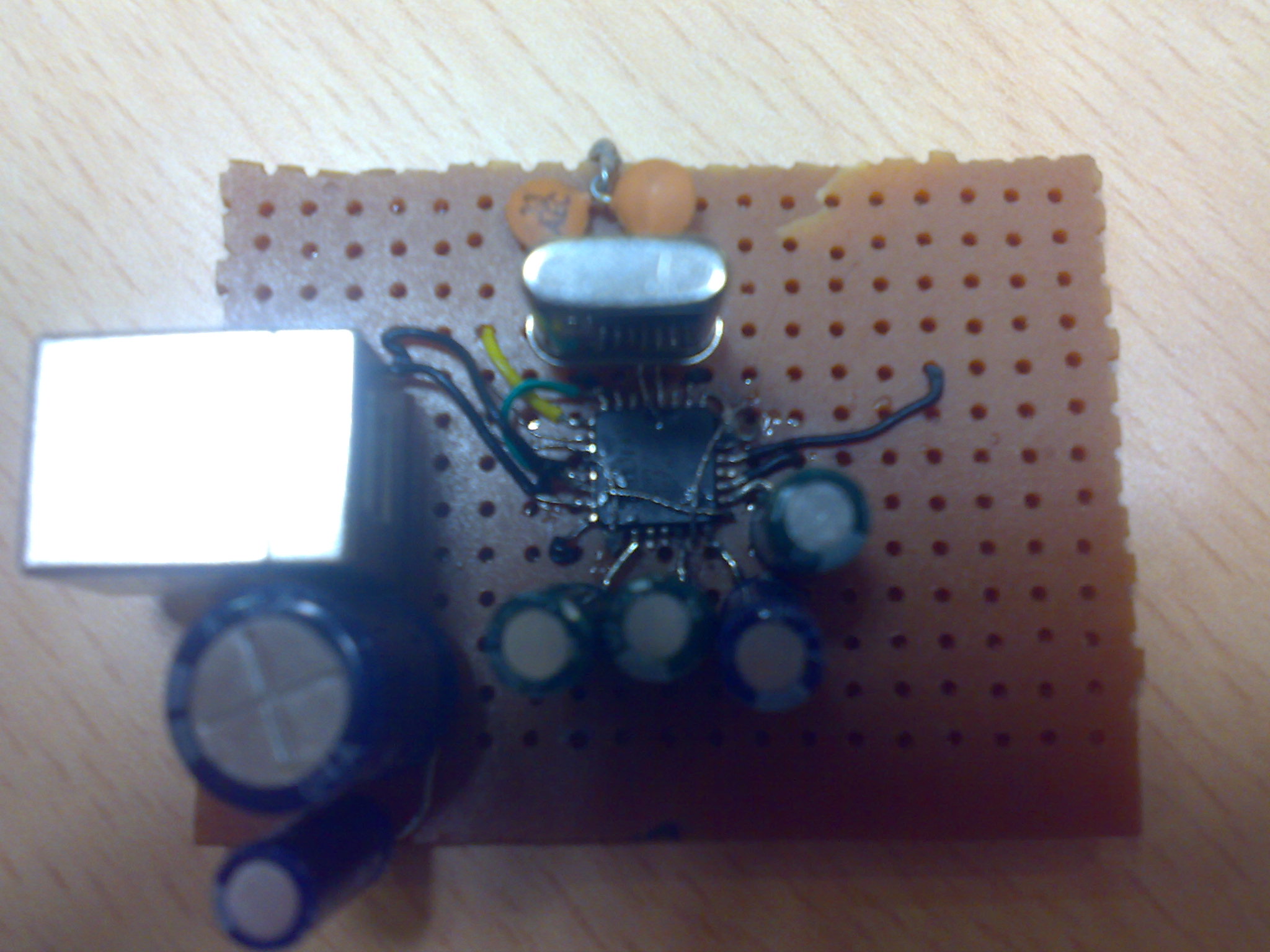

I am onto it as a prototype , so my PCB is still on its way... i have a not so good picture of it , but i don think you will be able to track the lines and all sorry....

Successsssss!!!!!!!!!!!
I am able to get the PCM detected..
All the pull ups which were given to 5V were given to 3.3V.. I used a 5 to 3.3V regulator and it worked...
It detects as an USB Audio device...
This comes up in the Control Panel => Sounds and devices..
