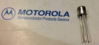

Ben, if you know a dual BJT replacement (mirror pinout) to the 2N5210 and 2N5087 I would deeply appreciate your advice.

Are you talking about a monolithic dual BJT??

Hi Ben. Yes, I mentioned dual matched transistor in one housing like the picture I posted above.

What is wrong with two sets of matched differential complementary pairs?? same part numbers as you had before?? you can tie them somehow with Al sheet metal and heat conductive epoxy.
Nothing wrong, but we were just talking about dual matched in one housing, the matched pair is the straight way to go.

As I wrote before, You can tie them for temperature equilibrium and minimal drift if you wrap their heads with a short strip of aluminum/copper sheet. it`s not as perfect a monolithic device, but it`s better then nothing.

But it`s really simple to make by yourself a strip that connects the two N devices and another strip for the two P devices and you are done. even from a soda can, if it`s made from aluminum.

There is a better way to do that. Put a little thermal compound between them and use a short length of heat shrink to bind them together. It is a very common procedure done the world over. But the first trick is to match the transistors first. BTW, the beta checker in the meters won't work for this. Too bad.
