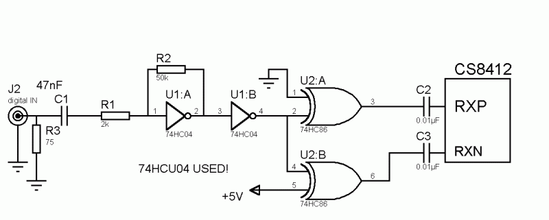

rfbrw said:You could try boosting the input with a SN75176 or something similar. There is also a TTL circuit based around the 74HCU04 and the 74HC86 you could try. Both options give a balanced output a lot higher than 0.5 volts
Like this?

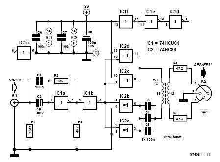

rfbrw said:Pretty much the same thing I was referring to.
I would prefer your solution as it does away with the transformer 😉 . How can I take care of the 110 ohms termination? Just at the output, before the coupling caps? Or would you recommend the transformer option for correct terminaton?
Jan Didden
I can't claim it as my solution as it has been languishing in the forum for a year or two now. As you already have a transformer in the DCX it might be easier just to add the extra components and use the existing supply. At the moment it is still a case of establishing whether this is the cause of your problem so something rough and ready will probably do.
There's nothing wrong with the Behringer implementation - you just have to bear in mind that it's a piece of professional kit that expects professional levels. Rather than modify its input, why not modify the CD player's output? Most have an optical output that isn't used. Why not pick up the input to the optical transmitter at logic level and fit your AES3 driver at that point? (Together with a nice XLR.) The transformer is recommended to avoid RF noise circulating around the earths in your system.
Modifying the player is a good idea in its own right but I would make sure that the low output associated with SPDIF is indeed the problem. A simple booster on a bit of veroboard should do the trick.
rfbrw said:Modifying the player is a good idea in its own right but I would make sure that the low output associated with SPDIF is indeed the problem. A simple booster on a bit of veroboard should do the trick.
Yeah. What I thought, why not just replace the input xformer in the Behringer (or add one in front). This is a 1:1, it seems to me if indeed this is the problem, a 1:2 would do it. Maybe I'll just hang a 1:2 on the Behringer input 😉 .

You then run the risk of overdriving the input should you ever use something with a proper AES/EBU output. Should a low SPDIF output prove be a problem it would be best to either modify the player or for greater flexibilty in your choice of sources, build a powered spdif to AES/EBU adaptor.
