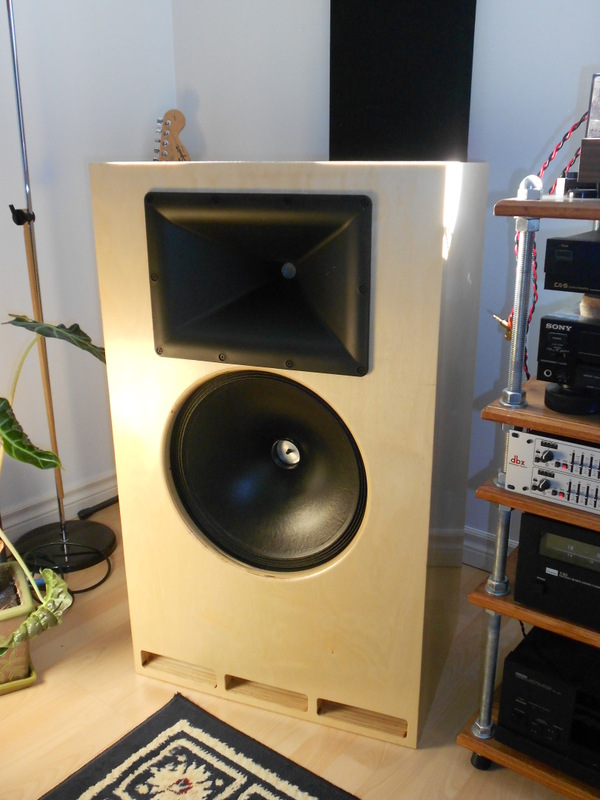

I had time to try the Cardas speaker placement last night. This brings my woofer centers 3' from the sidewalls and pretty much 5' from the back walls. This either forces my chair to be very close to nearfield (equilateral triangle) or close to the small backwall next to the stair case. Either way, this improved things a lot, along with some revision of my EQ (re-balanced BSC and EQ @ Fb) scheme in miniDSP.
It makes for an awkward room layout as I lose that 5' of floor space and this is not a dedicated audio room after all. I still have to try some elevation; funny how I couldn't find anything handy just high enough yet not too much to support the 110lb speakers with peace of mind. 🙂 I'll have to cut some lumber to try this I suppose. If a ~10" boost ends-up being non-detrimental, might be I'll just build bases with casters for them and roll them out in the Cardas spots when I'm in for a more involved session.
