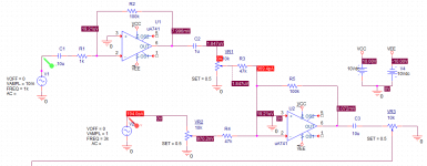

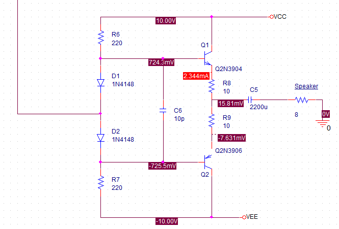

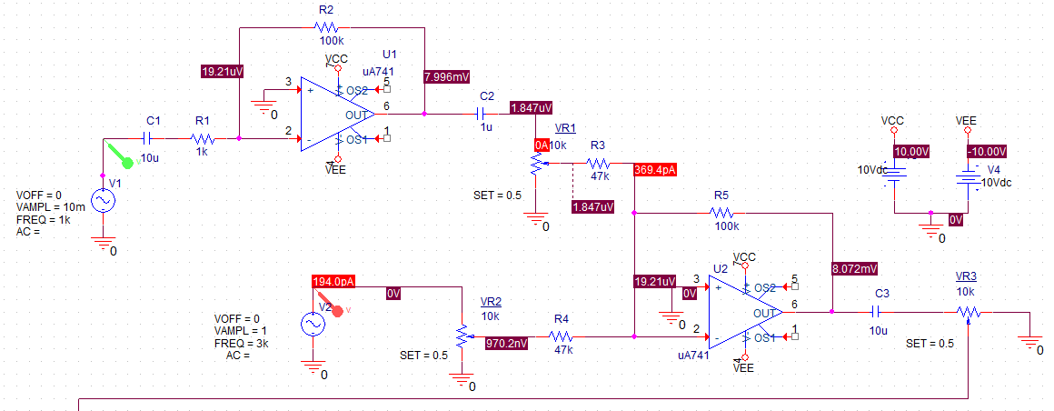

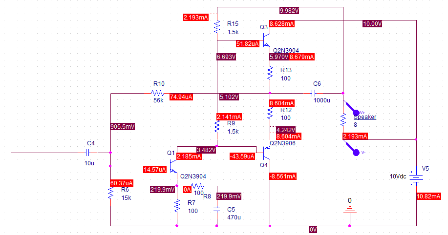

I designed the experimental audio mixer and amplifier with 2 inputs(condensor mic, line) and a 8ohm speaker output. I simulated using pspice.
I'm wondering if it really works using attatched circuit. My circuit have 2 parts :voltage amplifier(op amp) & current amplifier(bjt).
I have 2 current amplifiers and don't know which one is better.
Please let me know the problems on my circuits.
In simulation, the output watt is too smalll.

The power will be around 1W more or less, with this 10V supply.
The circuit has been classic many decades ago, its main drawback is the class A driver collector's current flowing through the speaker's coil:
1) This maintain the coil out of magnetic centre,
2) when load is removed before turning on, a powerful pop will sound when coupling it, as the output stage is unbiased.
There are many better solutions. Do you want discrete or chip solutions?
2n3904 3906 as output transistors, the only thing the amp will drive is a crystal earpiece, not an 8 ohm speaker. No current capability, no heat sink.
Cheap to build, try it with TIP41/42 or something as output transistors and put heat sinks on them. Window frame aluminum will do.
You want something more worked out, look at apex AX6, AX8, bigun TGM8. I don't use the exotic transistors required, see above with C suffix over 30 v rail.
The preamp, 741 are hissy, the sound source had better be talk radio or something. 4558 4556 are about as modern you can go without ceramic rail bypass and feedback bypass cap.
Your project will work and is fine as a classroom design , congratulations, but if you want to actually build and use it, pick a tried and true design.
Output transistors chosen are too weak anyway for anything more than, say, an old transistor radio power amp (say, 200/250 mW).
DC current passing through speaker voice coil isn´t technically perfect, but such a low value will not cause trouble.
Such amps were shown as examples in the late 60´s and a couple pocket radios used similar ones.

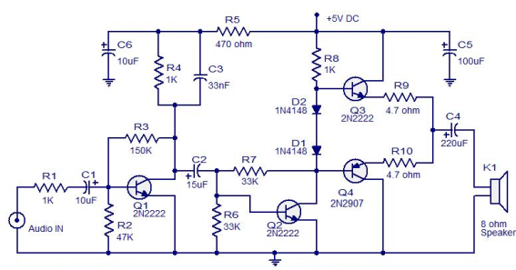

How about this circuit?
Since I only have 220v to 12v transformer, KA7810,7910
regulators, a maximum power I can supply is 10v.
Then how about this power amp?
I can drop the voltage to 5v by using register in series with
Vcc.

Then, I see that your mixer part with the op amps is already fine for an amplifier - all you need is an output stage. Why not just couple the mixer directly to a class AB stage? You don't need a full discrete amplifier to power the speaker. Have a look at the schematic I attached - I've taken your op amp circuit (ignore the op amps I used) and just fed that into a class AB, then I've taken feedback from the output of the class AB rather than the output of the op amp. This should do about 4 W or so.
Just note - R16 is a 100 ohm trimmer, and must be set to 0 ohms. Then power on and set the bias current to something like 10 or 15 mA.

Your circuit post 10 will work but same extreme low power problem as e everything else. Regulating down to 5v is counter productive, you need all the voltage you can get. Running open no regulator on the 12 vac transformer will get you 15 v peak anyway.
These no-feedback three transistor designs will sound like ****. 6 transistors is about the minimum get decent sound.
I see maybe a korean flag? I can't make the buttons work on farnell.com Korea website, but look for semiconductors, bipolar transistors, single bipolar transistors, six to forty watt. See what they have in stock. There should be somthing available in TO220 package or TO126 package for about $.40 each. Heat sinks at 15 v can be cut up window frame sheet with holes drilled in. use heat sink compound if you can get some (grease with beryllium in it) which is poisonous, don't touch eyes mouth or nose after using compound until washing.
To scale up a 5 v design to 15 v you calculate the resistors on the first stage to make the idle current about the same as it was for 5 v.
If you have to use TO92 packages (2n3904/3906 2n2222/2907), parallel two or three of them on the output to get a little more current. 1 ohm emitter resistors will make them share current.

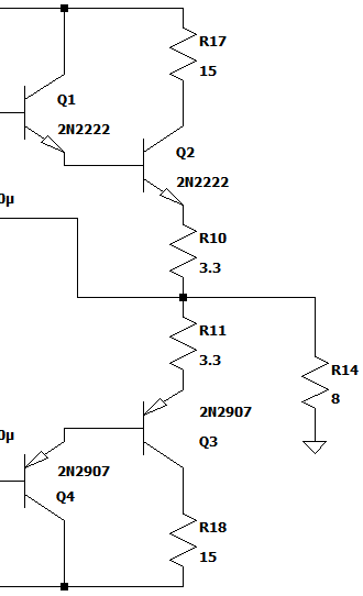

Don't worry about my transistors and op amps. If you don't have access to a power transistor (even if only NPN), then you can only end up with a low-power amplifier. You could put many 2N2222's (or 2N2907's for the other side) in parallel, but you still need to consider what power they can dissipate.
Use 10 V regulators then. The circuit will remain unchanged.
If you use a 2N2222 rather than a TIP41 and a 2N2907 rather than a TIP42, then make the 1 ohm resistors 3.3 ohms, and put 15 ohm resistors in series with the collector of Q2 and Q3. Also set your bias current to no more than 5 mA.
You can get about 800 mW out of such a thing, which isn't bad at all!
But definitely try to connect some sort of heatsink to the output transistors.
This for TO-18:
Or this for TO-92:
I've attached the modified output stage I'm talking about.

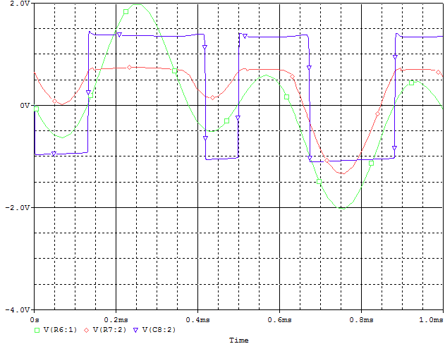

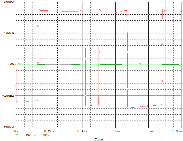

As Indianajo said, I simulated this temporary circuit.
I modified some component values to meet the prior bias condition(5v)
I measured voltage and current on input and output of each mixer,
amplifier. Then the output signal had distortion like square wave.
what is this? And the output wattage (dc?) was 180~200mW.
Is this meaningful value?

Is the waveform going into C3 also a square wave? then turn down the volume on the op amps. The square wave out is called clipping, caused by too much gain.
If the input of C3 is a sine wave but the output of C8 is a square wave, decrease r13 to cut the gain of Q1.
Do you have metal can TO18 2n2222/2n2907 or plastic TO92 version (which means they are not real- real plastic versions are called PN2222/PN2907). The metal can ones can use a heat sink to increase power. Metal can ones haven't been for sale here since the early 1980's, except surplus houses and military suppliers.
C8 of 220 uf won't pass much bass. 2200 uf is more usual. Of course if the speaker is 100 ohms up or a piezoelectric earphone (crystal earphone) then 220 uf output cap is fine.
180 mw out may not melt the output transistors.
