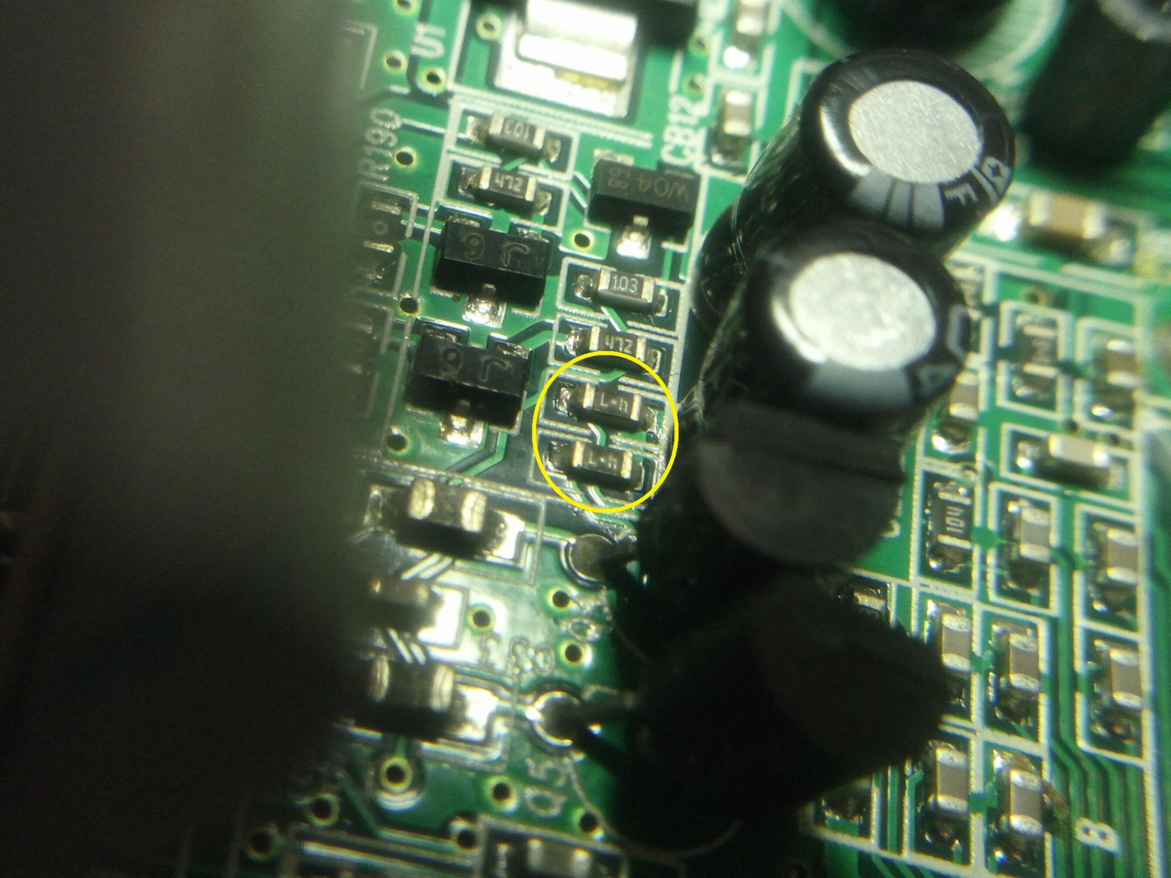

My problem is that there is a noise in the output when the mute disengages, regardless of signal when playing or in pause. The noise is maybe -40 dB, havn´t had the possibility to measure it yet.
The DAC is an AD1853, and the electronics are of the type with a buffer, so the disc is spinned faster than a normal CD-player. At the moment I´ve no access to my osciloscope, so I want to ask, if anybody may have an answer to what may cause the noise. I have reflowed the dac and main IC type MT1389QE. Maybe the buffer memory, a K4S641632H can cause this problem?

As an official service engineer for major brands (Advance Acoustic also) I got some service hints from the manifacturer.
Replace R39 and R41 on the digital board by 10 ohm SMD resistors.
I attached a picture to make it easier.
The noise should be much lower.
Hope it helps!
Greetings,
Wim

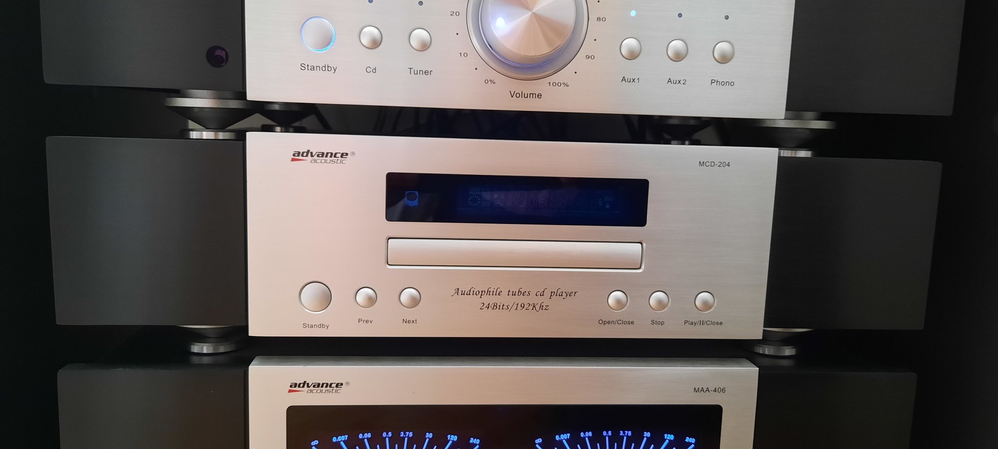

Hello, I have an Advance Acoustic MCD-204 CD player. His problem is that when he presses the POWER button he no longer enters the start sequence, display is dead (does not display anything) and does not take any command (PLAY, NEXT/PREVIOUS, EJECT, etc). The lamps inside become incandescent which makes me think that the audio part is powered but the control and display part does not work. Do you have any idea what the problem is? Thanks!
