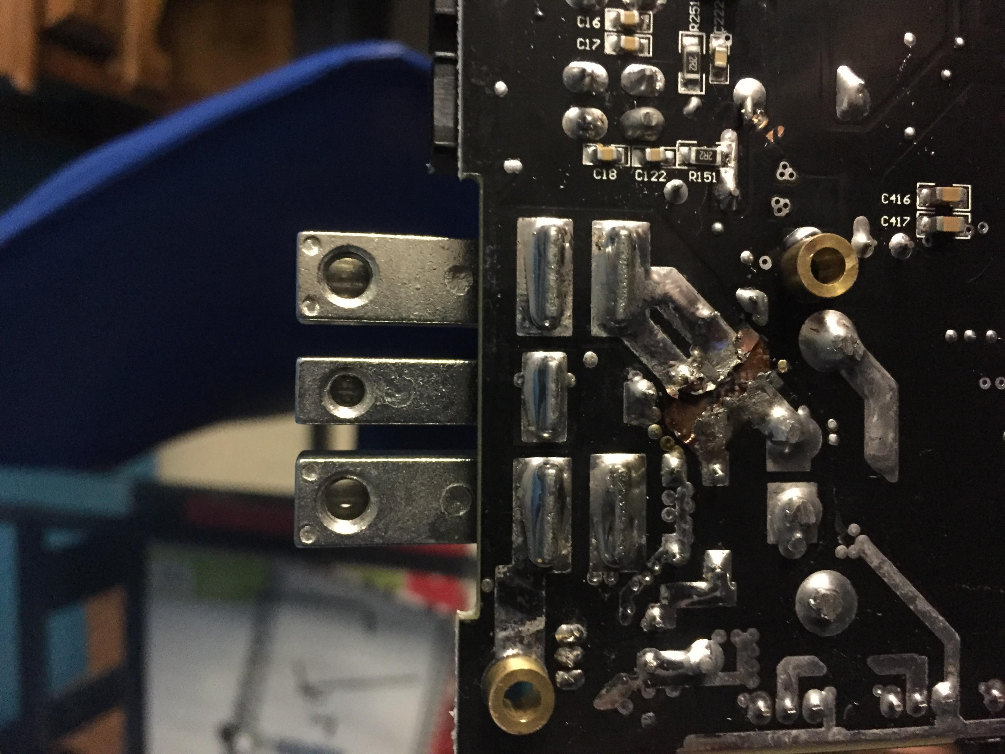

I pulled apart my Diamond Micro 4 v2 to figure out why it wasn't turning on and I found this..
Is there a way to fix it or is it garbage?[image][/image]

You can jump it with wire. It will be reliable if done correctly.
It probably didn't have a fuse or wasn't properly fused. The proper fuse generally prevents this type of damage.
There may be damage to other components that caused enough current to pass to burn the trace open.
Was it working properly up until this happened?
