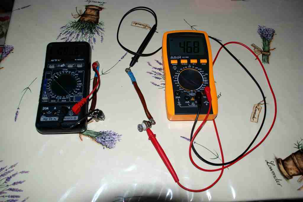

I'm sorry, I'm not saying it with full conviction that this is the case here.
I'm just saying what happened to me.
Now I've found the diode that was joked with me.
It certainly does not know what he would prefer:
This is a big-big short circuit.
I only know about the diode SILEC RG12, it was in a computer's power supply:
ordinateur Bull GE 115, chr4infb
Another one works.
This is not a Schottky diode presumably.
To be sure, the Aleph buzzed as the god's wrath.
https://skydrive.live.com/?sc=photos&cid=e894cb7d50b65fbf#cid=E894CB7D50B65FBF&id=E894CB7D50B65FBF%21512&sc=photos
I am affraid of it, the details only seen on the big picture.

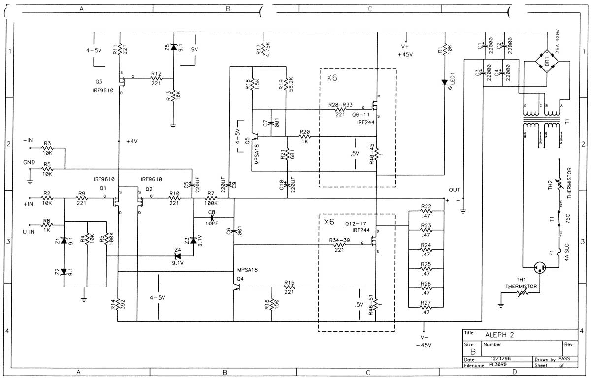

My Aleph 2 functioned for several years without problems, now suddenly one channel has a large portion of DC on the output terminal. The gain devices remain completely cold, the CCS gets warm.
I already replaced the IRF9610 at the input, a BC546 in the gain devices circuit, a couple of Zener's, and one 220R resistor that looked a bit burned (but it measured completely normal). Has anyone some advice for me (except rebuilding the complete boards)?
Hi
Unfortunately, I don't have a file with voltage references, I would be very obliged if you could sent me one.
I have the feeling that something is wrong with the voltages that are supplied to the gain devices. I measured some voltages at the current source board:
DG: 76.4V
DS: 80.5V
DR: 80.8V (R: rail)
GS: 0V
GR: 0V
SR: 0V
The same at the output devices board:
DG: 8.2V
DS: 9.6V
DR: 9.7V
GS: 1.4V
GR: 1.4V
SR: 0.01V
I always thought that the Current Source and Gain Devices boards were mirrors.
There is absolutely no voltage drop over the 1R resistors (DR) at the gain devices board, so no current is flowing there.
Please tell me what other voltages I need to measure, thank you in advance.
