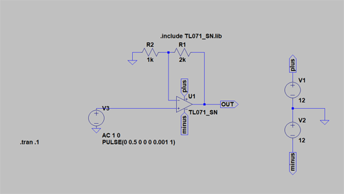

My experience of importing models into LTSpice is not good so far. I have tried two opamps and both give poor results with a transient analysis, or in some cases no results at all. The OPA134 model I attached earlier and this one for the TL071. I have ensured that the pinouts are OK and labelled correctly in each case.
Am I doing something wrong or should I expect external models to be poor compared to the built-in LT models?

it seems to work ok here, using your model "TL071_SN.lib", to be saved in the same folder as the asc file.
attachment.php
  • 071.asc
OK I have now got them both working by putting the .lib files in the same directory as the .asc and using .inc commands. This seems to be a requirement even though I was including them from their home directory before.
